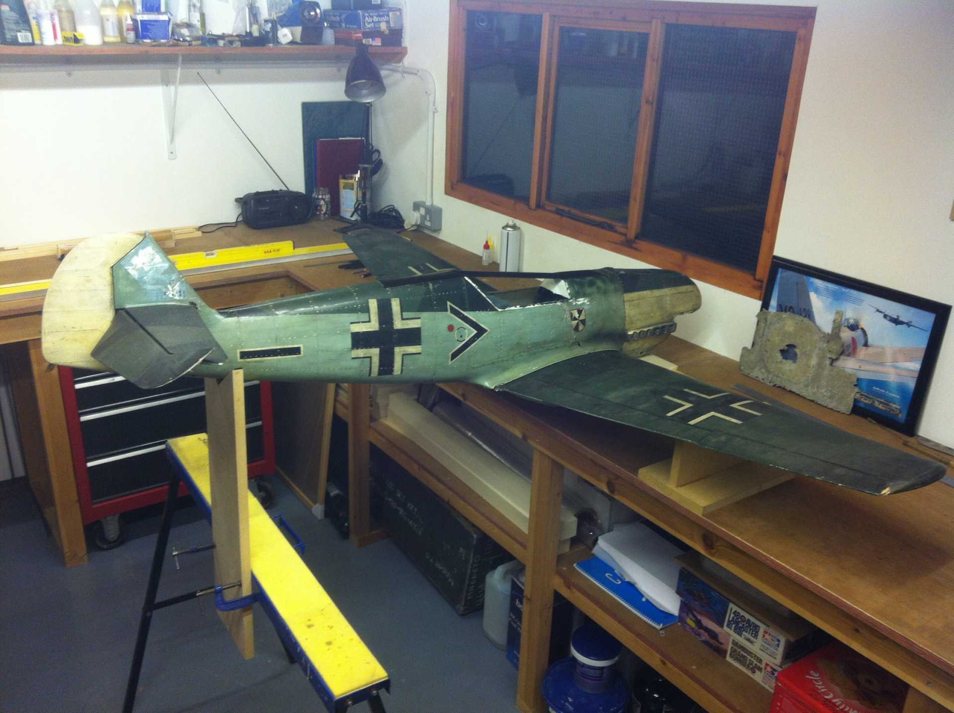

26 Feb 2016 10:12 - 26 Feb 2016 14:31 #23 by lanc101
Replied by lanc101 on topic turman models bf109
Here is a pic of the current state of the model. The 109 is starting to be jiged and being prepped for glassing
I hope to be back soon to inform you of more progress if work allows!!....

26 Feb 2016 10:46 #24 by Ex-Member
Replied by Ex-Member on topic turman models bf109
Nice to have you back sir.
i am glad to see the 109 coming back together.
it is a lovely model, very scale.
:cheer:

27 Feb 2016 10:10 #26 by Ex-Member
i cannot believe how tidy your workshop is. :)
mine is a tip at the moment. :(
27 Feb 2016 16:29 #27 by The Beard
Replied by The Beard on topic turman models bf109
you havent many parts to pop back together have you thats handy
27 Feb 2016 17:03 #28 by lanc101
Hi guys, yeah the workshop is abit clean Tony, that will change soon!. 'The Beard'- Luckilly there arnt many bits to go back together and what bits there are seem to self locate and jig. Glued it together last night and added some temporarilly glued timber strips to keep the sides straight whilst i glue in some D shaped stringers.
