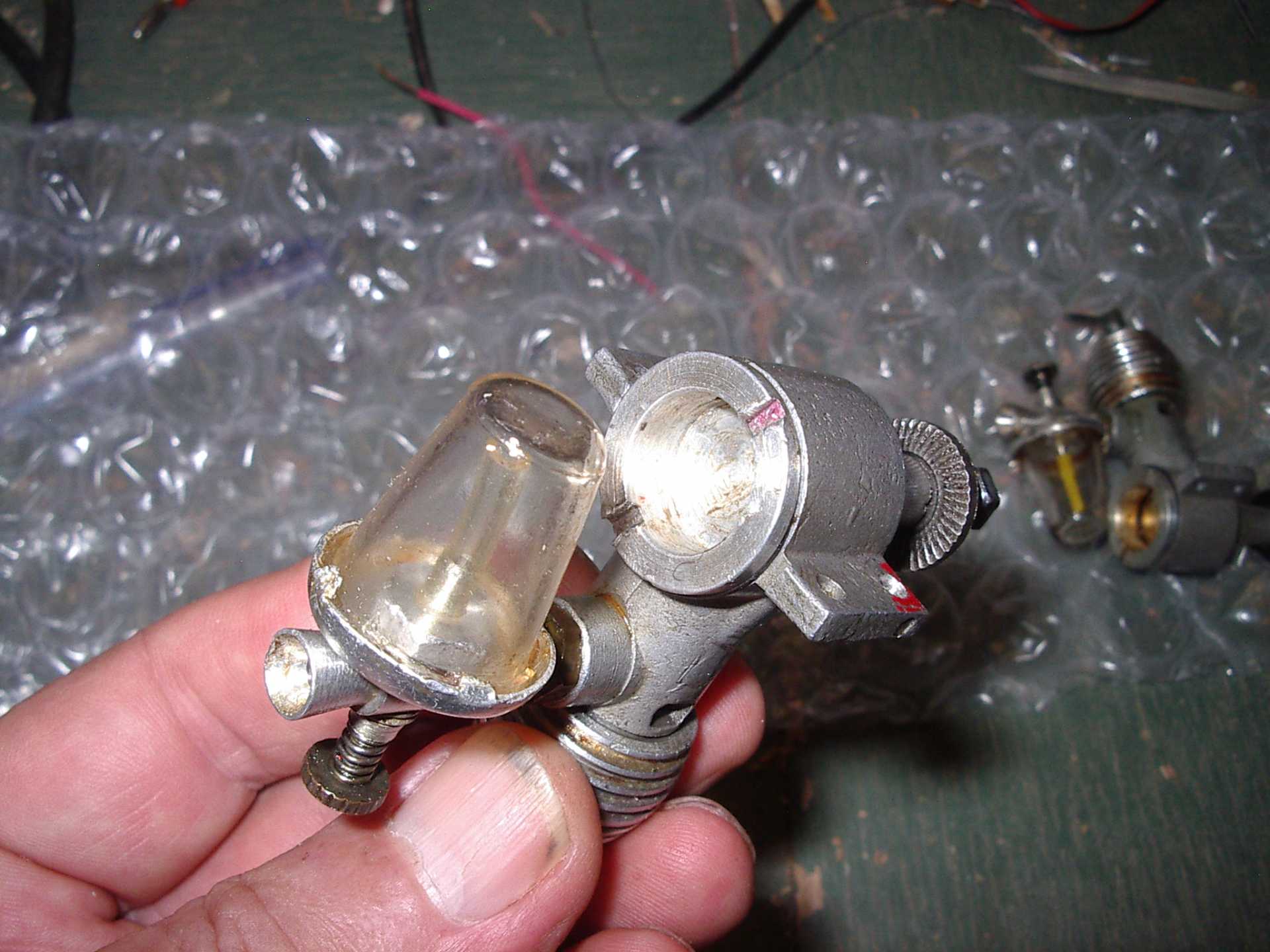

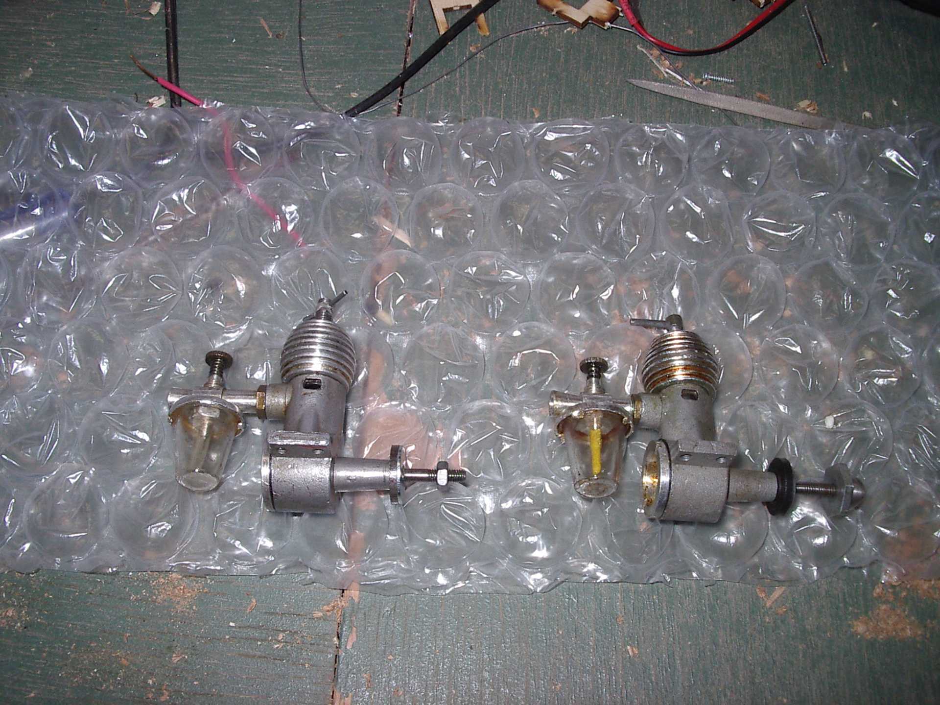

The engine on the left which I've dubbed #1 has had a hard life and is the one with the damaged prop thrust. #2 on the right is the one that won't turn.

As you can see, some philistine has attacked the cylinder fins with a pair of pliers. What is immediately apparent is that they might be Indian Mills, but they are different. For a start the crankshaft threads are not the same. #1 thread measures 3.5mm and the nut being used is a 4mm nut. #2 measures 3.6mm and is a thread that I can't match on my thread gauge. I think it might be 4BA.

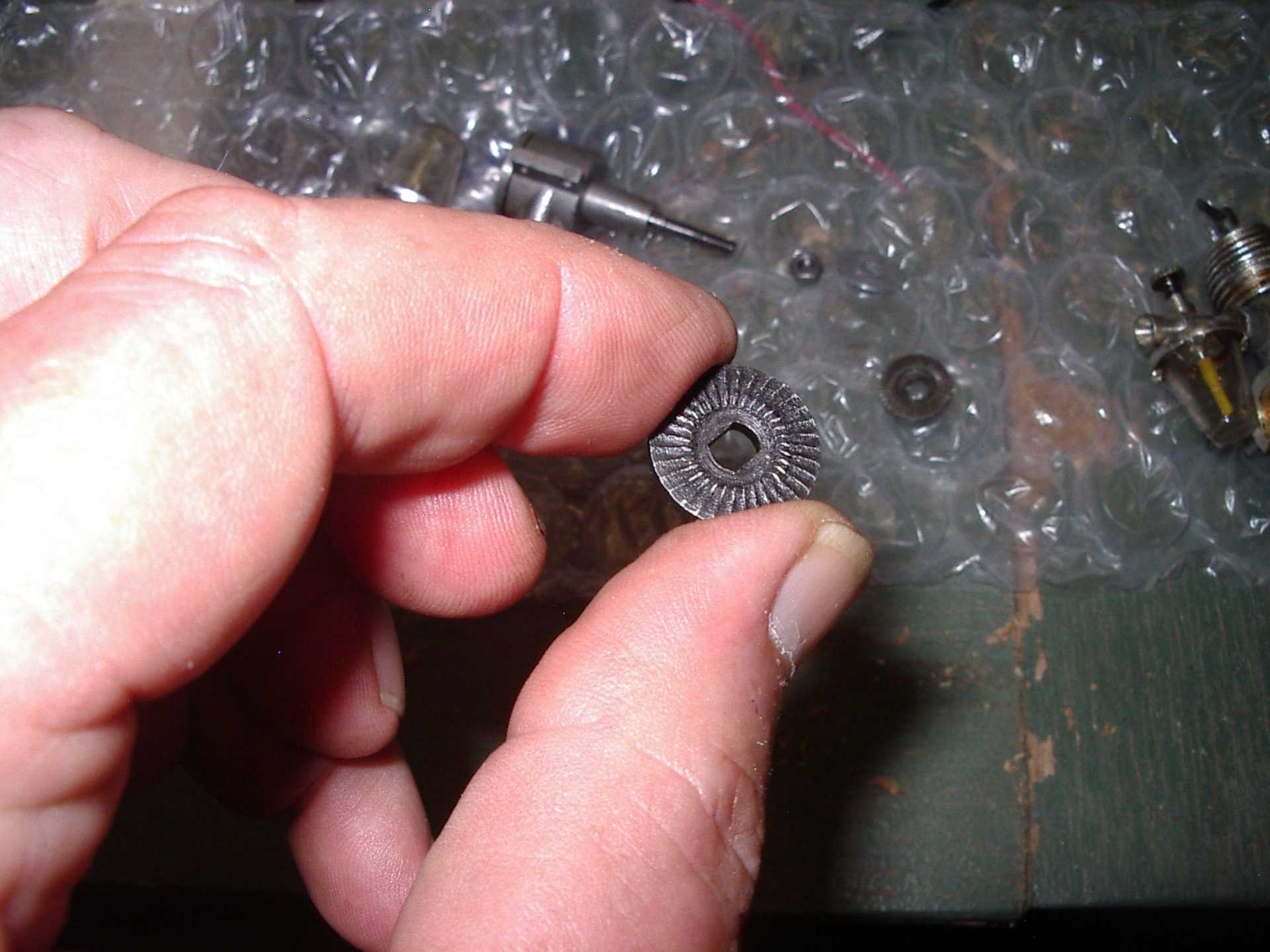

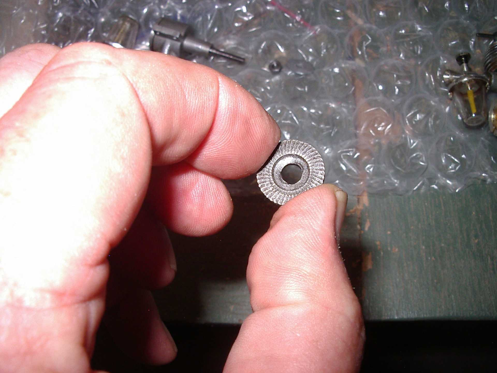

First the propeller thrust.
Buggered
and good, but the good one won't fit on the #1 crankshaft!

The difference is only .1mm, all I can think is the threading die was very worn when that motor (#1) was made.

Hi Klip I know you can turn new shafts but what about the driver? That's a milling job isn't it? Btw not found any EN30 B yet What else do you suggest ? A couple of places have suggested machinable Nichrome steel. Would that be too hard?.I could try for an 8.8 bolt but it would need to be very thick to give a crankweb diameter at the head of about 1" ( not found caliper . I bet S.W.M.B.O. HAS MOVED IT. L.O.L )

John, my experience is 30years out of date, it could be that nomenclature has changed. I would have thought that a Nichrome steel in a machinable state would be quite acceptable.
The original driver would have been stamped out of a steel sheet in a single operation. I am going to make one out of gauge plate, mill the centre hole in and use some kind of turn table to mill the driver face. I will then harden it.

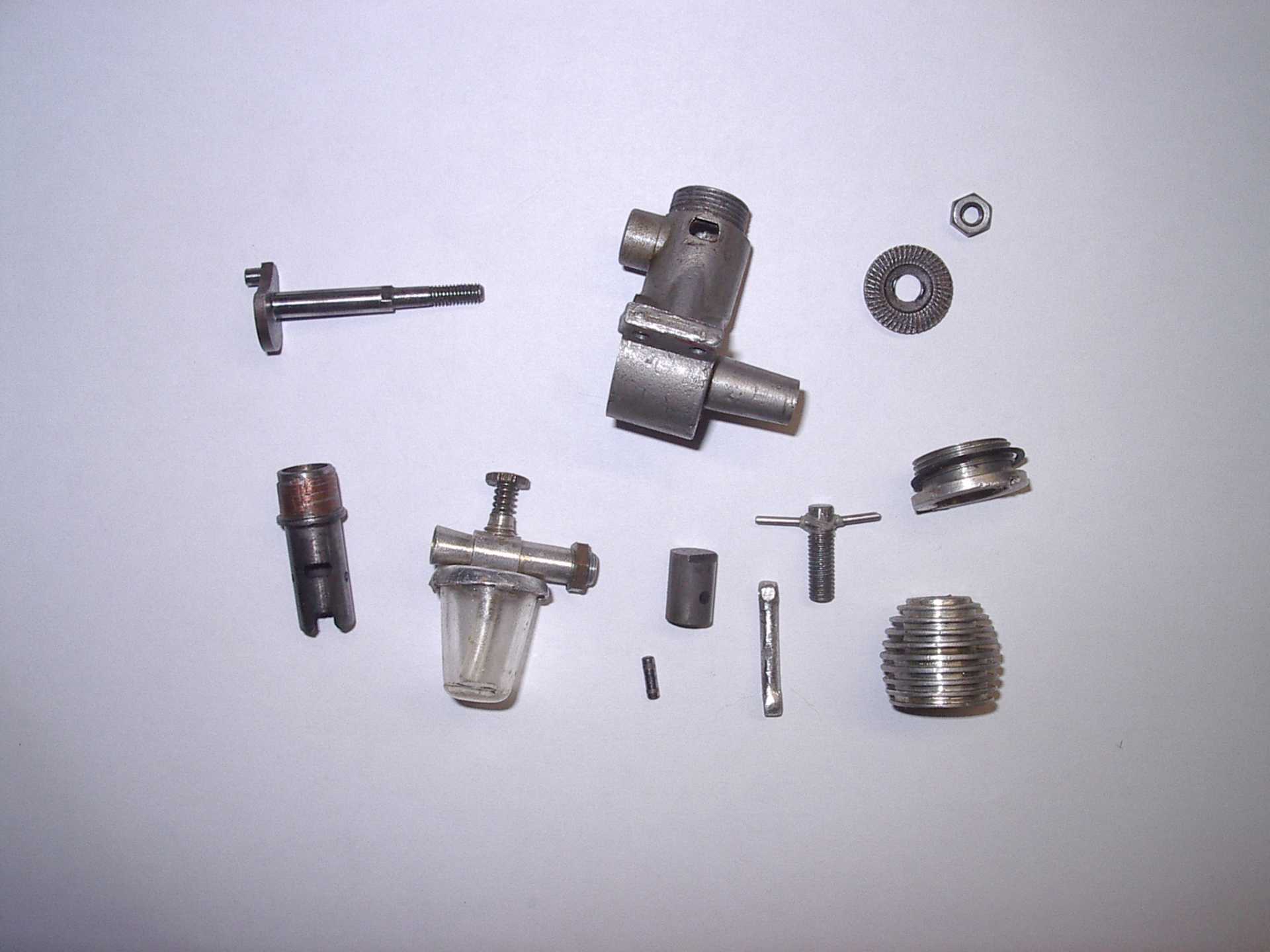

#1 is now completely stripped
The connecting rod doesn't look so good but strangely enough it's straight!

The Mills connecting rod always looks horrible to me. The big end bearing walls look horrendously thin.

Being seriously under square, Bore 8.5mm x Stroke 11mm, plus a con rod length of 20mm, I would guess that most the loads in the rod are compression and to a lesser extent tension. Which of course is why you can make these rods out of just about anything. But I agree with you Q, any hint of hydraulic lock and it's goodbye rod!
What you would do with your Mills is clamp it nose first on a mandrill and skim off the rear to make it square. Then turn it around and clamp it in a 4 jaw chuck, turn out the bearing until it collapses, remove the chuck complete from the lathe. Make a new bearing in a 3 jaw chuck but under size to the crankshaft. Press the bearing into the crankcase, put the 4 jaw back into the lathe and ream the new bearing to the correct size. Phew!
A close study of the #1 crankcase nose shows some file marks which worries me.
