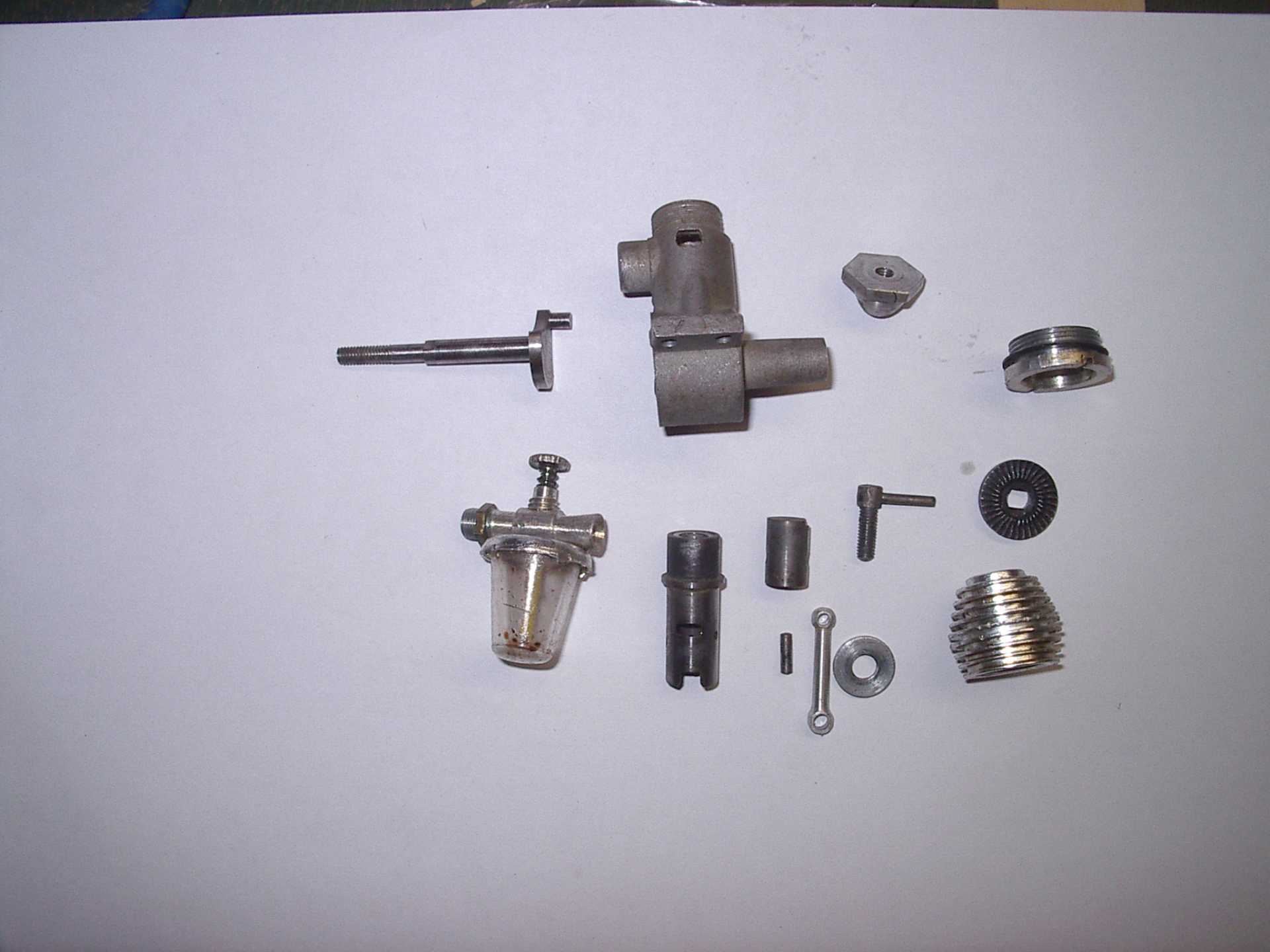

23 Feb 2017 10:06 #18 by Klipkopwildlife
Replied by Klipkopwildlife on topic 2 little Indians
Not good photos but you can see clearly that in the first the rod bends towards the web and in the second, away from the web. So I'll have to make a new one.
Thanks: Eric, THE BLACKBIRD, boz
23 Feb 2017 14:48 #19 by Quorneng
Replied by Quorneng on topic 2 little Indians
As long a the bearings themselves are not distorted I would just bend it back!
More important than perfectly flat is that the big and little end bearings are parallel to each other. ;)

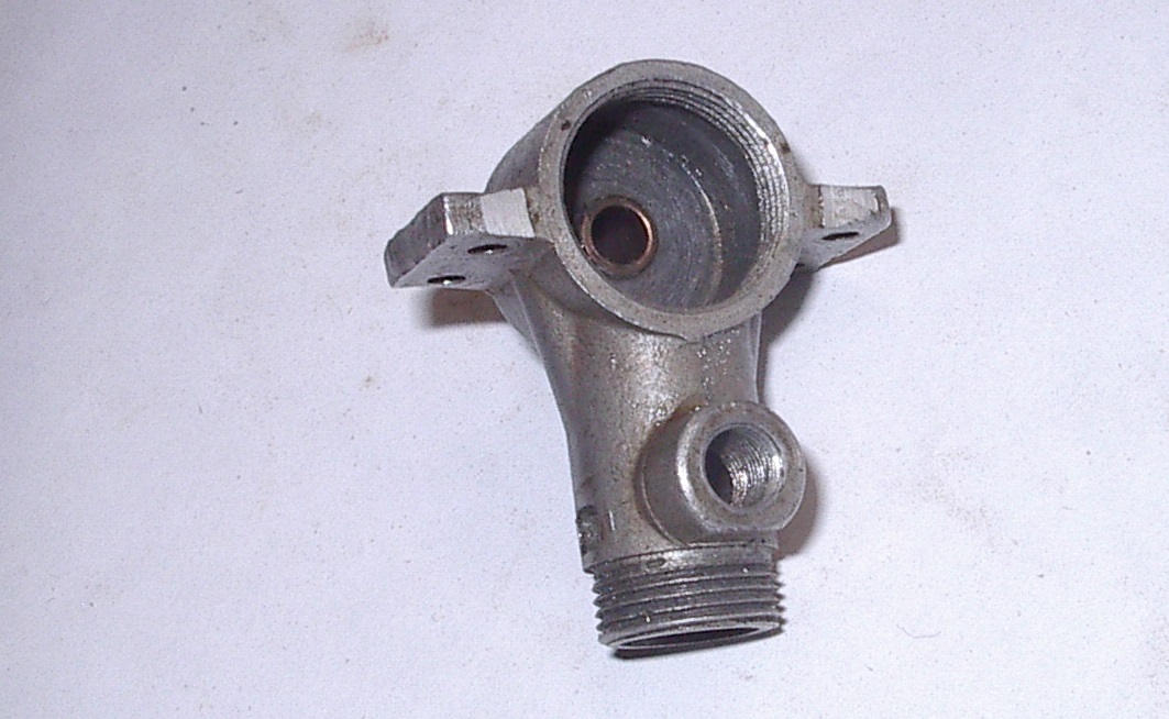

24 Feb 2017 08:38 #21 by Klipkopwildlife
Now we have a new problem!
You will remember I noticed file marks on the nose of #1, a glance at the pic shows that #1s' nose is actually shorter and worse, not even square! The measured difference is 1.5mm (1/16" Garry)
Thanks: THE BLACKBIRD, boz

24 Feb 2017 17:08 - 24 Feb 2017 17:14 #24 by Klipkopwildlife
Apart from the threads being .1mm different in diameter the crankshafts are identical.

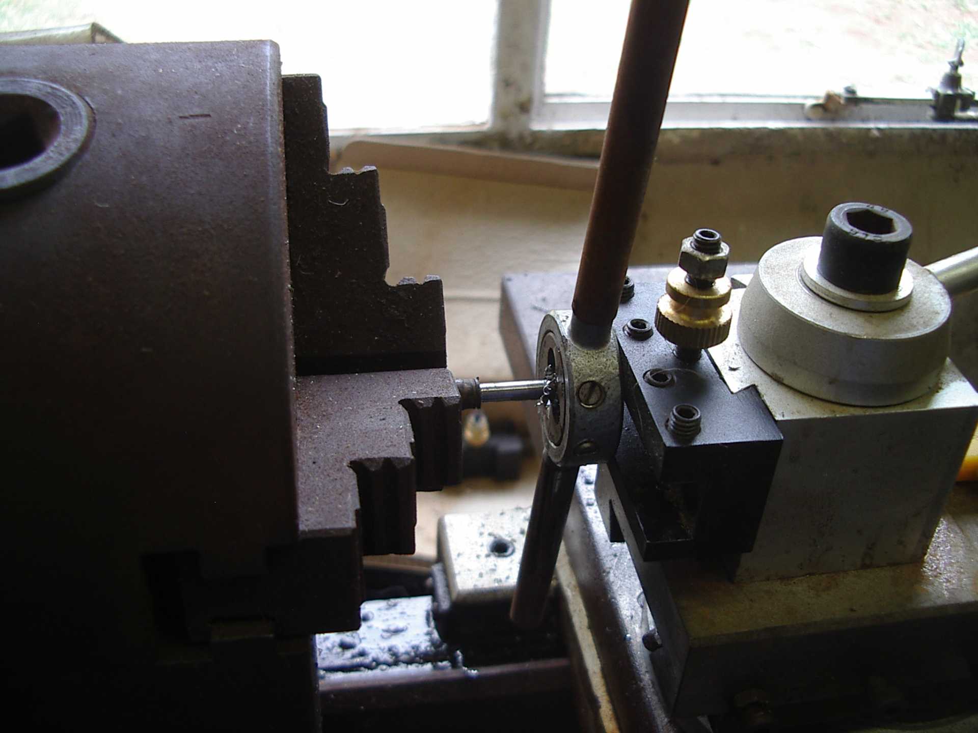

I thought I'd start on the new prop washer today.
3mm Gauge plate
A cut square, oversize, with 3.5mm hole.
Dummy shaft turned and fit tested.
4BA thread going on.
Last edit: 24 Feb 2017 17:14 by Klipkopwildlife.
Thanks: THE BLACKBIRD, boz, Squirrelnet

25 Feb 2017 08:03 #28 by Klipkopwildlife
Quorneng wrote: Very nice Klippy.
That 3 jaw has an interesting....er.....finish on it! :woohoo:
At altitude with a clear sky the temperature can drop quite low at dawn. The instant the sun is fully above the horizon warm moist air moves in and everything, especially metal, which holds the coolth, gets soaking wet! I try and keep things oiled up but it doesn't always happen. Even things kept in drawers gets a fine patina of rust very quickly.
Well I've done some more
And turned to the finish od.
Job done, milling next.

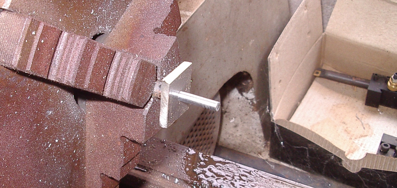

25 Feb 2017 08:12 #29 by Klipkopwildlife
I then pulled the dummy shaft forward to trim the nose.
Turned down to be a tight fit in the crankshaft bearing.
Mounted up
And finished. I had to take 1.2mm off to true it up! If you look very closely you can see casting metal intruding into the bronze bearing. I'm pretty sure these crankcases were cast around the bronze bearing which was then reamed to size.

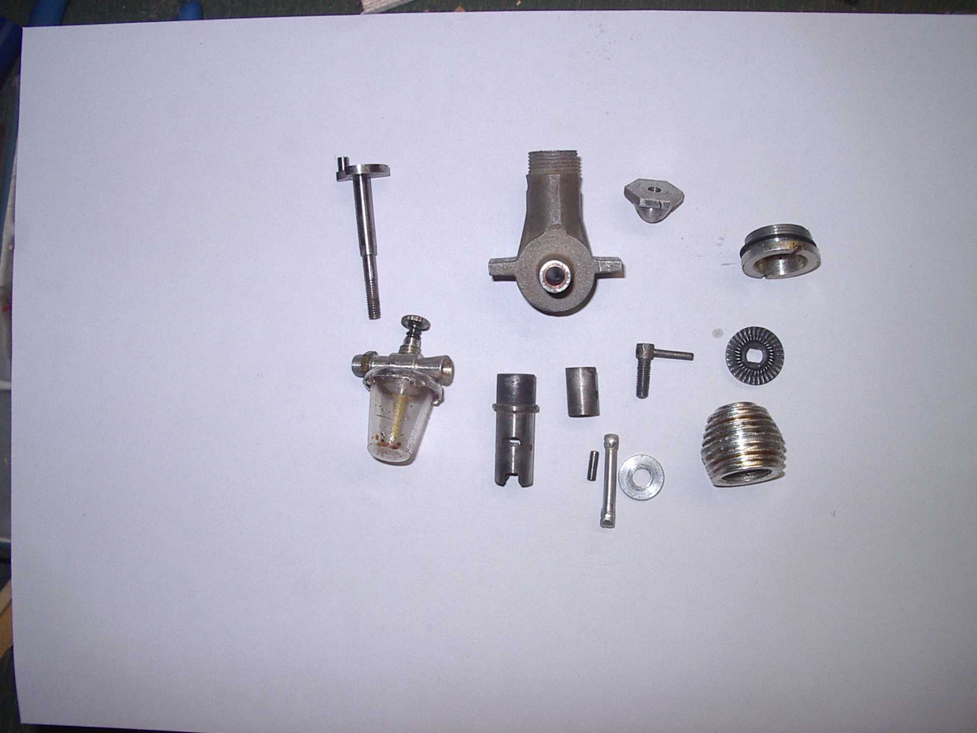

25 Feb 2017 09:23 - 25 Feb 2017 10:07 #30 by Klipkopwildlife
While the dummy shaft was in the chuck I decided to check something.
My boring bar is a little large for this job but I've skimmed the rear of the engine mounts to give a flat surface. Just a feasibility study on this engine. The carburettor attachment boss gets in the way but enough of the mounts can be machined to give a true surface. What showed up here was that the facing and threading of the rear case is way off centre and out of true!
The moulds for the pressure die casting machine are obviously badly worn which means machining the rear is out of true for the jig they had.
Since this was only a feasibility study I only went far enough to touch both sides. What showed up is that the turned and threaded rear of the crankcase is .3mm out of true with the crankshaft.
Last edit: 25 Feb 2017 10:07 by Klipkopwildlife.
