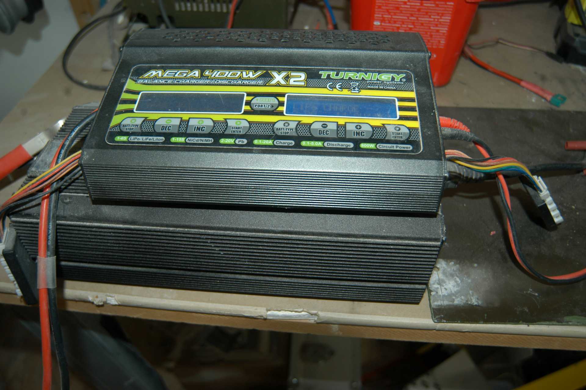

Here's my charger and power supply for it, one side pack up 6 months after i got it , and today it kept shutting off telling me the input voltage was low, so it looks like its all going to quit on me,
:evil:
Measure the input voltage from the power supply to the charger please. Both plugged in to the charger and unplugged.

Sounds like dry soldered joints to me . Give it a going over with a soldering iron.. It's worth a punt.

A pity I'm so far away I'd have a go at the soldering for you .Agh but then I couldn't test it properly as I've no Lipos
Just a thought isn't it still under warranty/guarntee ?
