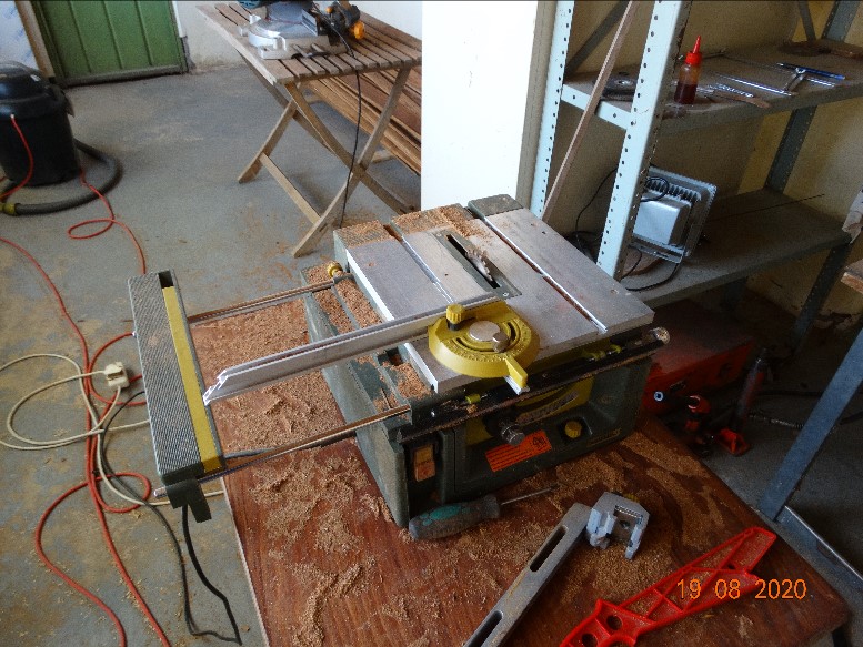

I have a Proxxon table saw, wonderful piece of kit until recently. The blade seems to 'ring' while cutting and spoils the cutting finish by causing a back cut. I'm using an 80mm TCT 24 tooth blade. I have 2 blades, both have the same problem.
and this is the kind of damage I'm getting.
I've replaced the bearings (2 x 698Z if anyone's interested) and given it a really good clean to no avail. Anyone got any ideas?

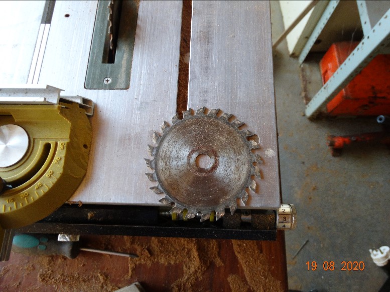

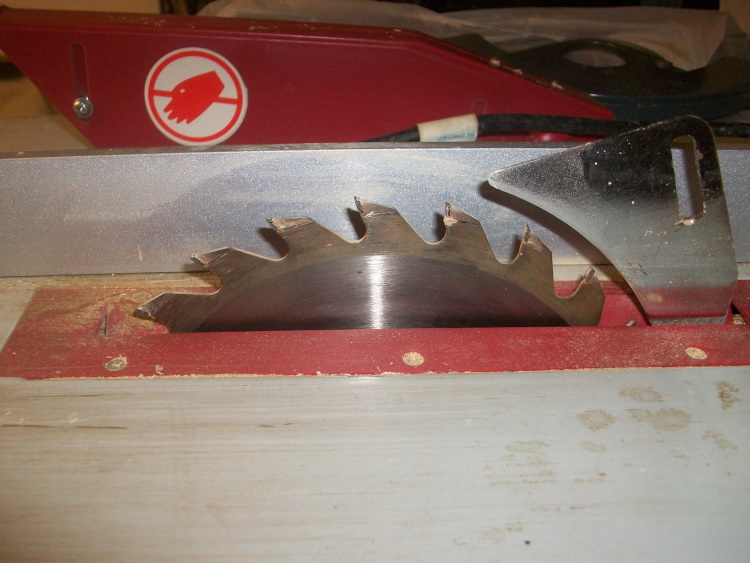

I am however a bit suspicious of the tooth shape on your saw. From the picture they does not appear to be as 'aggressive' as those on my table saw.

This is the spare blade Simon, cutting and clearance angles are all OK. I haven't as yet tried re-sharpening. Any burning that I get is caused by Mary when we run long lengths through (she can't see straight!) Under a fluorescent light you can clearly see the standing wave in the blade when it happens. I tend to use this saw to cut Teak and occasionally Perspex, it could be that I'm expecting too much blade life. Surprisingly nobody mentioned the lack of any safety covers, I admit I don't use them, they're a pain in the butt!
