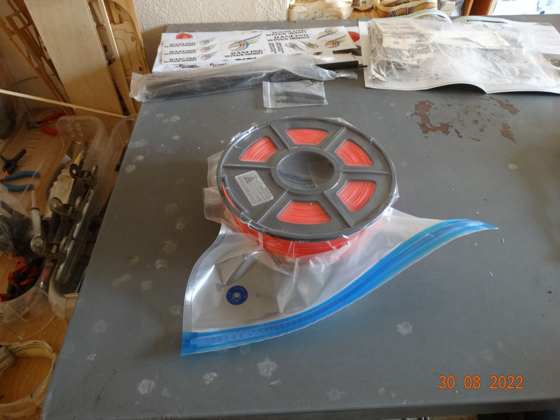

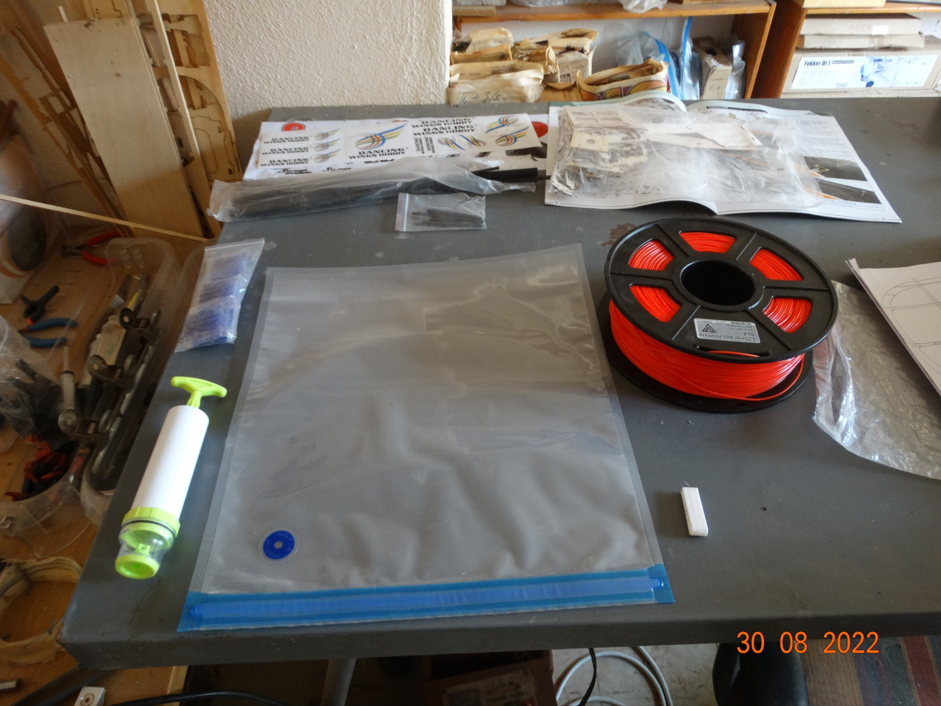

For long term storage I bought this kit of vacuum bags.
It consists of 10 bags, a pump, 10 Silica Gel bags and a sealing widget. That's the little white strip on the bottom right, without it the bags don't seal nicely, ask me how I know!
There's a valve at the bottom left, I managed to destroy the first bag, thinking the round hole was a sticker that had to be removed.
How it works I have no idea, but it does!

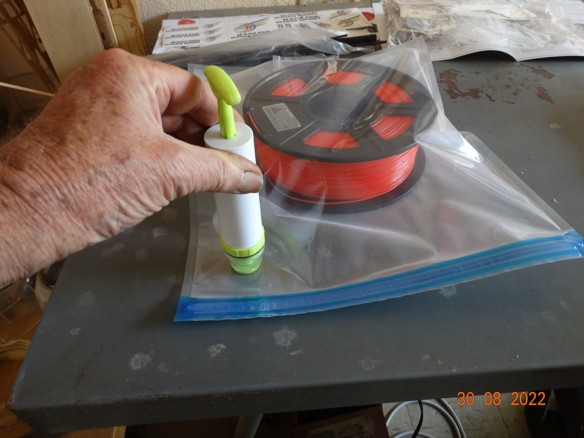

Once sealed using the tool you place the pump (un-pump?) on the valve and start pumping, if you're lazy like me and don't expel as much air as possible it takes about 100 strokes. You must put the Gel bag in before sealing!
The first roll I did I only treated for 5hrs (maximum on the timer) the next day I could clearly see the Gel sack was a delicate shade of pink!
Henceforth I have treated all rolls to 4 x 5hrs and the Gel sacks are still deep blue.
