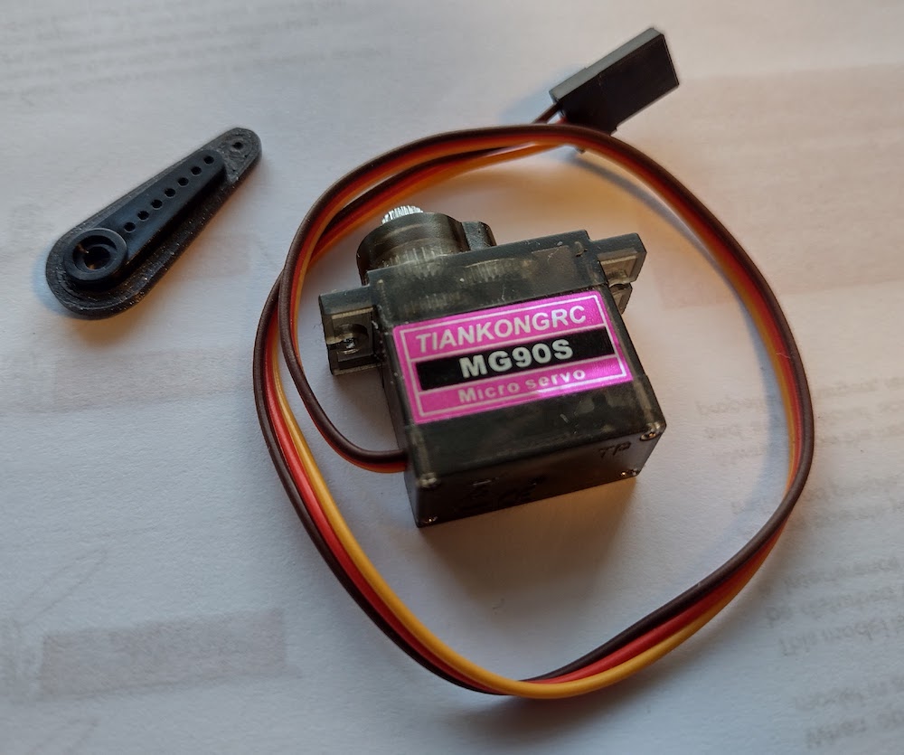

I further investigated the no-servo-action by the expedient of ordering some different metal gear 9g servos (see image).  Better quality certainly and the spec sheet quotes allowing V starting at 4.8V.  Both my Futaba Rx are working with these.  Is it because of the V difference or better internal controller is unknowable at this point.
From what I can see the non-working servos were panned in lots of reviews as a marginally useful that has go downhill into basic rubbish. I will root around and toss the rubbish so as not to be bitten in the future.
I checked it out on the servo tester as well as the Rx and the movement certainly is smoother.  So note to self - for some things spending a few more pence is worth it!
And, of course, the supplied arms are slightly different so had to tweak and reprint the extension.  Nice comments about alternatives to arm extensions in other chats that I will keep in mind.
