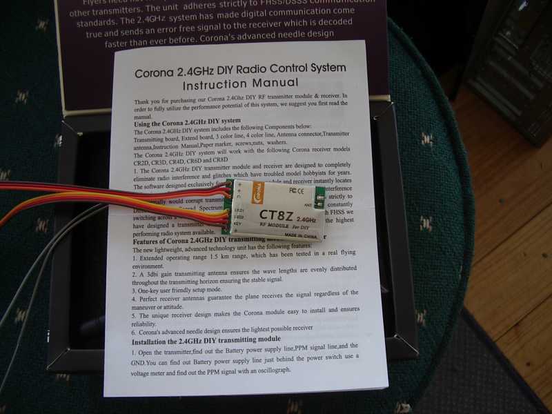

All nicely packaged, with a few extra nuts and bolts. The manual is the usual Chinglish, but adequate, if you're pretty good
at mind reading

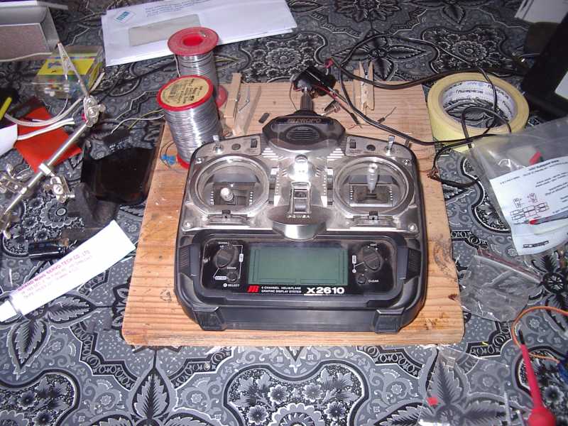

I had a JR2610 laying around.

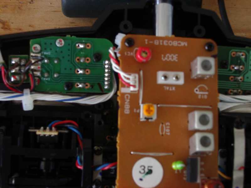

First take the back off, take out the Crystal and make sure you get ALL the screws.
Now you have to decide where to put the bits. It doesn't look like it but there's plenty of room.
Those 3 wires are the ones we're going to be working on, be careful, that's not a plug! Ask me how I know :angry:

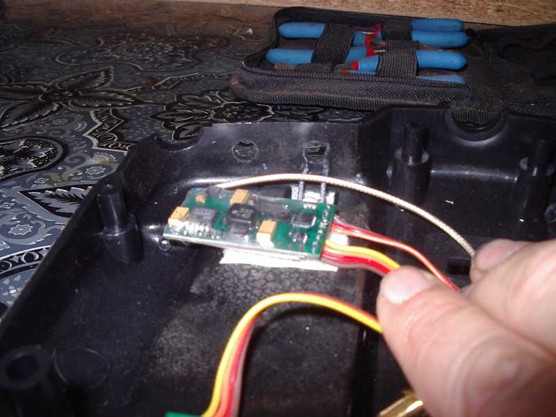

Solder the antenna coax onto the board.
Here's where it goes
Done, it's not immediately obvious which way it goes.

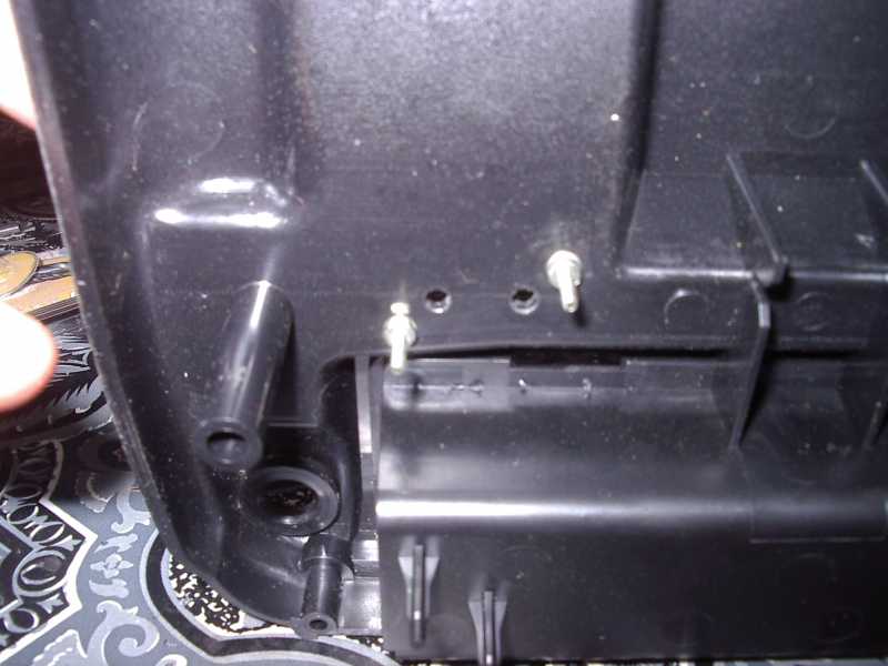

Now we're going to drill the hole in the back cover for the antenna
The people with quick eyes will notice I've drilled two holes, if you're going to be 2.4 only, you only need the righthand one. I decided to have the tranny switchable between 35meg and 2.4, that's the reason for the second hole, it's for a changeover switch. You will find that the switch hole drills into two re-inforcing webs in the case, you'll have to cut them out with a scalpel.

Well so far it's been plain sailing, now we get to the tricky bit. Rembember way back, the pic with the 35meg TX board? We're going to those 3 wires marked CNBB on the board.
The instructions say 'find out the battery , PPM and GND' (that's the short version!) If you're doing a JR, the red is positive (Battery) The wire next to it is PPM, and the last wire is negative (GND)

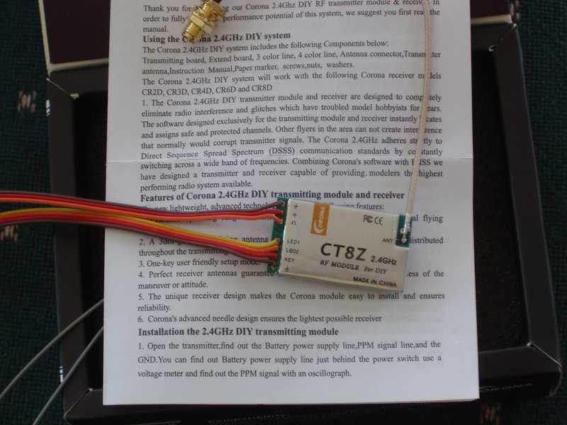

You have 3 wires coming from the 2.4gig side, split them so you've got about 50mm, 2inches of wire to work with. Red is power, Brown is Ground and Orange is PPM.
Bare the wires for about 10mm, half inch.
Warning, when you cut wires, always leave enough wire to reconnect if you've made a whoops! Ask me how I know:angry: Cut the red wire, fold the 35meg (connector) side out of the way. Slip a piece of heat shrink over the 2.4gig red, strip(bare), twist the two reds together and solder. Bring the heat shrink up and shrink. I usally cheat and just hold the soldering iron close, but a hot air gun (hair dryer) does work better. (don't get caught)
