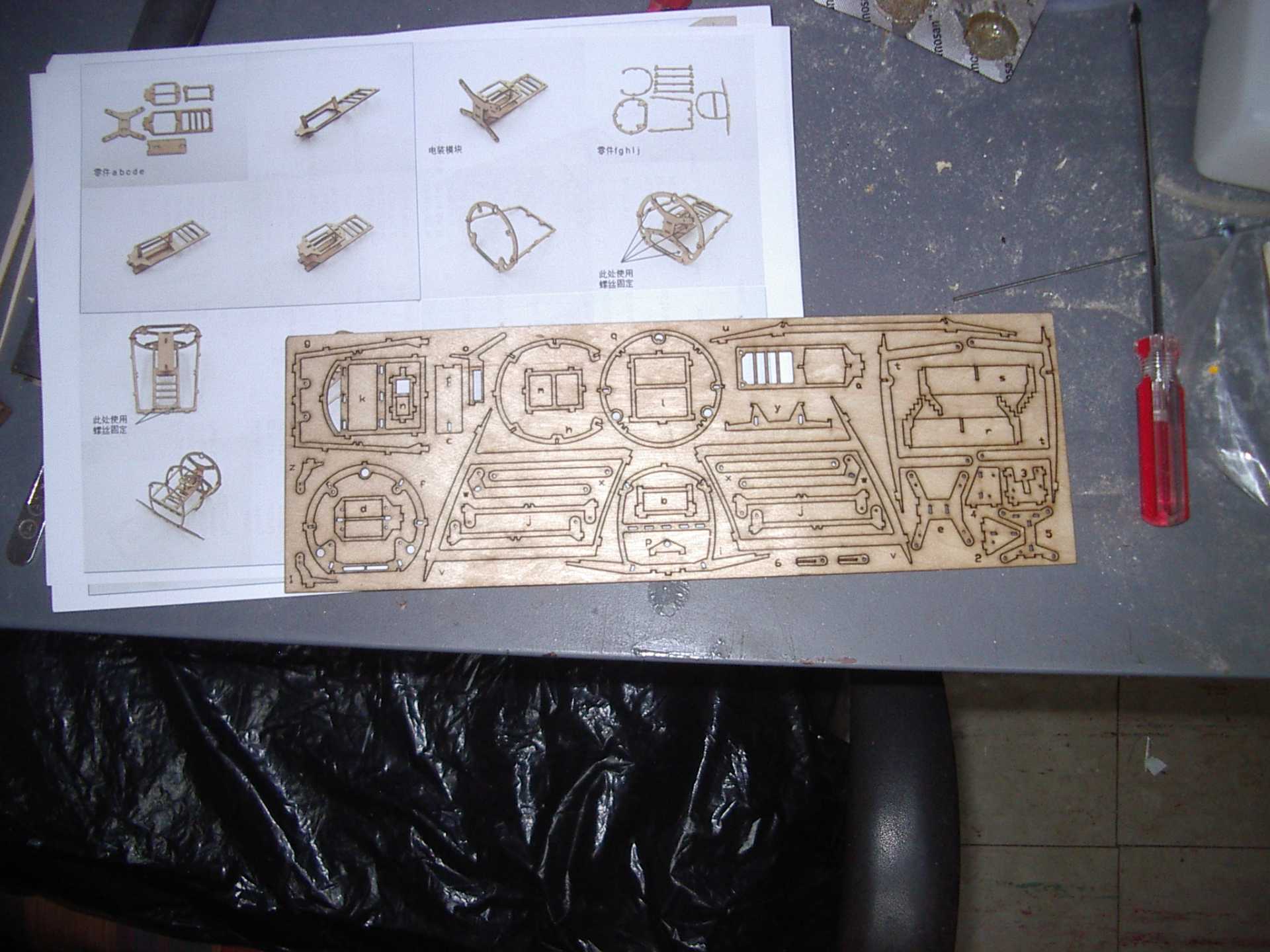

The Tiger Moth is stalled (sic) at the moment due to my lack of mobility in the afternoon and evening so I rummaged through my stock and came up with this . An RC 2 channel laser cut model.

I've never attempted anything this small (except Airfix kits 60yrs ago) but at least I don't have to move around to work on it.
The quality of the cutting is absolutely exquisite. The instructions are only hieroglyphics so definitely not a beginners model.

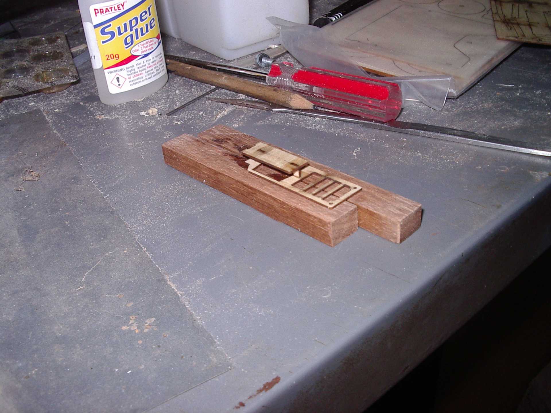

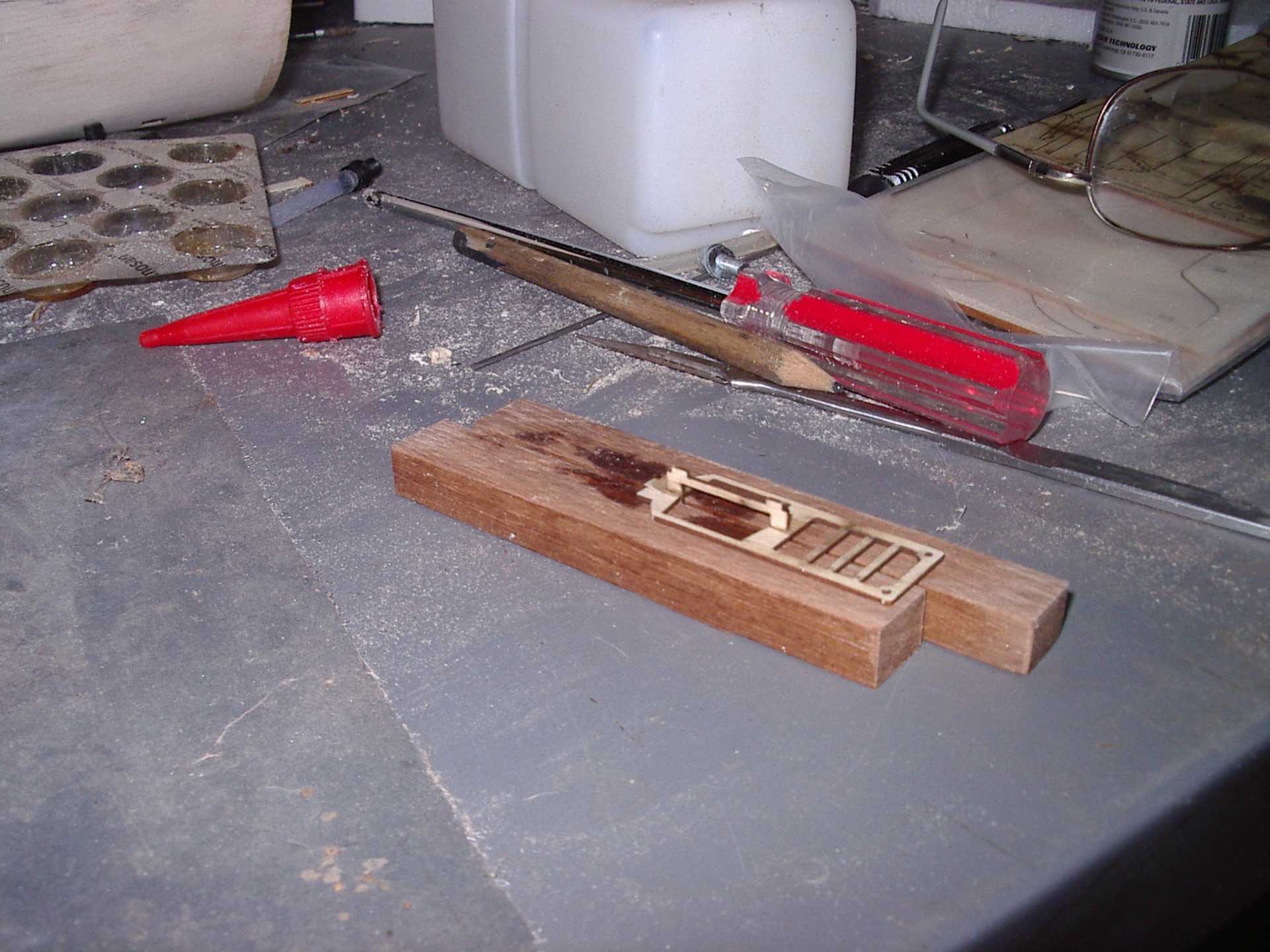

We start with the servo mount.
Keeping things square proved to be a challenge.
Big fingers and old age shake don't help much!

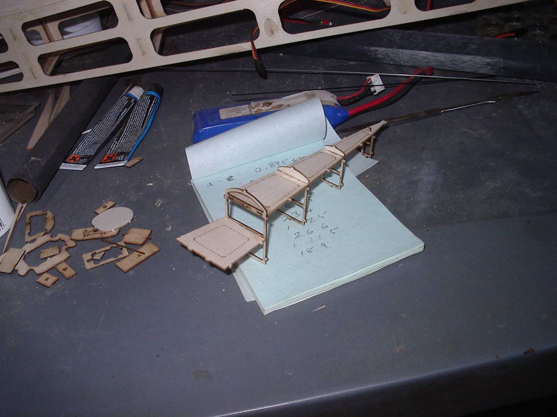

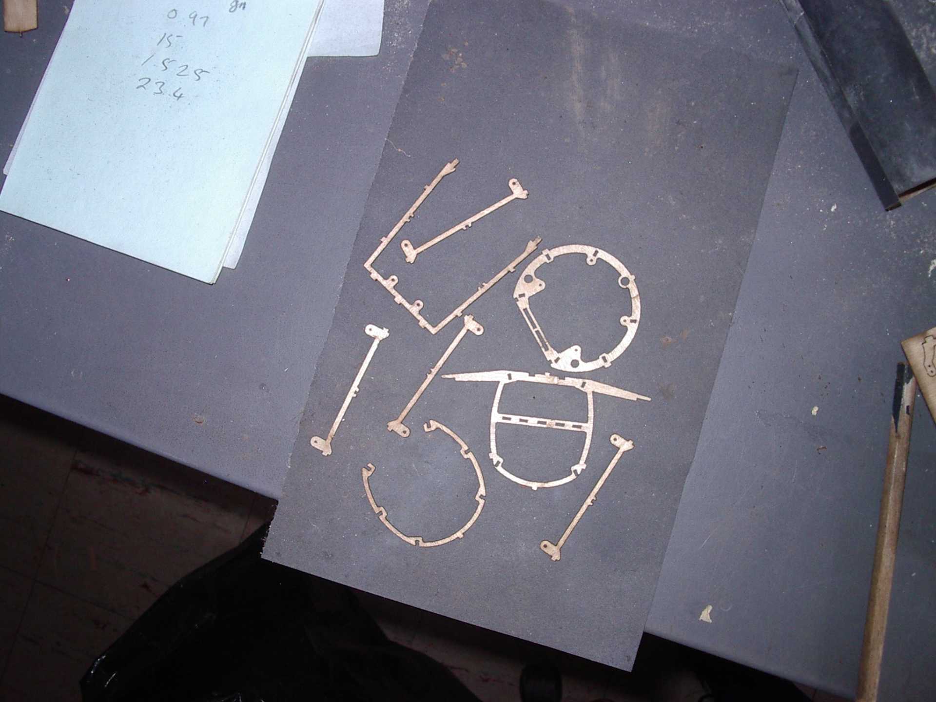

Because I'm interested in these things I weighed that first component The parts weighed 0.895gm or 13.1gn (Grains) after gluing together it weighed in at 0.97gm or 15gn, a weight increase of 14.5% on the unglued parts, ouch. And that's Cyano.

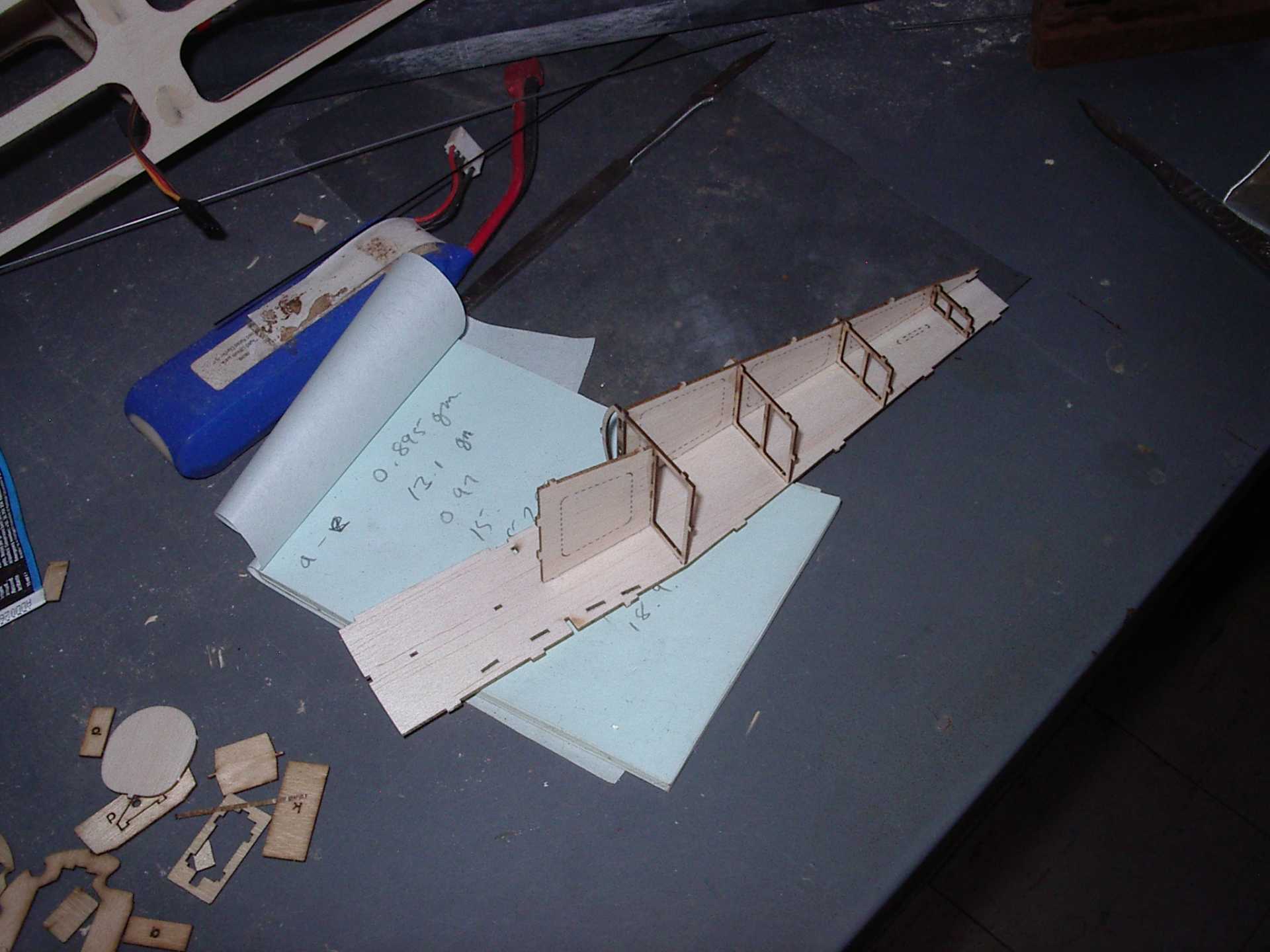

These are the parts that make up the forward fuselage, weighing 1.525gm or 23.4gn
Partly complete
And complete
Weighing in at 1.725gm or 26.6gn. Much better only 9.4% increase over the parts

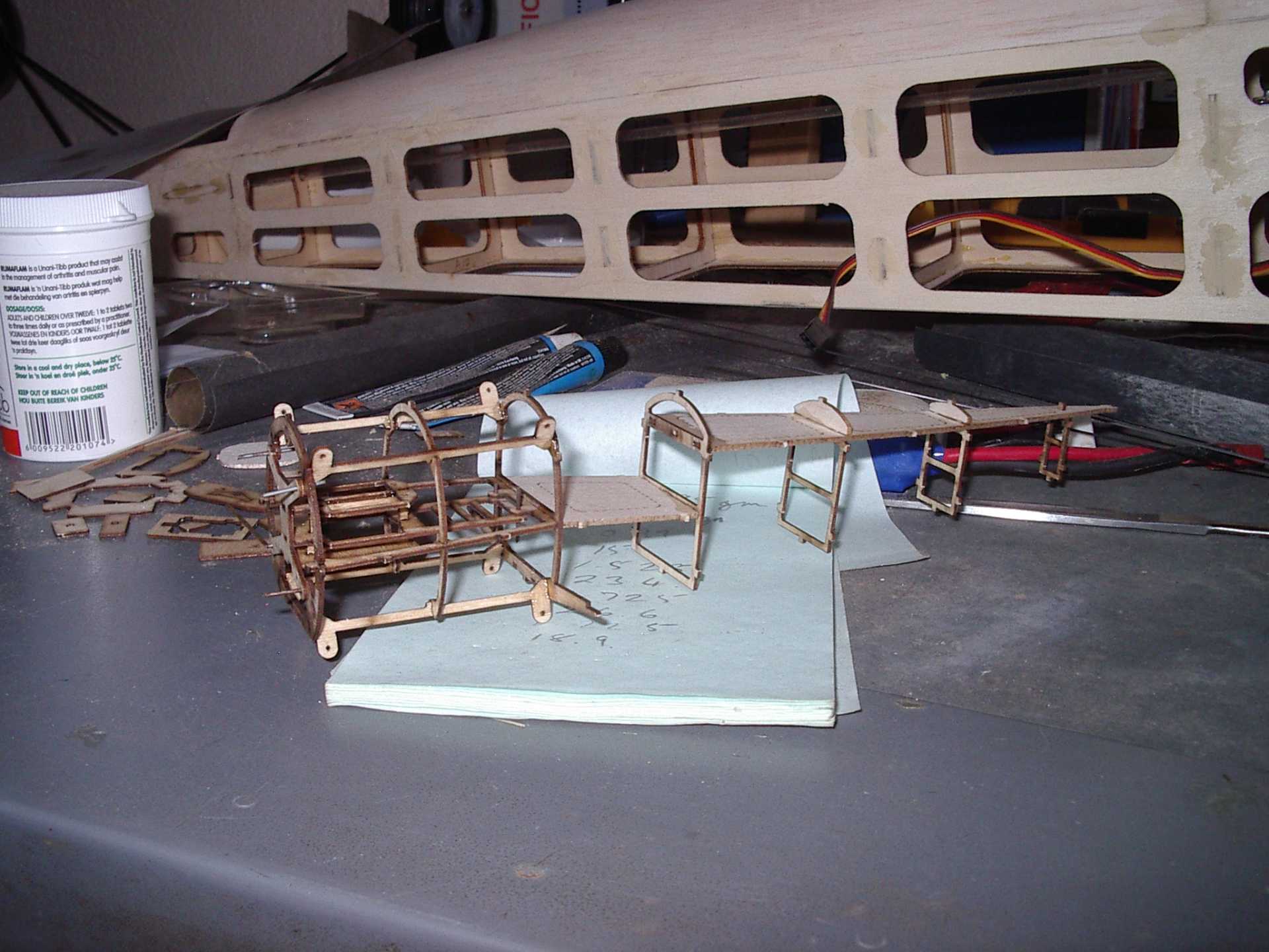

The servo tray fits inside, there are small holes that all seem to line up, for the time being I've just used some wire to make sure everything lines up.
I find that thin Cyano doesn't work, it just disappears into the woodwork! A medium thickness seems to work fine but at the cost of extra weight because of the larger drop size.

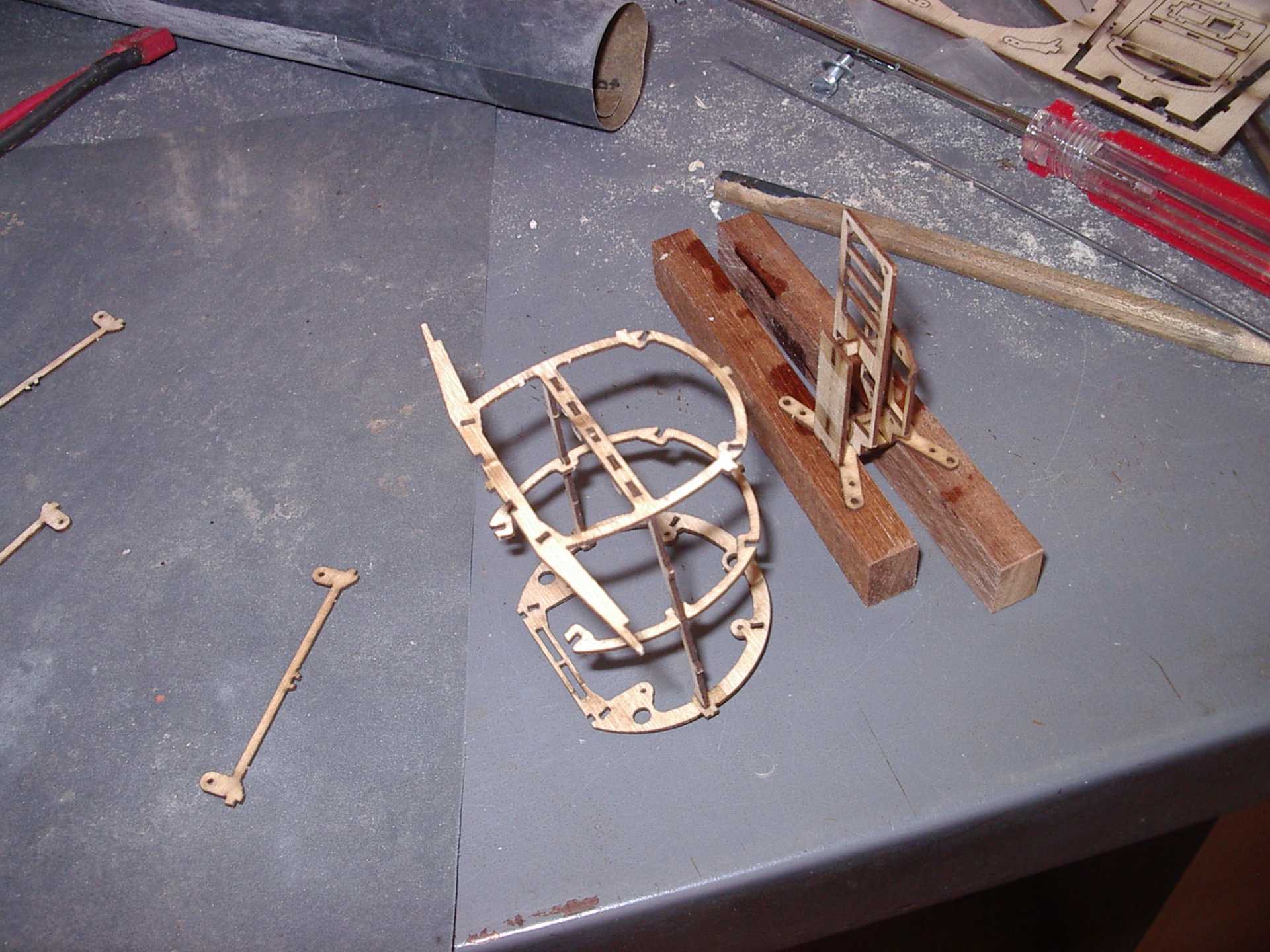

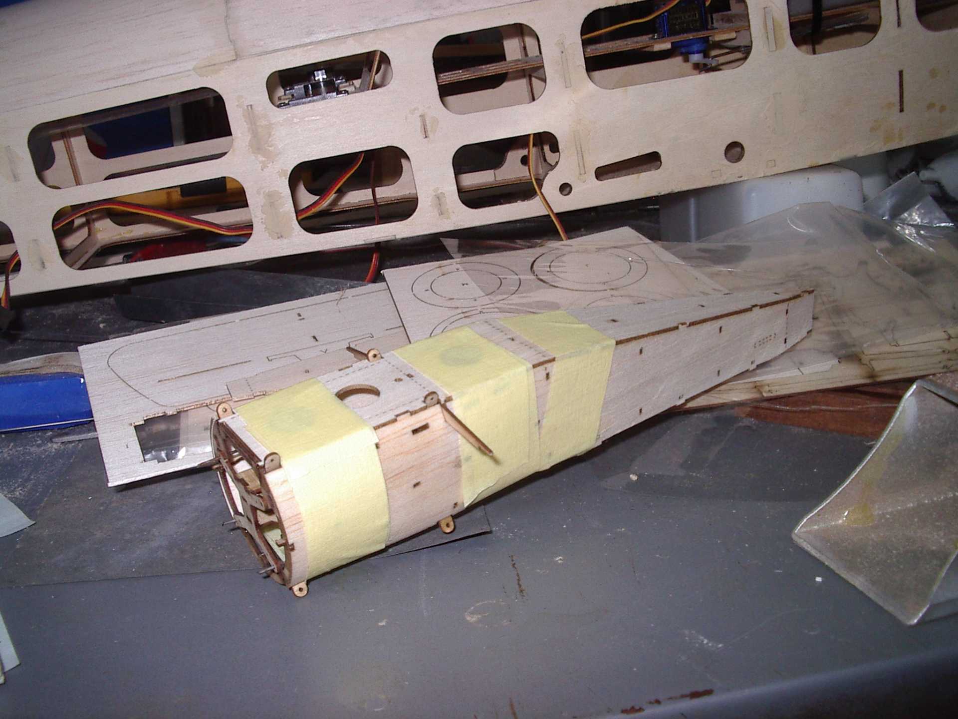

Moving on to the fuselage proper
Those dotted lines are actually laser cuts, those parts are designed to be cut out after the sides are on.
Thanks: THE BLACKBIRD, old fart
  • Away
18 Apr 2018 17:55 #10 by Klipkopwildlife
Replied by Klipkopwildlife on topic 15" Sopwith Pup
Before I glued the formers on I checked to make sure they would key into the fuselage sides.
Now we can put the forward section on
So far everything's fitted perfectly without any need to open holes or file tabs.

Looking at that fuselage I cannot imagine why the top rear is a 'solid' piece. The last thing you need on a Pup is unnecessary weight to the rear! or is it just a 'jig' for construction purposes?
  • Away
19 Apr 2018 16:54 - 19 Apr 2018 16:58 #15 by Klipkopwildlife

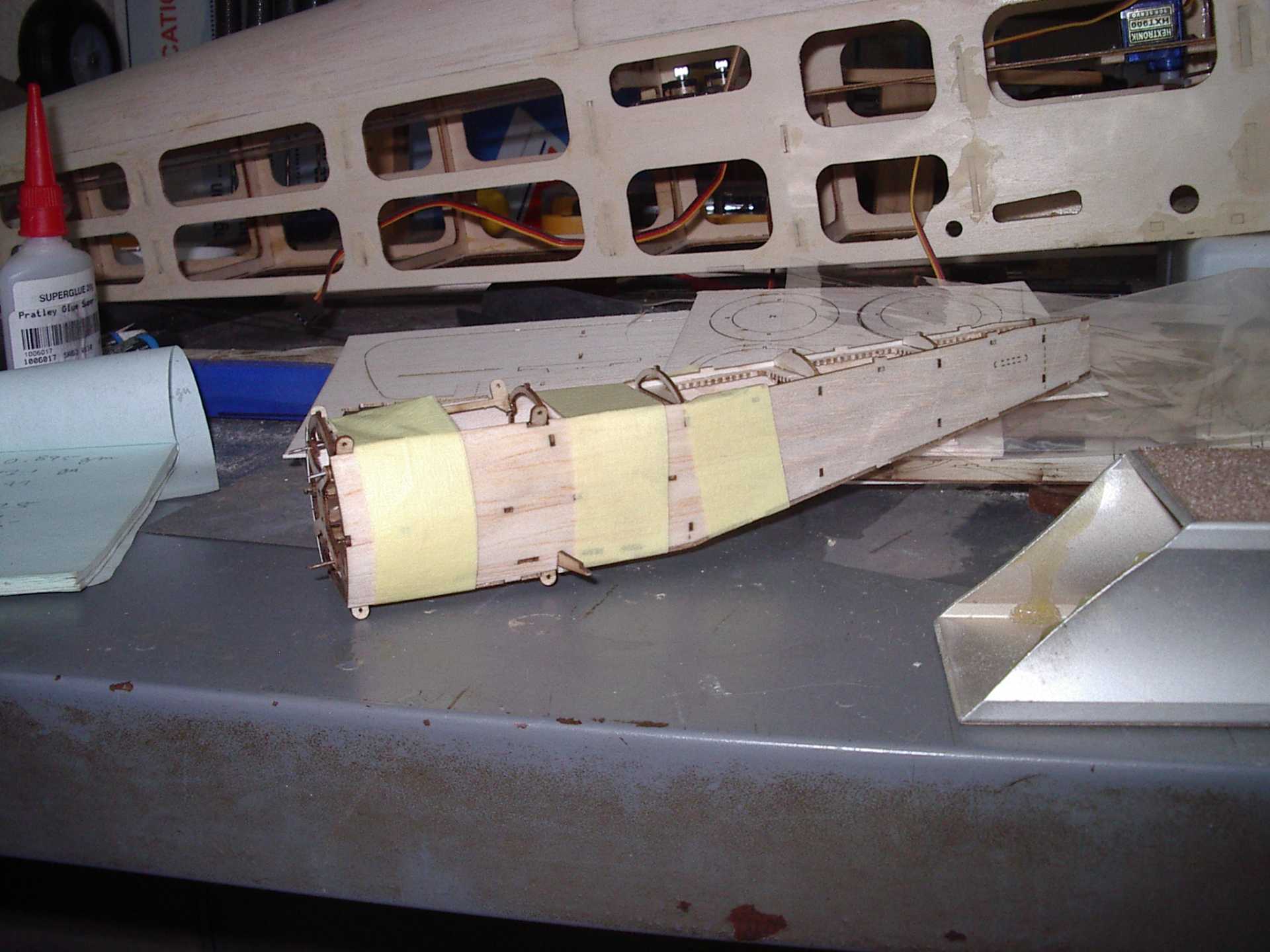

Simon, post #9 the inner 'crutch' is mostly cut away, the top deck is very thin, soft balsa.
Here you can see where the inner former has been cut away prior to putting the top deck on.
The fuselage sides on, also very thin, very soft balsa.
