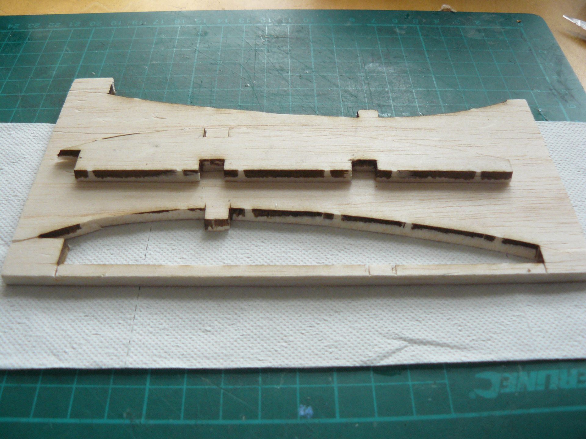

06 Mar 2026 15:52 - 06 Mar 2026 15:57 #12 by Magpie
Replied by Magpie on topic Laser Cutters
I had a play around with the S & F values on a piece of scrap 5mm balsa & got a decent cut with S500 & F500 so I bit the bullet & cut the root ribs in 5mm balsa. This must have been a slightly different grade from the scrap as it cut slightly shallower, but still acceptable.
The laser cut parts I got in the VMC kits had break tabs in so I incorporated them but at least in this 5mm balsa they weren't needed, the Model Barn's kits didn't have them - my cuts were similar to his (though not as scorched) so maybe it depends on the thickness of the material.
One little funny with the LbreCad-SVG- LaserGRBL process, it picked up the the construction points for the ellipse I used & was going to cut them.
