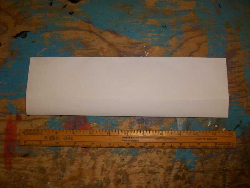

Kev - a thinner wing section will allow the model to fly faster, not necessarily further. A fat rounded section is better for slower efficiency.
An undercambered (concave) underside to the wing will be more efficient than a flat one, while a Bi-camber (convex on both sides) will fly better upside down than either of the other two!
A sharp, pointy leading edge will stall earlier than a blunt round one.
It's all a question of compromise, deciding what you want to achieve with the aircraft.

The new thinner and ribbed wing was not as good as the existing one and was very fiddly to make. As Eric says the fat rounded section is best.
But the project is a success thanks to this site and especially Eric.
You to can make a working glider from A4 and Sellotape, its really cheap, quick and is a great way to introduce kids to flight and modelling.

Nevertheless the concept of drinking straws is a good one so I did a bit of playing around with paper tubes and built half a wing to see how it would came out.
It has a paper tube spar however I must admit it is all glued (craft PVA) rather than taped.
It weighs 5.3g.
Now where are those drinking straws!
At these small sizes I doubt you will achieve a glide much better than 4:1 (40ft for 10ft drop) so your latest version is not bad.
