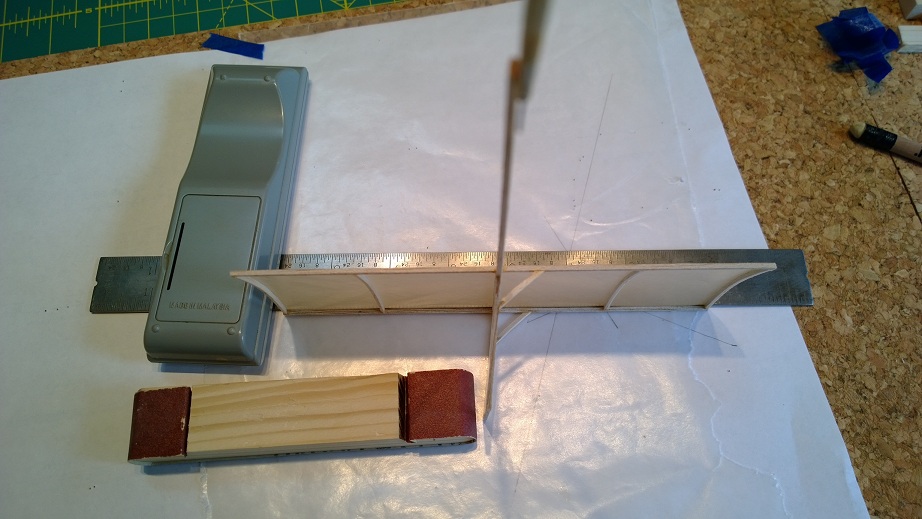

Finished my model this weekend. Here's some pics of the progress.
This is the rudder and stabilizer, covered with condenser paper and being glued up.
This is the covered wing being set to the 4" dihedral (2" per wing).
This is the wing posts and struts with the 1/16" tilt in the front post to add the 1/8" wash-in to the left wing.
These are the little homemade tube posts.
Now, for the flight results: wait for it . . . . 2 seconds!!!! and it hit the prop and broke the spar in half . The plane did a nose-dive right out of my hand! :oops:
So I made a new one with a different design. Also, my blades were .065" thick and Williams recommends .025". So, I went with Williams' suggestion. Unfortunately, this makes the CG of the plane move, so I need to move the wing post tubes. But in the interim, I stuck some pins in the fuselage in front of the wing, and she leveled out, flew half-way around the room and hit the wall, and broke the front bearing off. Oh well, I'll fix that tonight and try again.
So I guess my top flight time is about 6-7 seconds, but it is an improvement over flight #1!
