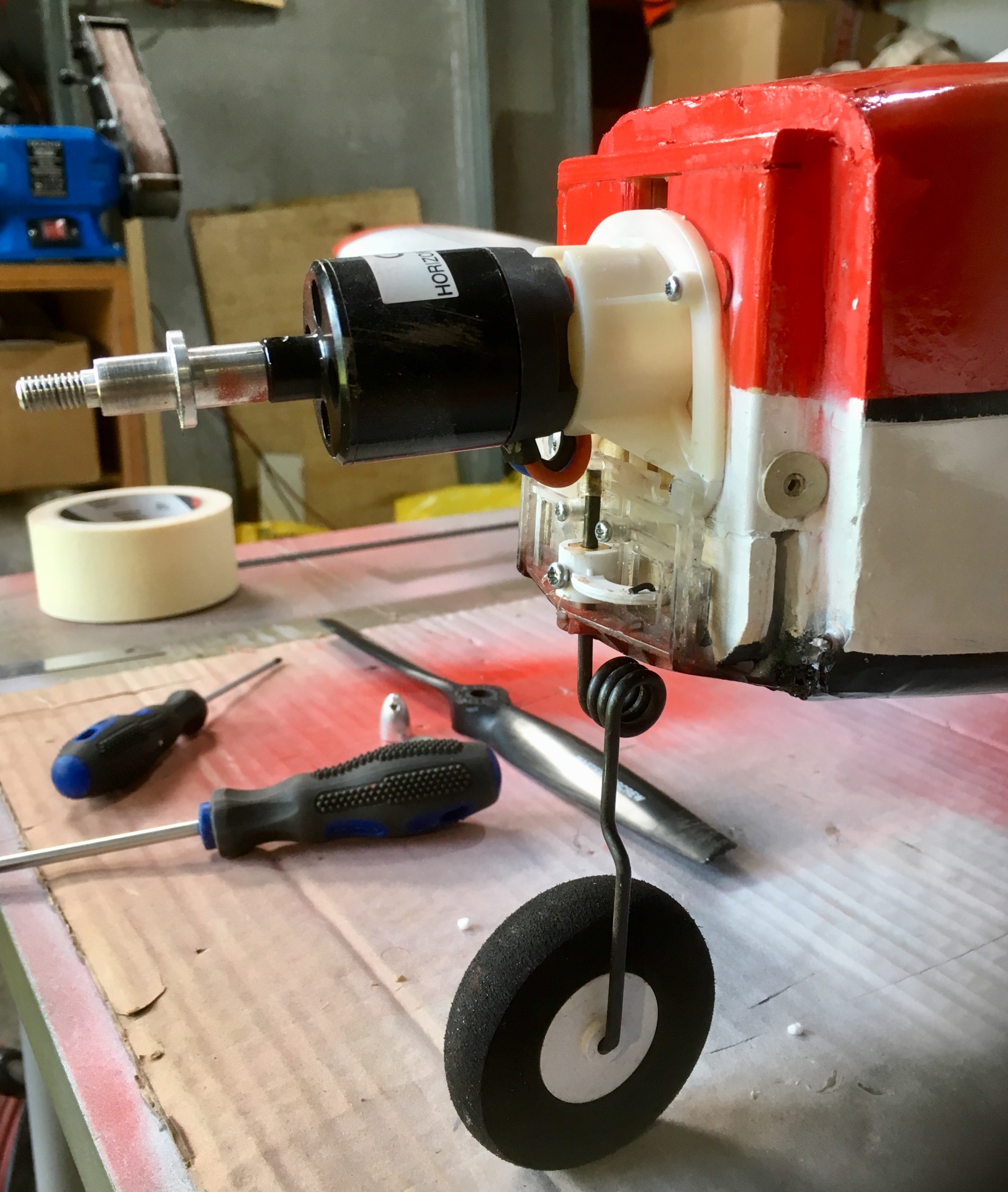

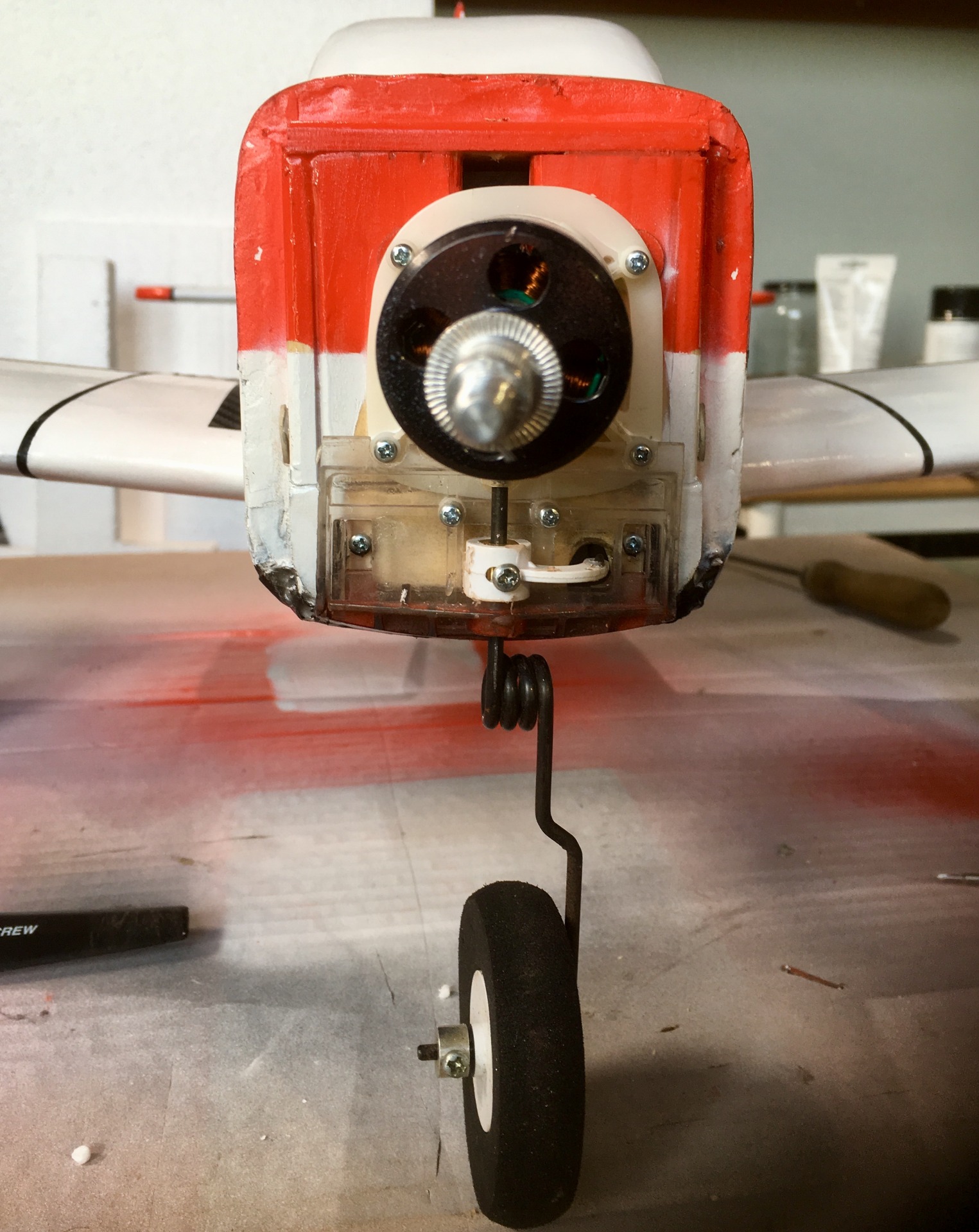

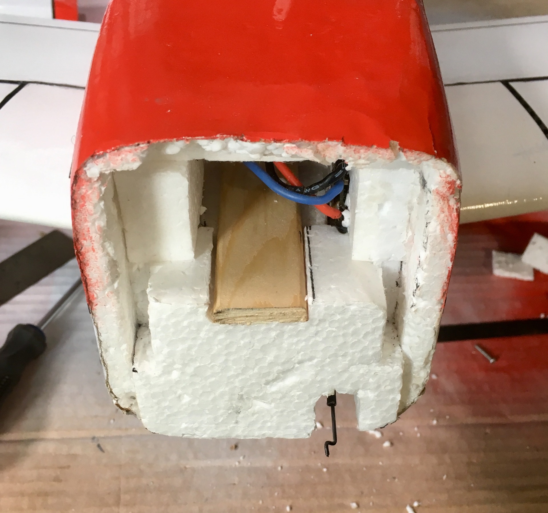

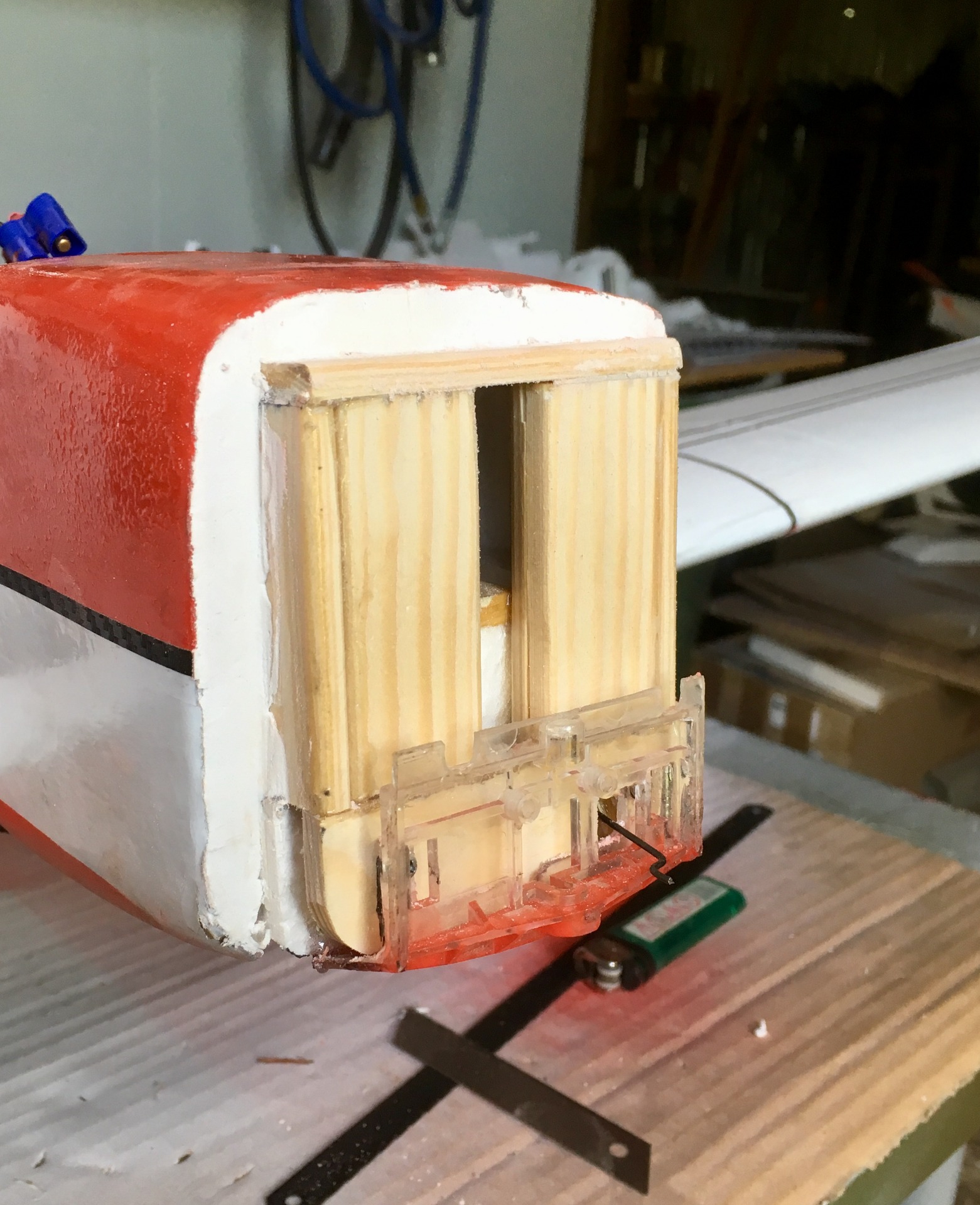

08 Oct 2019 16:31 #80 by crash happy
Replied by crash happy on topic Piper Cherokee ( nearly)
After a reasonably good test flight ( details can be found in "been flying") I started on some more mods to the Cherokee. The whole nose section has been strengthened internally & a new wooden firewall made. The firewall is now recessed into the nose & deigned to spread the load on the nose wheel through the whole structure. Everything was glued with epoxy & filled lightly around the rough bits. Sanding, painting & fitting the motor tomorrow when everything has dried.

Why are you using a Glow prop and not an electric one? They're so much more efficient and better balanced.
Thanks: crash happy
12 Oct 2019 14:26 #89 by Quorneng
Replied by Quorneng on topic Piper Cherokee ( nearly)
And a long prop adaptor too!
Its an out runner which means the prop, and any out of balance forces, are now a long way ahead of the front bearing.
In engineering terms shafts 'over hung' beyond the bearing are never ideal. In this case the motor bearings will be seeing loads multiplied several times compared to the same loads if the front bearing was close behind the prop. Just saying. ;)
Thanks: crash happy
12 Oct 2019 14:48 #90 by crash happy
Okay, I understand both your points. The simple answer is they are donor parts from another model. The prop is the one recommended & is supposed to be for electric, I bought ten of them & so far they have needed very little balancing, three are in use. The prop adaptor is as fitted on the model it came from, Stefan's old Apprentice. We have both been flying these planes since the spring & touch wood have had no problems with the motors. Still appreciate the advice though. :)
