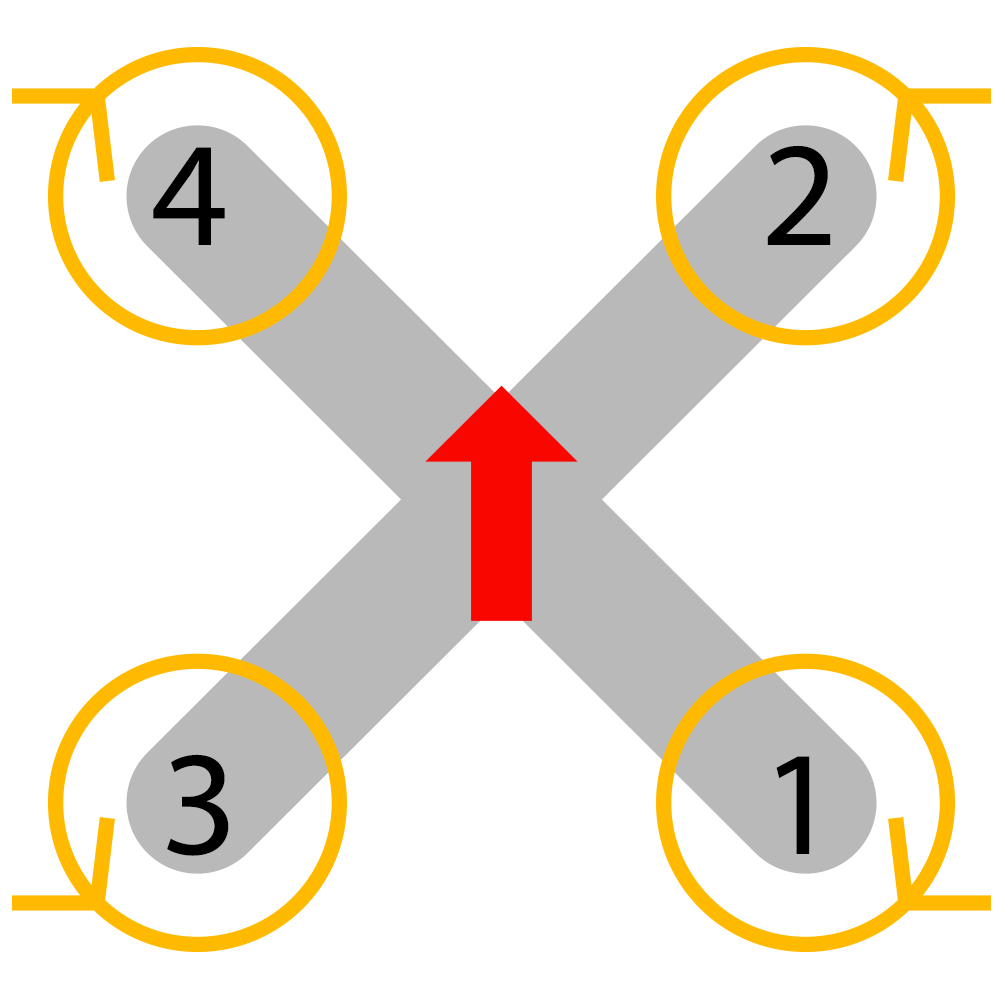

09 Nov 2020 20:41 #24 by admin
Replied by admin on topic Polydrone
Im using everything Dad taught me about electronics but i know I'm still WAY out of my depth :woohoo: ...
I now have 4 motors wired in to the ESCs. All spinning in the right direction.
I haven't mounted the flight controller or receiver properly yet. just left it dangling for the purpose of testing motor direction.
Thanks: Klipkopwildlife, Flytilbroke, old fart
09 Nov 2020 21:18 #25 by Eric
Replied by Eric on topic Polydrone
Opposing corners going in opposite directions?
09 Nov 2020 21:42 - 09 Nov 2020 21:43 #26 by Quorneng
Replied by Quorneng on topic Polydrone
"Opposing corners going in opposite directions?"
As far as the sum of the torque goes it doesn't matter how they are placed as long as they are equally spaced from the centre but for gyroscopic effects I think Mike has it right but I could be completely wrong!
Last edit: 09 Nov 2020 21:43 by Quorneng.
09 Nov 2020 22:16 #27 by paul d
Replied by paul d on topic Polydrone
surely in order to balance the torque every prop should spin in reverse compared to it's neighbour? IE: cw,ccw,cw,ccw.
09 Nov 2020 22:57 #28 by Quorneng
Paul
4 engine plane. 2 CW on one wing, 2 CCW on the other wing. Assuming they all generate the same torque Is there any overall torque on the airframe?
  • admin
  • Make it count!
09 Nov 2020 23:13 #29 by admin
This is the current setup as tested tonight.
10 Nov 2020 07:38 - 10 Nov 2020 07:51 #30 by paul d
That's the way I would have set it up ( as mentioned in my previous post).
Simon, I understand what your saying but I was talking about this particular model.
Last edit: 10 Nov 2020 07:51 by paul d.
