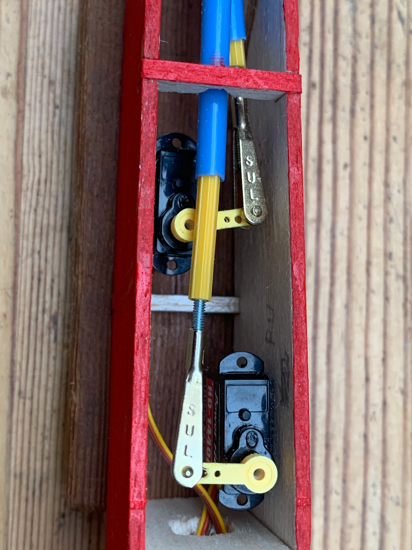

Just completed my lockdown labour, the beautiful classic Keil Kraft Caprice glider, built from a Vintage Model Company kit. I have adapted it -- taking advice from many previous postings -- for unpowered 2-channel RC (elevator and rudder).
The stabiliser I've redesigned to incorporate a hinged elevator, while preserving the Caprice cruciform structure,
and the rudder is enlarged to provide greater authority. Two PowerHD micro servos and a Planet RX are located within the narrow fuselage underneath the wings and power provided by 4 AAA cells futher forward, immediately aft of the cockpit.

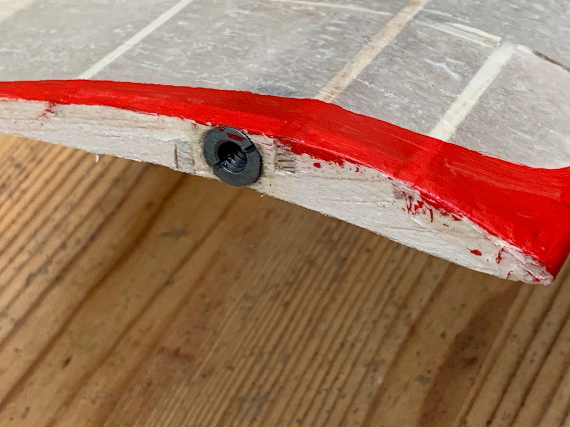

Semi-flexible snakes inboard connect the moving control surfaces.The model balances out at 240gm with batteries.For ease of transport, I've made the original 1300 mm wing separable as well as removable, the two halves joined by a 5mm dia carbon fibre rod extending through the innermost three ribs each side.

Don't forget to put your servo arm screws in! :woohoo:
