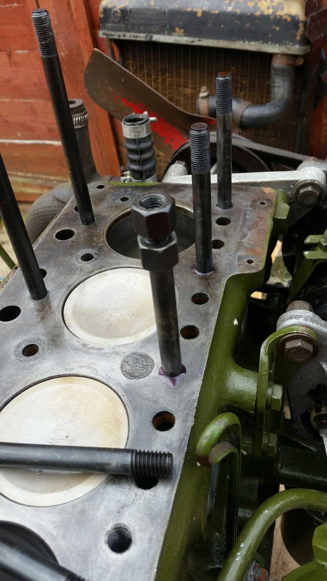

one tenor wrote: Check all studs for tightness as I have know come studs that enter water jackets to corrode the threads out. The cure is a Helicoil or equivalent. On the other hand it could just be loose as Klippy said and needs no more than sealing and tightening Re the gasket copper side down is normal but the fibre ones are best soaked in water first to allow them to take up any irregularities. Payen are a good make as are the MLS (Multi Layer Steel) ones.But have the head and block been skimmed or at least checked for truth. All the gaskets in the world won't last 5 mins if the.y are not true

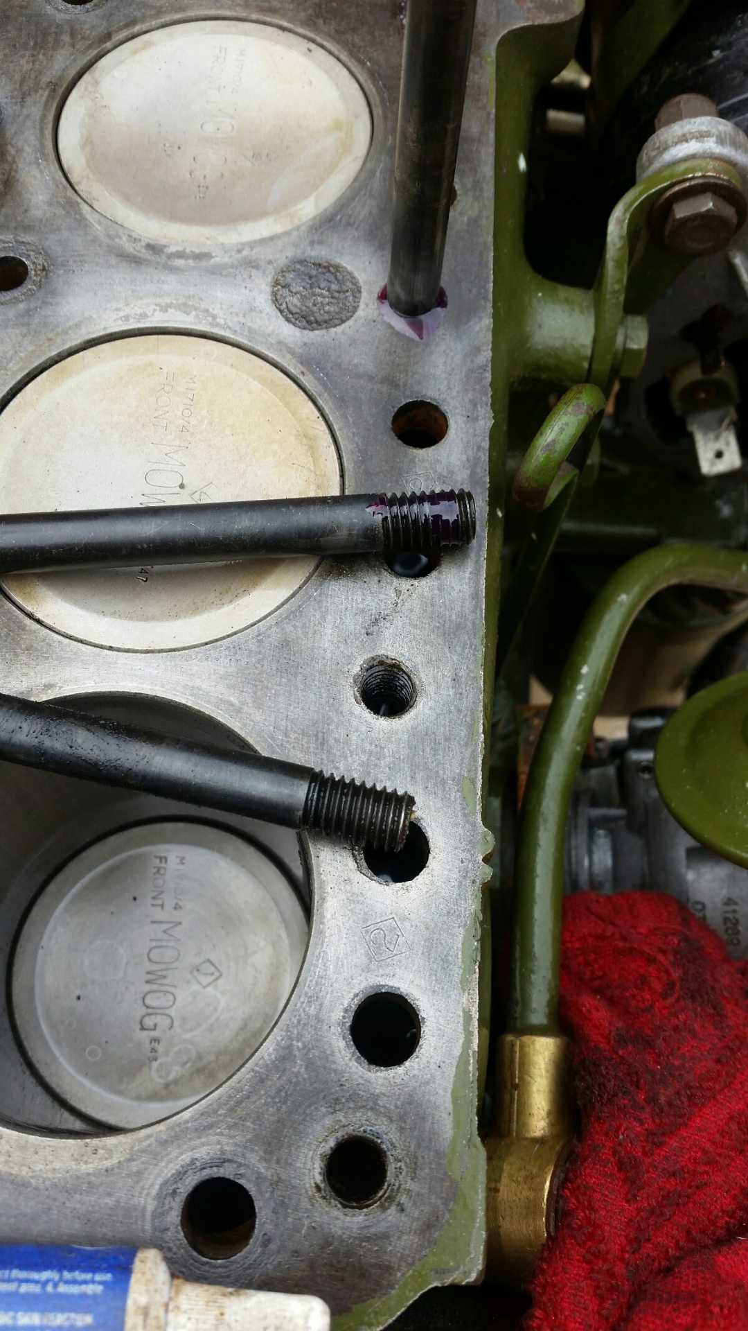

Good afternoon boys and girls, well head off again, klippy you are right again, I had only put the head studs in finger tight.obviously they weren't tight enough to stop water coming up the bolts.
So took them all out and thread locked them in , using the double nut method.
Got them nice and tight.
