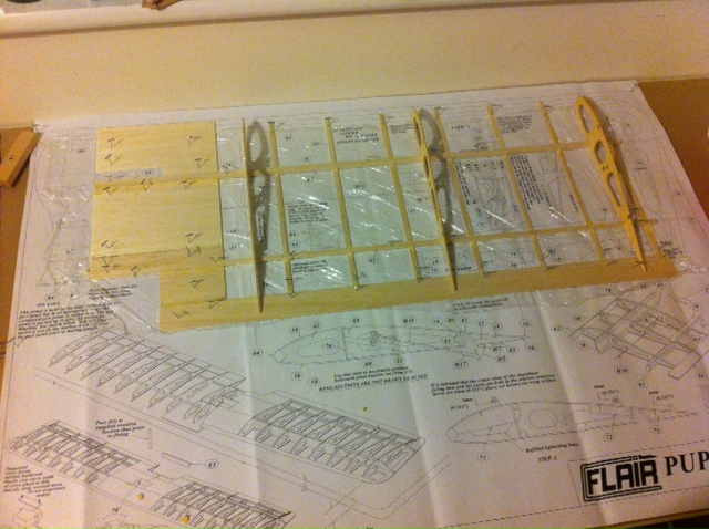

I am waiting to go to the Local model shop to pick up some piano wire for my kavalier and I just can't get the enthusiasm up for the deagostini spitfire.
soooooo I decided to make a start on my Pupeteer, the wings are built slightly different to how I have built wings before, the capping strips and lower centre sheeting are pinned down on the plan first, then the spars laid on top and then the ribs.
Anyway a picture!! Please ignore the tin I store my pins in, it has a west highland terrier in a Santa hat on the lid :lol: :lol: :lol:
I nearly choked on my latte.
01 Oct 2012 20:55 #2 by Ex-Member
Replied by Ex-Member on topic Re: Flair Pupeteer
looks interesting to build, those ribs are thin. :unsure:

01 Oct 2012 21:23 #3 by Dean M
Replied by Dean M on topic Re: Flair Pupeteer
They do look a bit thin don't they, they are 2mm liteply. I may try and beef up where the undercarriage mounts it doesn't look to strong!!!
Will take plenty of pictures as I progress, I'm not a very fast builder though :lol: :lol:

01 Oct 2012 21:27 #4 by old fart
Replied by old fart on topic Re: Flair Pupeteer
Dean M wrote: I may try and beef up where the undercarriage mounts it doesn't look to strong!!!
Just make a couple of ribs fron birch ply for each wing where the ondercarriage fittings go. :)
Thanks: Dean M

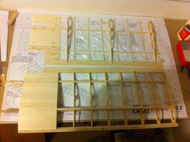

Done a little bit more to this.
Not to much left to do on the Port lower wing panel capping strips on top of the ribs, cut out the aileron, fit the wing tip and then some sanding!!
Made a start on the starboard lower wing panel

13 Nov 2012 03:06 #7 by Ex-Member
looks to be a good kit to build.
nice work dean.
might think about one when the back log is sorted.

13 Nov 2012 03:12 #8 by Dean M
I think the wood quality is fantastic.
It is a a good learning curve for me as there is no build instructions as such, just notes on the plans and some smaller sheets with notes on but no step by step instructions.
It seems a bit different, building the ribs on top of the centre section sheeting and lower capping strips.
13 Nov 2012 03:19 #9 by Quorneng
Replied by Quorneng on topic Re: Flair Pupeteer
Very neat Dean
I suppose done this way does ensure the bottom is flat (and stays that way!) as everything structural will be in place before the wing is lifted from the board.
Keep posting.
