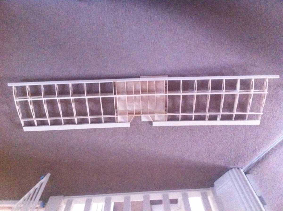

Done a little bit more to the lower wing, all the cap strips now fitted to the top of the ribs I have marked out where I need to cut the ailerons out :ohmy: hope I get this bit right, I have measured a few times and rechecked the plan so fingers crossed............... :pinch:
I have also started on the upper wing, only a small start, laid out the centre section sheeting, lower trailing edge and the lower cap strips.

Done a little bit more today, Cut out the ailerons :S
Just need to sand them and neaten them up a bit and then add the leading edge strip to them. The plan suggests using solartex as a hinge will give it a try!
Done some more to the upper wing to, ribs fitted upper main and rear spar fitted, dihedral brace epoxyed on and wing attachment blocks fitted.

Very neat work Dean - nicely executed but I'd have to warn against relying on the solartex hinges on a model this size. I'd suggest belt AND braces and fit proper hinges. The solartex will seal the gap but there is no way I'd rely on it for the hinge if it were my model.
On a model like this I'd use Dubro metal pin hinges or equivalent.

My Precision Aerobatics Ultimate had the aileron hingeds done from the same material the wings were covered in, it all came apart while flying, the two top ailerons came off togather which ripped the bottom one apart.
Managed to get it down, but PA would not accept any responcibility for it
SO i would never use a covering for hinges do like Grumps says.
Nice build Dean
Thanks: Dean M
  • Dean M
22 Feb 2013 15:20 #22 by Dean M
Replied by Dean M on topic Flair Pupeteer
Thanks for the advice chaps. Really appreciated. I will use some proper hinges now!!

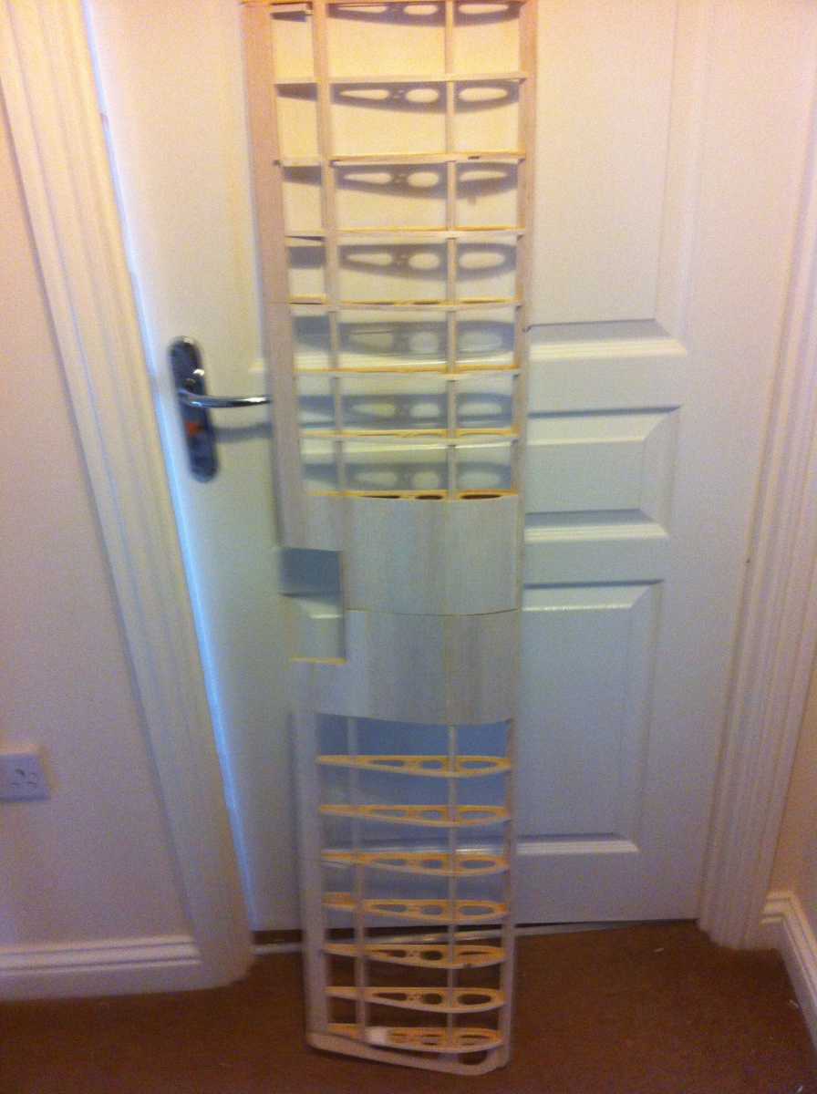

Upper left hand wing panel progressed ribs fitted leading and trailing edges fitted and dihedral braces fitted
and made a start on the upper right hand panel
Not sure whether I will start the fuselage or not, I haven't got an engine yet and no pennies to buy one so may wait until I have bought the engine before I start the fuselage.

Yeah been doing some building!!!!
Upper wing progressing nicely
And decided to make a start on the fuselage
