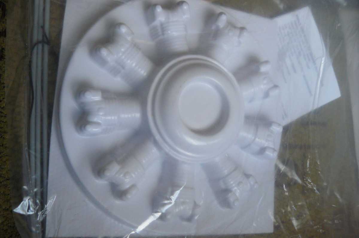

got the dummy radial for harvard today it a topflight 1/7, have gone to shop to get the rest of marking made.

Looks OK Sky - but i'm not using a dummy engine for the Wirraway - I now have an OS Sirius Radial to put up front. When the model was a Harvard/Texan I had an ASP 120 4 stroke up front behind a Williams Bros dummy engine. I had a bit of a problem at first with cooling but fixed it by making sure there was ample EXIT vent behind the cowl. The formula is to allow an exit volume at least 1.5 times the area of the inlet. I had to install some ducting to help keep the motor from cooking itself!

thanks grump yes if i was rich a nice radial would look good.

Those plastic engines don't have very much compression, though! :P

no they don't, good for hiding electric tho :) but i'm not going that way im putting a nice smelling thing in mine :evil: i just got to hide a bit of motor.

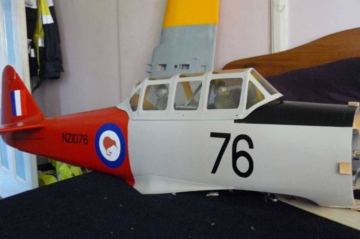

well got the markings today i can start to put the rest on body, one side done so far. then seal them on, then do work on wing

both side's done just to seal it now, then on to the wing

Funny having a long nosed c hicken on the side :whistle: [badass]

Don't worry Sky - these bloody imperialists wouldn't know a chicken from an egg - and they are not sophisticated enough to recognise important fauna like Kiwis or Kangaroos. :P :P :P :evil: :evil: :evil:
