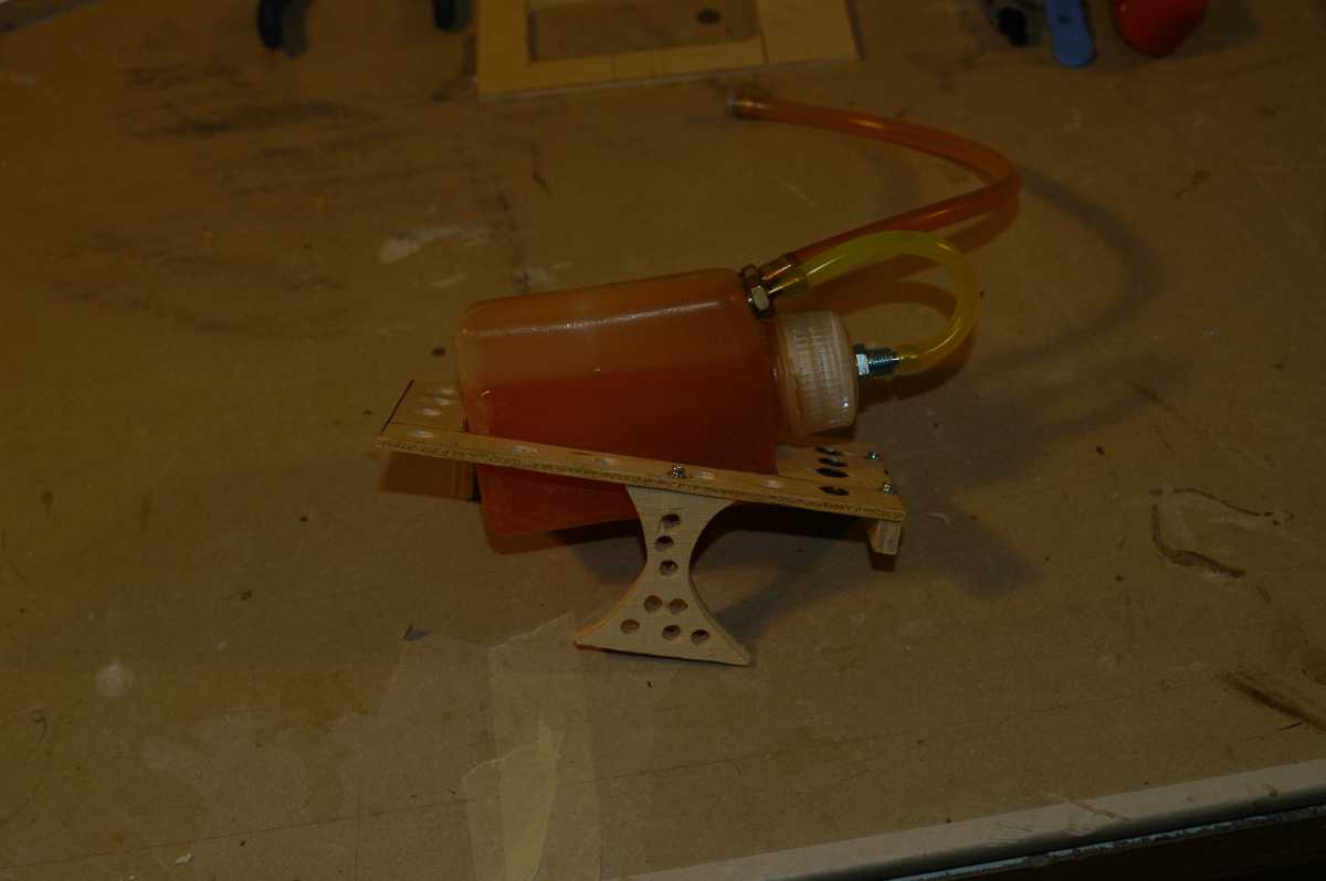

23 Feb 2013 05:07 #40 by THE BLACKBIRD
Replied by THE BLACKBIRD on topic The Cyprus SU 27 Flanker by Jet Legend
Need to fit two header tanks for the fuel lines, these are to clear the air from the pipe lines should any get in there, air getting through to the turbine would cause a flame out, the turbine would shut down
Desiding where to fit different pieces of equipment is prooving interesting, decided to fit these each side of the nose wheel so i can see them when the canopy is off
I made two brackets to hold them
If there are any Jet pilots out there any advice would be welcome, as im new to this

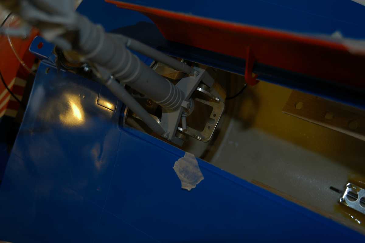

23 Feb 2013 05:18 - 23 Feb 2013 05:23 #41 by THE BLACKBIRD
Iv also found a problem, the nose wheel steering servo has a mounting bracket buiilt into the nose wheel mounting, but it is directly above the leg and the leg retracts forward
I cannot see how it can be conneted
The servo has to be connected to the two pins on either side of the leg, with the leg retracting foward then the servo will have to be in front of the mounting
I will have to make a bracket to place the servo to the front and connect it to the pins with a wire pull pull system, i think
Last edit: 23 Feb 2013 05:23 by THE BLACKBIRD.
Thanks: blue123, Sarah-Jane Smith
23 Feb 2013 05:32 #42 by Eric
Replied by Eric on topic The Cyprus SU 27 Flanker by Jet Legend
That seems feasible, BB, or you could put the servo behind, with a pushrod to a 180 bellcrank in front, then wires back to the leg. How do you intend to ensure that the wheel stays straight when the leg is retracted - to avoid jams?

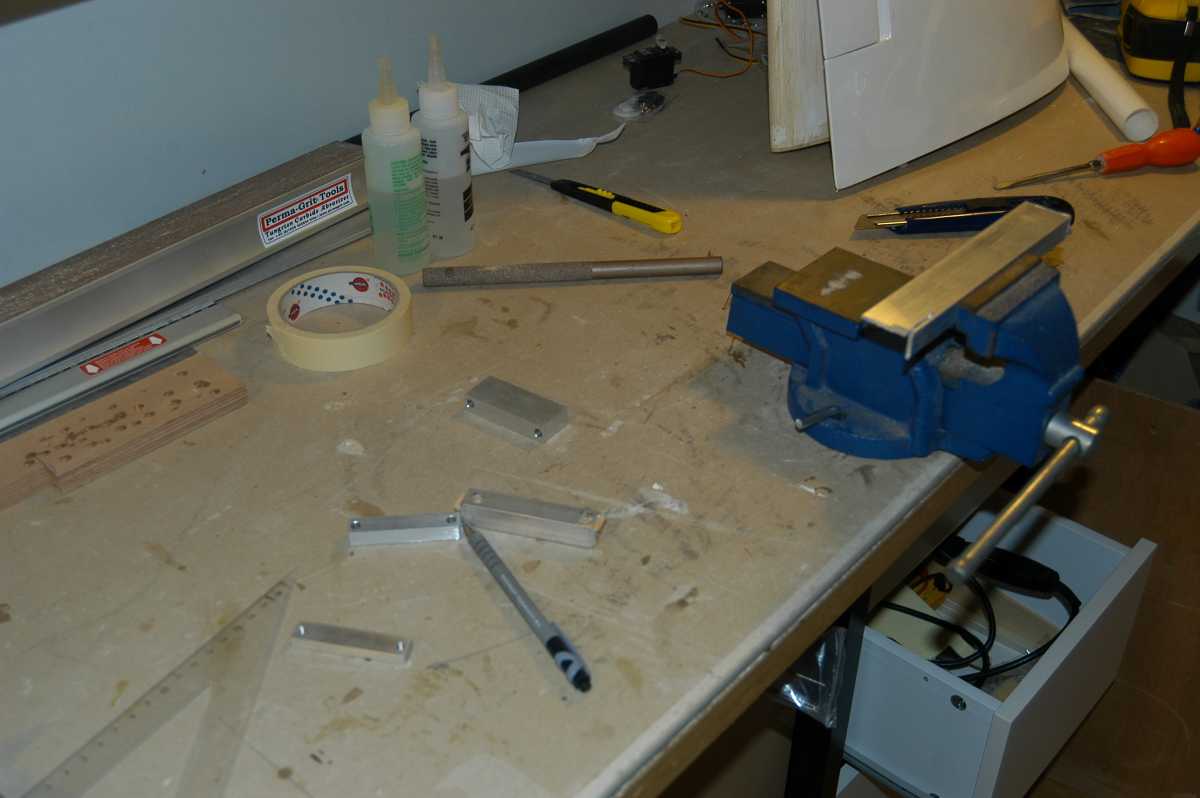

23 Feb 2013 14:29 #43 by THE BLACKBIRD
Iv made a bracket for the servo out of some ally angle
It will fit this way up and ill bolt it to the origanal servo bracket, this will place the servo well in front of the steering pins and i will connect with cable for a pull pull system
Had to lift it higher to clear the nose leg

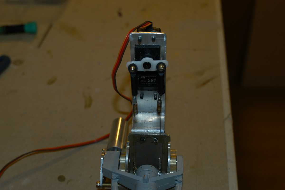

23 Feb 2013 14:36 #44 by THE BLACKBIRD
I think the nose will be ok because the air flow past it and the weightfrom the gaurd will be below when it is raised

26 Feb 2013 02:02 #45 by THE BLACKBIRD
Got the nose wheel steering working ok, had to make my own fittings could not get anything here
Everything tucks away when the gear retracts
