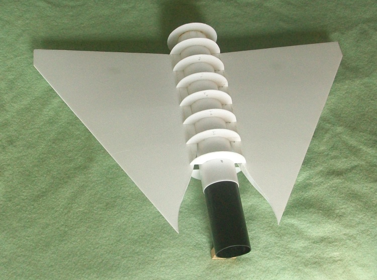

07 Aug 2013 15:48 - 07 Aug 2013 15:49 #17 by Quorneng
Replied by Quorneng on topic Fairey Delta 2
Old Fart
You may well be right!
I am sure it will flex a bit under g but as long as the wing does not twist positively to increase the aerodynamic load any minor distortion of the duct will have little impact on the EDF.
The RH wing with the inlet duct profile cut out and fixed to the duct.
Now I have just got to build the other wing exactly the same ;) and attach it. Then the top and bottom fuselage formers can go on. Each will be positioned in line with the wing shear webs.
Of course the full structural strength will only be achieved when the outer skin is applied.
The weak point is really the inlet ducts as they have a thin wall (and in mine the wall is even thinner to maximise the inlet area) so it provides very limited support to the first 1/3 of the delta. :ohmy:

08 Aug 2013 17:11 #18 by Quorneng
The second wing added along with the top and bottom fuselage formers.
So far so good and it is surprisingly rigid even without the outer fuselage skin.
It will remain on the mandrel until the internal shape of the inlet ducts has been established.
At some point soon I will have to build at least part of the nose section in order to complete the inlet duct. Those inlet compound curves are a pain to do!

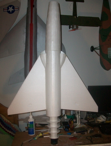

13 Aug 2013 20:13 - 13 Aug 2013 20:15 #29 by Quorneng
With the inlet ducts nearly finished a start can be made of the cockpit and nose section.
As it is fundamentally circular and symmetrical it can be built vertically in one piece.
After some thought I have decided to limit the length of nose, at least initially, as that scale 'spike' would be just too delicate. The nose will terminate 10" short with a simple (and robust) nose cone.
Hopefully once the flight characteristics have been sorted the natural nose high landing attitude should protect a full length nose but I bet it still gets broken more often than not!
Last edit: 13 Aug 2013 20:15 by Quorneng.
Thanks: Klipkopwildlife, Dean M, THE BLACKBIRD, blue123, Sarah-Jane Smith, old fart

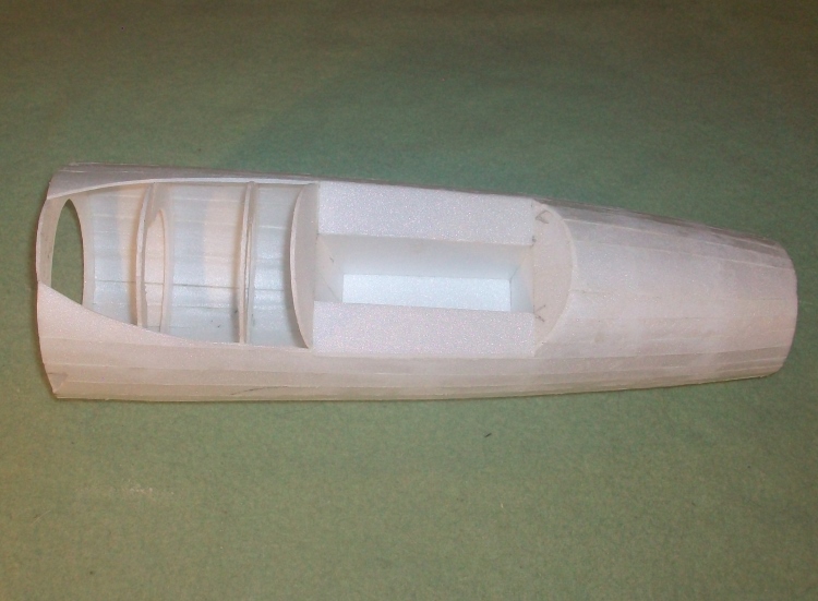

15 Aug 2013 00:09 #30 by Quorneng
The cockpit section complete as far as possible at the moment.
The battery goes under the cockpit and is sized for an 1800mAh 3s.
This is what it looks like with all the sections stacked on top of each other.
There is another 10" of nose to go on but will maiden without it.
So far all the Depron bits weigh 4.6oz.
Thanks: Klipkopwildlife, The Beard, Dean M, old fart, Ex-Member
