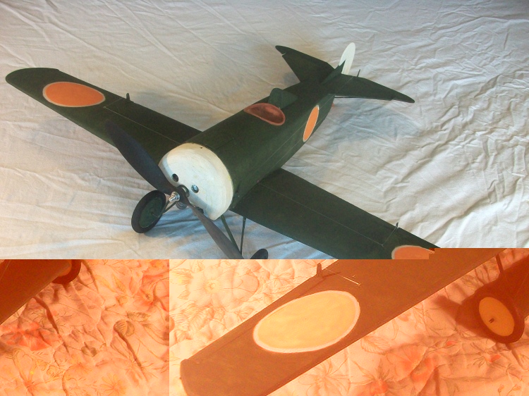

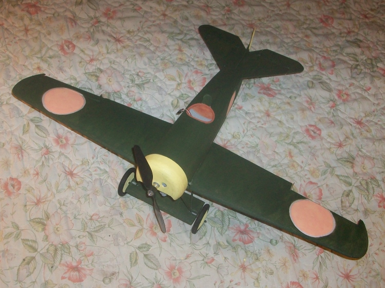

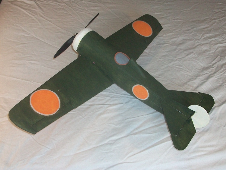

With the U/C in place the painting can get under way.
In hind sight dark green on white Depron was far from ideal. It still shows streaks after two coats. About the only saving grace is a crude streaky two colour finish was not unknown indeed Fokker used as a factory finish. It was so crude that it was one of the reasons why the 'aces' insisted on having their planes repainted in their own colours.
The orange in the Dutch markings has come out almost pink! :woohoo:

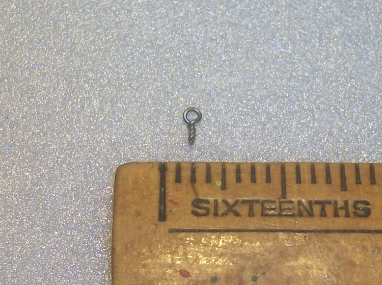

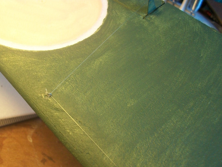

One of the 6 tiny eyelets that will be used to change the direction of the cable in the aileron/rudder pull/pull system.
By comparison the elevator pull/pull is simple and direct.
Nearly there!

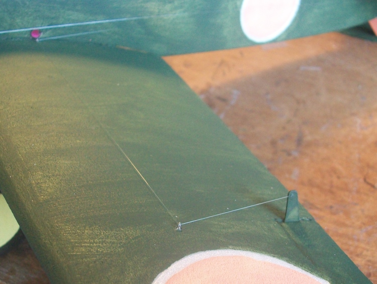

Part of the aileron closed loop circuit.
The line from the aileron passes through the tube to the other side of the fuselage before turning back to the rudder.
The underside line goes directly to the servo arm under the centre of the wing.
By comparison the elevator loop is simple and direct.
The whole ensemble driven by a servo tester.

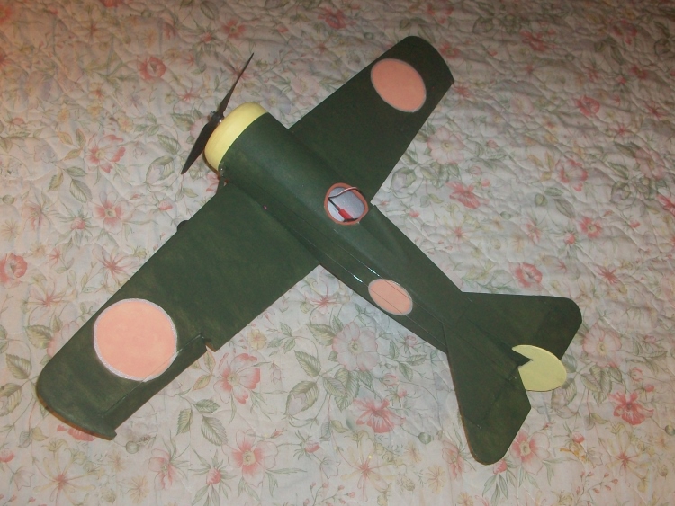

07 Oct 2013 19:15 #25 by Quorneng
Replied by Quorneng on topic A monoplane fighter ahead of its time?

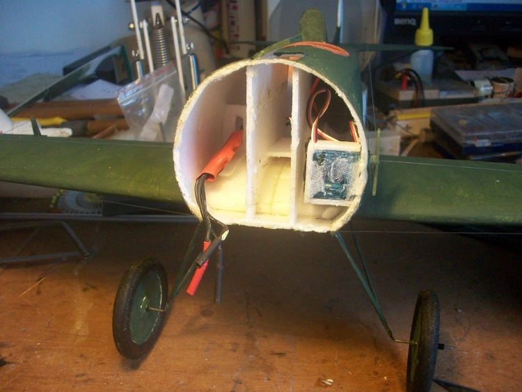

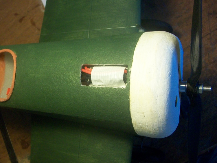

As I feared moving the radio made little difference so there is only the battery left!
At the present it is right up against the firewall but long wise on placing its CofG 1" back.
By mounting the battery 'vertically' its CofG will be 1/2" back.and as it represents 25% of the all up weight it should make a difference.
The CofG of the plane is now close to 25%
The battery connection is still made from within the cockpit.
When some suitably calm weather arrives I will try it like this before building a proper hatch.

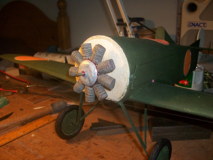

The Fokker has flown quite a bit but the repeated nose over landing on the long wet grass have taken their toll.
First the rotary 'let go' on a full power test. (the paper cylinders don't like getting wet!). Only one cylinder broke free but being dragged round inside the cowl dislodged them all and the prop wash 'distributed' them all over the room! Not too difficult to build another.
Second the firewall (Its Depron) slowly got weakened and became rather too flexible resulting in serious motor vibration at critical revs.
You can hear it in this mornings video and towards the end it got noticeably worse so the flight was terminated before the whole nose got torn away.

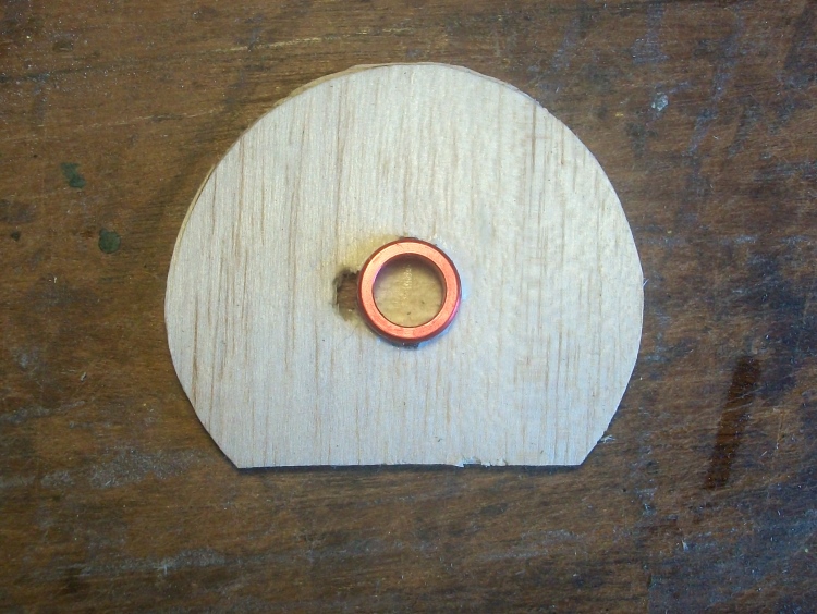

The solution is to remove the old firewall
and replace it with a balsa version.
It is made up of 4 plies of 1mm balsa with the motor mount sandwiched between layers 1 and 3.
Attachment Balsa4Ply.JPG not found
Just got to put it all back together. :P

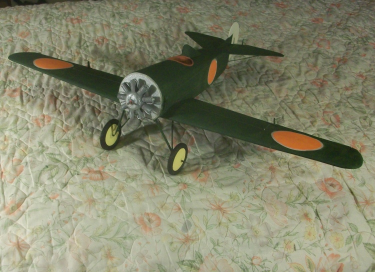

A new rotary.
The cylinders are now solid Depron and are not only glued to the bell but also together so it can be run safely at full speed even without a prop.
All put back together.
Just need some suitable weather.
Thanks: Klipkopwildlife, blue123, Sarah-Jane Smith, old fart
