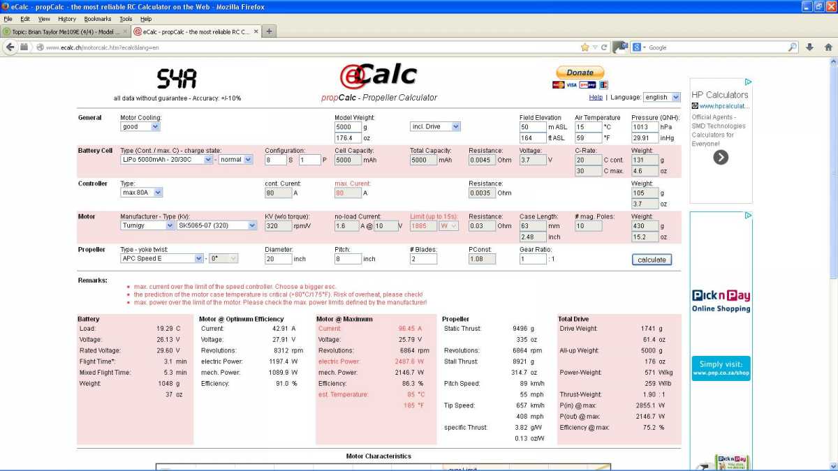

Sorry about the wait guys, I'm moving house! Looking at Solos figures I see he prefers 3S connected in series to give 6S (this would be my route for cheapness) But I tried this
The speed is reasonable (55mph) and the tip speed is good (400+mph)
Just look at the static thrust! It's a stump puller! Of course we'll have to change to a 100A ESC
Using 6S our current just goes through the roof. I'm going to suggest to Solo that we use a mix and match of what we already have.

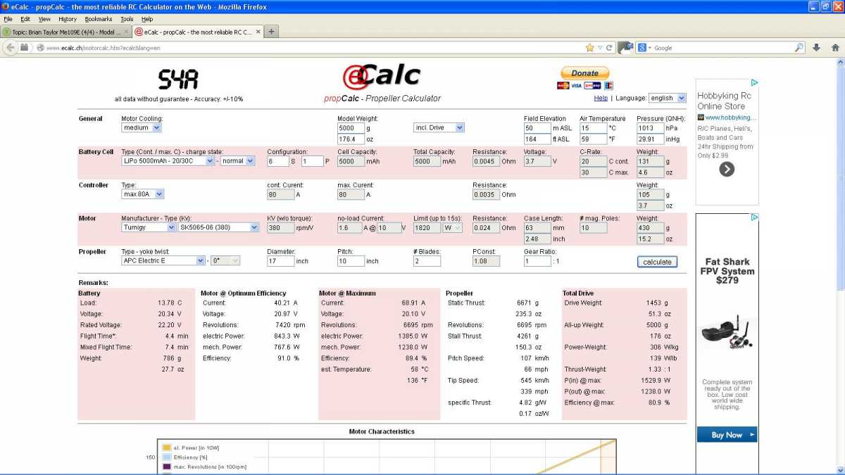

How about this?
Using just a motor change to up the Kv we have good speed, good power, excellent acceleration and better efficiency, and, let's face it, who's going to notice that the prop is slightly under size? If you're doing this for competition, do what the scale guys do, put the right size on for judging and then change on the way to the flight line!
