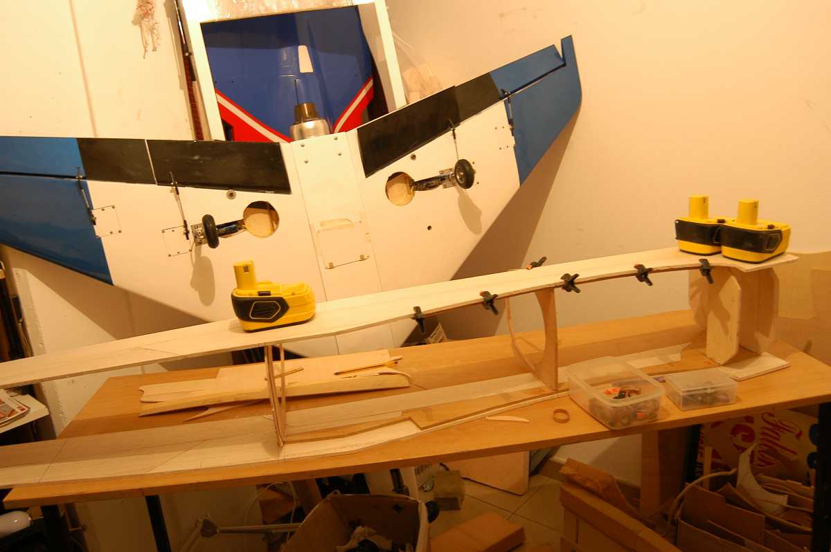

Seeing as the sun went in and it rained the other day i thought winter had come, so i started a new winter build, as there is no point in finnishing the big A10 Thunderbolt for two turbines as i only have one now
SO i have blown up by 75%the free plan that was in the RCM&E the TN Spitfire, it comes out at 126" wingspan so a little bigger the a 1/4 scale
Im doing it electric as i have already bought the motor last year BUT im makeing provision for converting to petrol power if need be, thought about a Zenoah 62 with a Mick reeves torque reducer

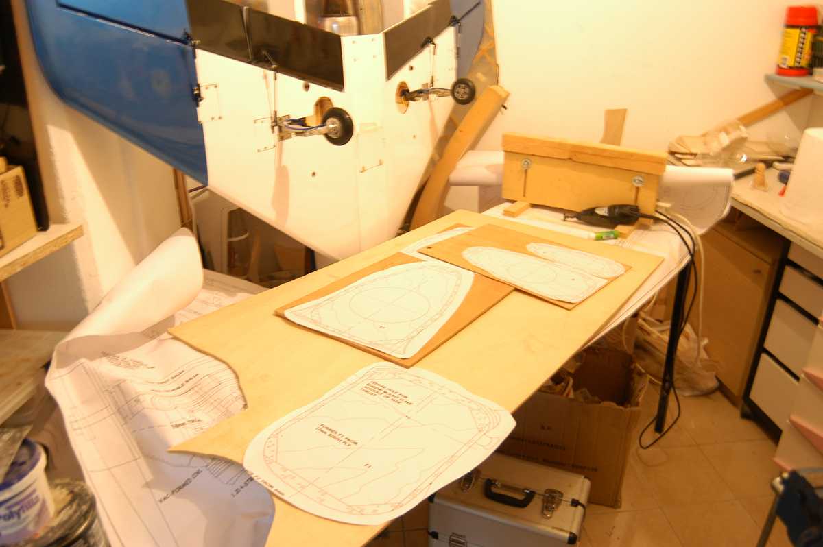

Trying to build from the stock under the bench so i made the fire wall from two laminates of 6mm birch ply and the rest from 6mm ply from the local building site :) :) :)
As you can see i lost my building room in the house and now have to make do in a 8'x 8' cupboard downstairs, also in there are three jets the SU27, the HUNTER and the NAVY CAT so its a little crowded to say the least

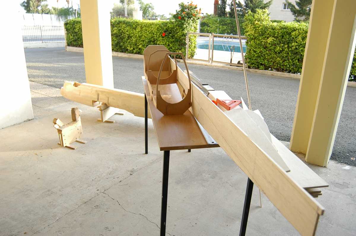

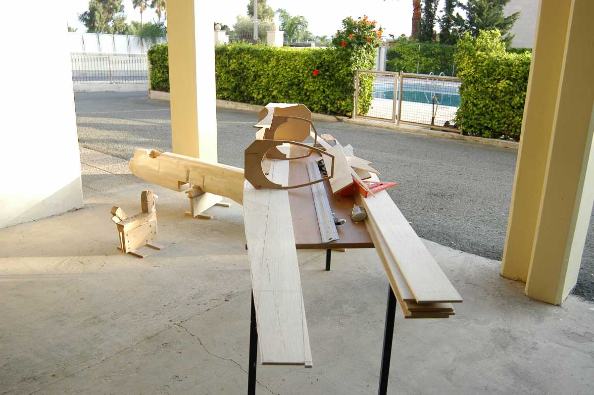

Got some more done, cut out the formers, the 6mm balsa fuselage sidea and the 6mm ply fuselage strengtheners
And started to assemble it

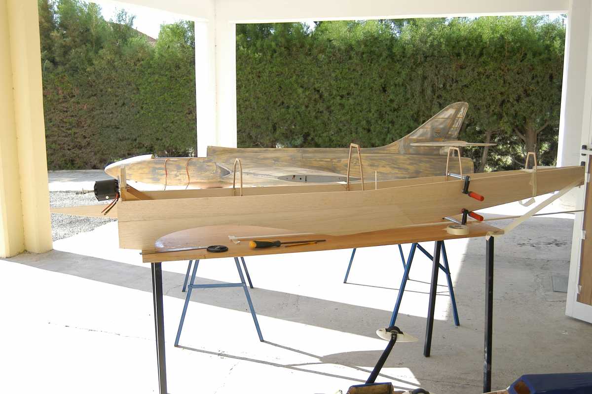

Got a little more done, cut out the motor mount / lipo box, started to sheet the fuselage and started the fin, on the plan the fin is solid balsa, as this is quite large i built it up
And god it's only 14 deg today Brrrrrrrrrrrrrrrrrrrrrrrrrrrrrrrrrrrrrrrrrrrrrrrrrrrrrrrrrrrrrrrrrrrrrrrrrrrrrr
