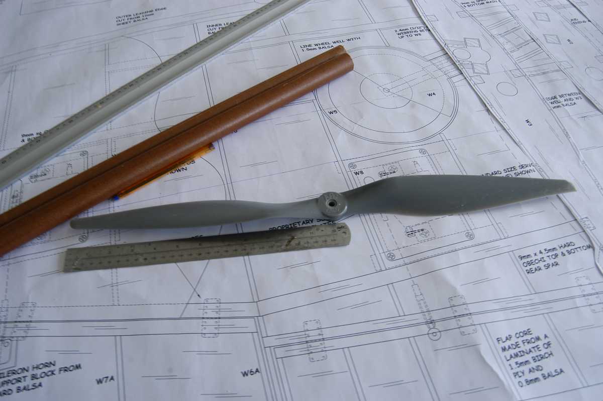

Had this prop turrn up this morning for the Spitfire 24x12 E so i can get it all rigged upon the bench and see what she will do

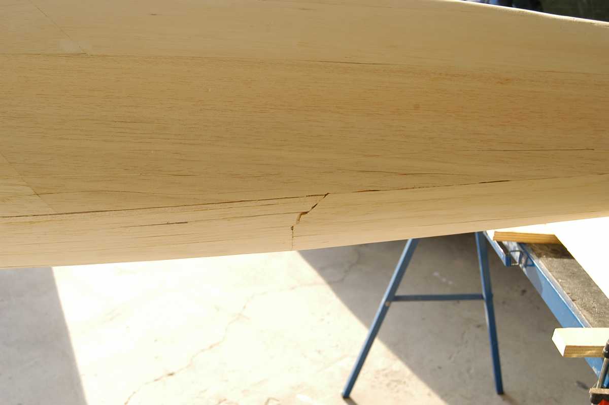

My luck is still with me ( the bad luck that is ) the wind got up and blew the fuselage of the outside bench and snapped the nose and fin off :( :(

There is quite a lot of damage to the fuselage with cracks in a lot of places

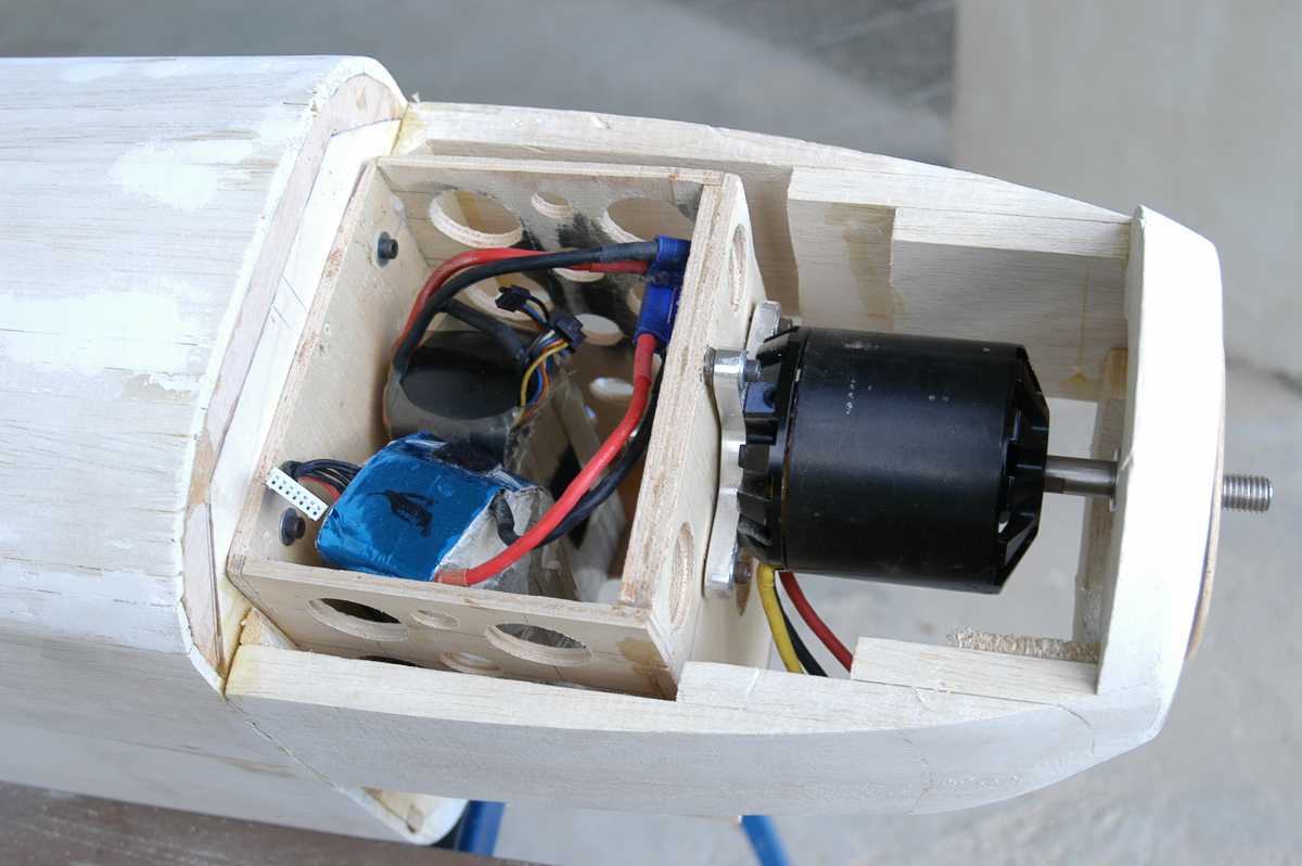

I fit the motor and lipo box
