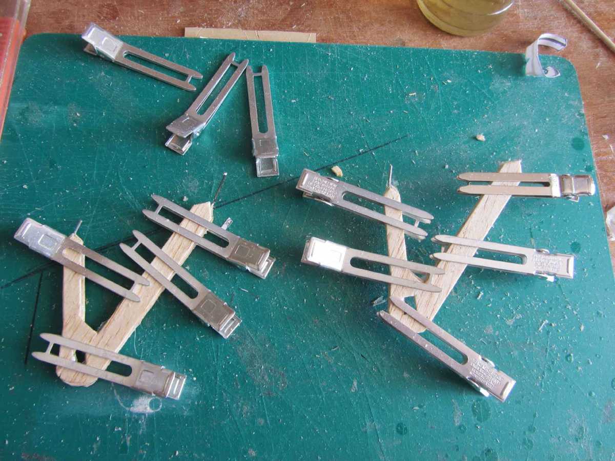

That glide looks pretty good to me Sarah, well done! You really do need to find an indoor site now don't you!
A thought. Rather than pinning the tail on while waiting for the glue to dry, have you thought of using hair clips. My sister's a hairdresser and supplied me with these:
I'm sure you must have some lying around doing nothing somewhere......

I use all kinds of things to hold small parts together while glues 'go off', from paper-clips, to wooden clothes pegs, old tired-out bulldog clips, and the purpose-made spring clamps. The thing to watch out for is that the 'hold' isn't so strong that it bruises the wood. That creates a weak spot.

Andy Sephton wrote: That glide looks pretty good to me Sarah, well done! You really do need to find an indoor site now don't you!
Ah yes, have seen them unfortunately I have none- in my hair clips get tangled, lost and found 10 years later!! :lol:
