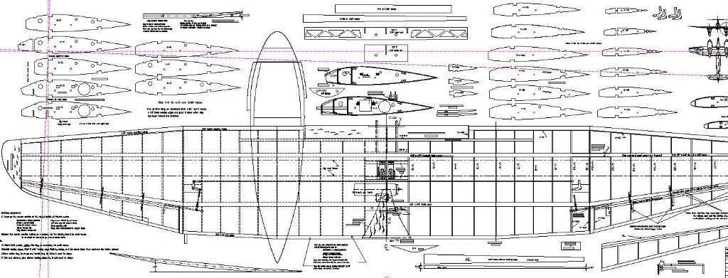

Quorneng, thanks for your input, all are most welcome, yes you are correct, I am not discounting the battery weights, as you say they can be shifted around, my goal is to try an keep the rear as light as possible, so as to avoid adding ballast keeping the model light as I can :S :whistle:
What I am finding out with this plan, is that some of the fuz formers do not align with each other, keeping the shape of the fuz true, some are out as much as 5mm and others :angry: :angry: could not be used at all (2 off ), I would say that due to multiply reprinting they have gone out of wack, oh well, that's what one gets for building obscure models

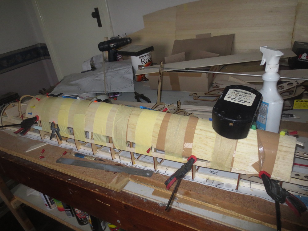

26 Jul 2014 07:09 - 03 Aug 2014 03:11 #17 by chookman
Replied by chookman on topic Dornier 335
I got busy today sheeting one upper side of the fuz, pinned and glued the sheet of 3/32 to the upper spine, waited to dry, ( hair dryer)then wet down with "cloudy ammonia" and taped down, hair dryer again then glued down as there is a contour in the shape, tapping down and securing the sheet was a pain,I had to weigh down Ft and back of the centre spars to stop the twisting effect, the other option was to plank it all, but as I have gone with sheeting, I will stay with that

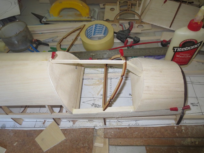

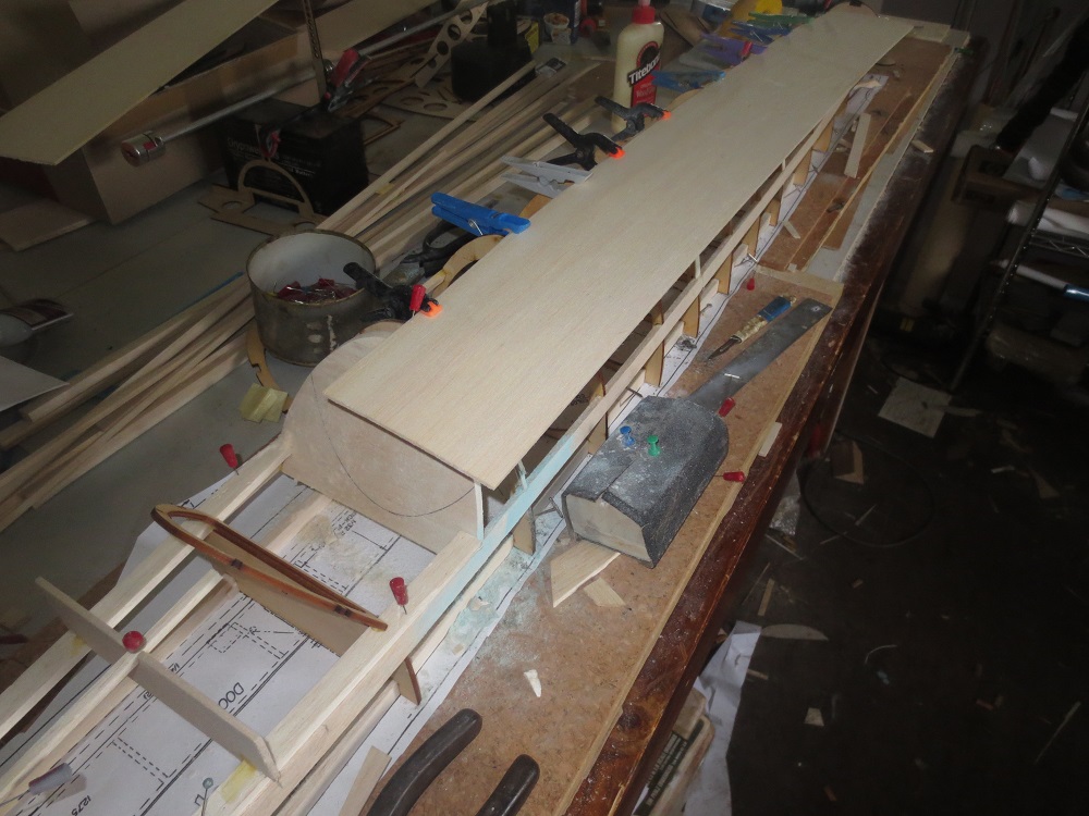

03 Aug 2014 13:02 - 08 Aug 2014 20:12 #18 by chookman
More progress today, cockpit /access hatch planked and roughly sanded.
The plan shows 2 hatches on the forward fuz, 1 behind the F1 (firewall) and the other is the cockpit , why???? te forward one for a fuel tank, yep that figures, why the cockpit one ??? and no strength at all behind F1... ????? so as it will be EP powered, the forward one now is part of thefuz, not removable.......makes more sense to me

03 Aug 2014 13:04 - 04 Aug 2014 13:30 #19 by chookman
I had to check on which pic was which

03 Aug 2014 13:45 #21 by chookman
Thanks Tony, I still can not understand the reason behind the aera behind F1 being removable, if ya got a thumping 60 /90 I.C. engine hanging on to the firewall, why there is no reinforcement behind it, the top half of the fuz is only constructed on 2 lengths of 1/2 x 3/8 balsa longerons :S.
Still at least F1 will now have some support
Till next time :)

08 Aug 2014 17:47 - 08 Aug 2014 20:09 #22 by chookman
Unpining the fuz from the board brought a disapointment, :woohoo: to find that the Fuz sprung up on each end, totaling almost 1/2", tried wetting again and weights ....nup ..almost tore the sheeting off and starting again, 1 last thought was to cut the lower an middle longerons and weighing down in the middle, well that worked. whew :whistle: with the base longeron now straight, the ply doublers and lower frames could be added
