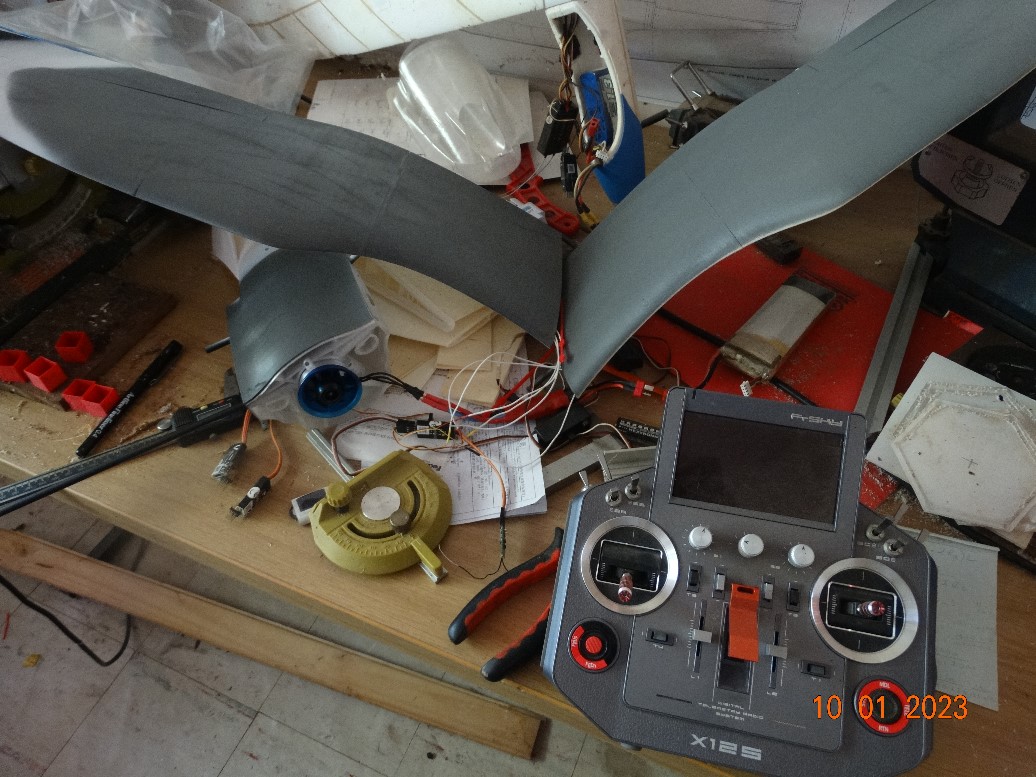

My knees have recovered but 2 weeks on my hip is still bad, I can't bend, but it is improving. I have managed to do a bit to the Seagull, programming is an issue, Elevon rudder mix is okay, Elevon differential and direction is okay for left and right but I can't get the Elevons to reverse, up is down and down is up.
I've been using 'Flying wing' as the type, this morning I'll try 'Delta'

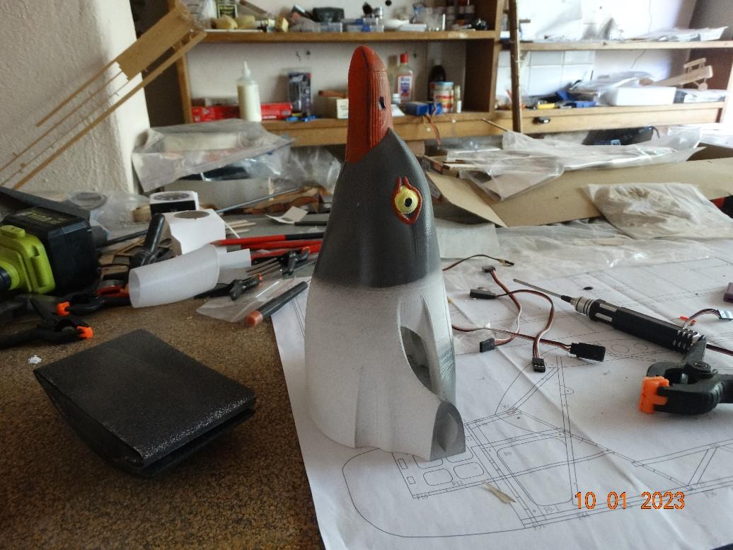

I've been doing some painting as well.

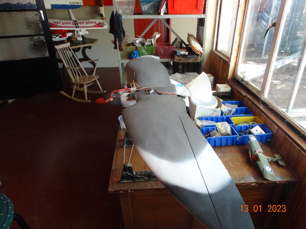

Well, I've managed to do a bit, weighed the flight ready frame without a battery, 452.4gms. The recommended flight weight is 560gms which leaves me 107.6gms. A 2s is recommended, I have 2 but they're 202gms each and don't fit! I do have a 3s 1,300mah at 107gms. While 2s is recommended I'm going to go with the 3s, that's what the throttle is for!
The 3s battery is not quite (5mm) all the way in the nose.

I've been setting up control throws and differential, all fine until I came to Throttle mix, I don't like throttle mix, the main problem is that zero mix + deflection is at throttle centre, which can give some strange effects at closed or fully open. I then spent several days failing to get any kind of mix until I realised that I should be mixing to aileron, not elevator! Duh. Mixing to Ail and Ail2 does the trick, 2mm up at closed and 2mm down at WoT.
My next problem is that I get different, tiny, amounts of deflection as I open and close the throttle which will give small amounts of turn, not nice, more later.
