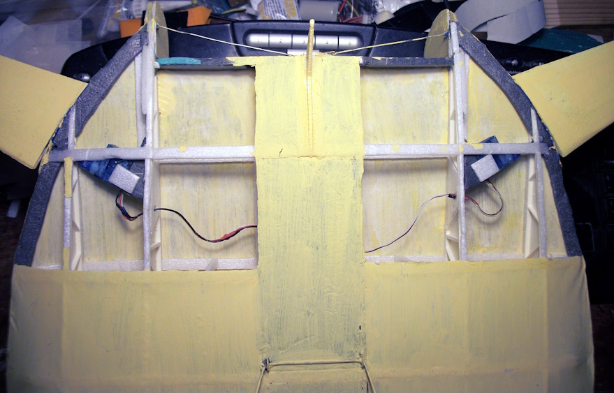

The outboard servo installed with the tail planes fitted.

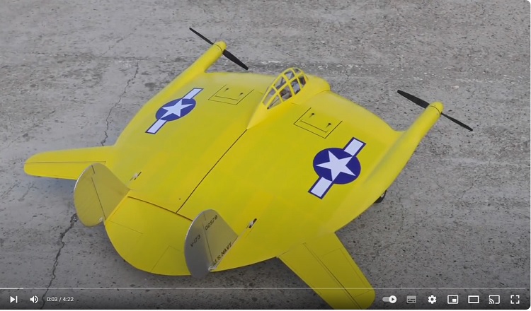

There are a couple of videos of model RC V173 flying and although they appear to have rear elevators it is not possible to determine if it is used or are just relying on the tail planes as elevons.
I also note that the models although fitted with scale  "show" 3 blade props actually fly with much smaller ones suggesting they are not really using the aerodynamic principles that Zimmerman proposed but are flying at a speed where the tail planes are in a more conventional airflow.
We shall see what happens when full diameter props are used.

The "no elevator" conversion is complete.
It is in effect a tissue covered extension of the existing body so it will rely on solely on the elevons for pitch and roll control.
The other aspect that I have mentioned is the flying RC versions use much small props.
I suspect it is flying as a very low aspect ratio wing rather than demonstrating any effect of the prop wash countering the big wing tip losses.
This very detailed XF5U has even smaller props!
Both fly well enough but likely due to the power of electrics rather any aerodynamic efficiency.
