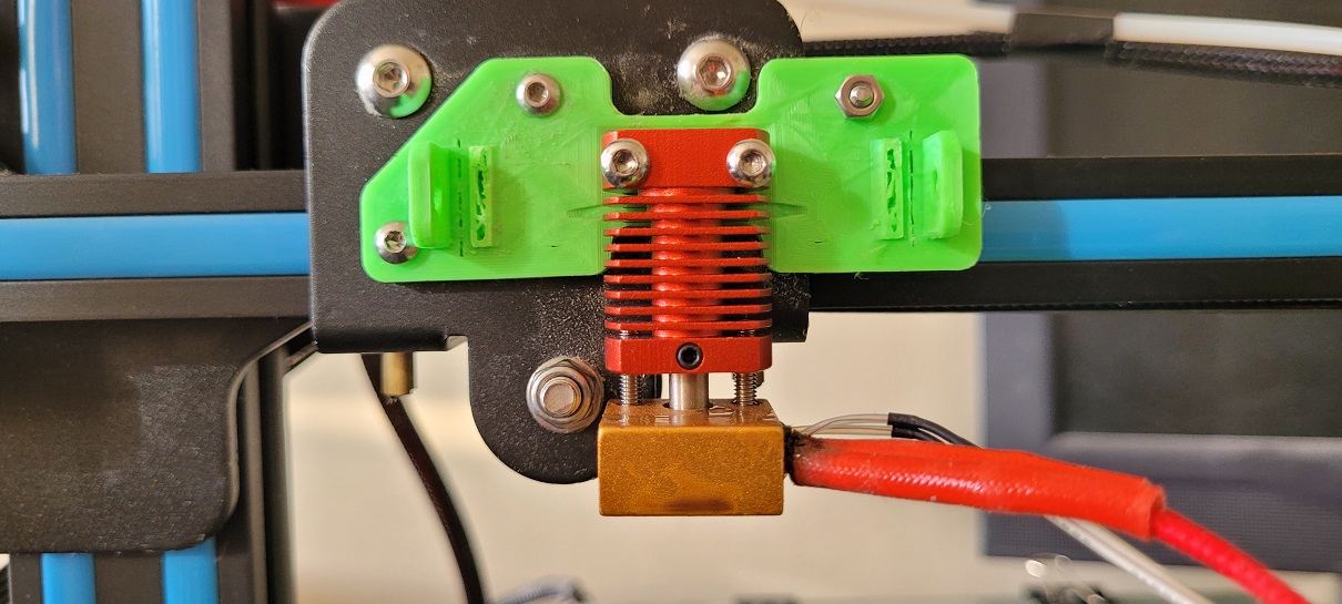

13 Jan 2023 10:26 - 13 Jan 2023 10:26 #112 by Ralpharr2001
Replied by Ralpharr2001 on topic Anet A6 3D printer
I seem to be copying your tails of woe Klippy. My hot end failed on my Creality CR10. So bought new thermistor and heater cartridge. Fitted them, no difference. So bought a complete new hot end which worked fine for about an hour then clogged up just above the heater block. Keeps doing it now so completely lost on a fix. Any ideas  before I open the window and conduct a maiden test flight with the printer??

Hi Ralph, clogging above the heater block would appear to indicate it's a bit too hot there, the filament is melting before it gets to the block, is the cooling fan blowing hard enough? Or do you not have enough clearance between the block and the carrier. A picture would be nice.
13 Jan 2023 12:49 #116 by Ralpharr2001
The head is set up as per the original. The only thing I can think of is heat creep. But everything is as per the original head. I can only think this is a cheap copy so doesn't have the correct tolerances.

13 Jan 2023 14:56 #117 by Ralpharr2001
I think I may have found the issue Klippy. Explaining to you in the forum triggered a thought. Just doing a test print now. I dont think the bowden tube feeding the filament was going into the hot head far enough. I did some measuring and found it 6 mm short of the nozzle. Which correlates to the size of the blockage I was getting. I thinned the wall of the bowden tube so it goes all the way down to the nozzle. The test print will tell me if i've fixed it. Fingers crossed.
13 Jan 2023 17:16 #118 by Ralpharr2001
Well 2 hours into a print and all is going well. So that confirms my theory.
