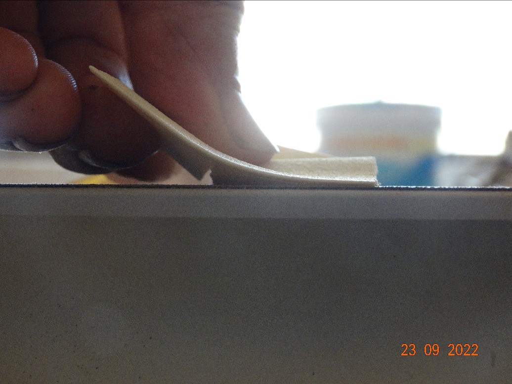

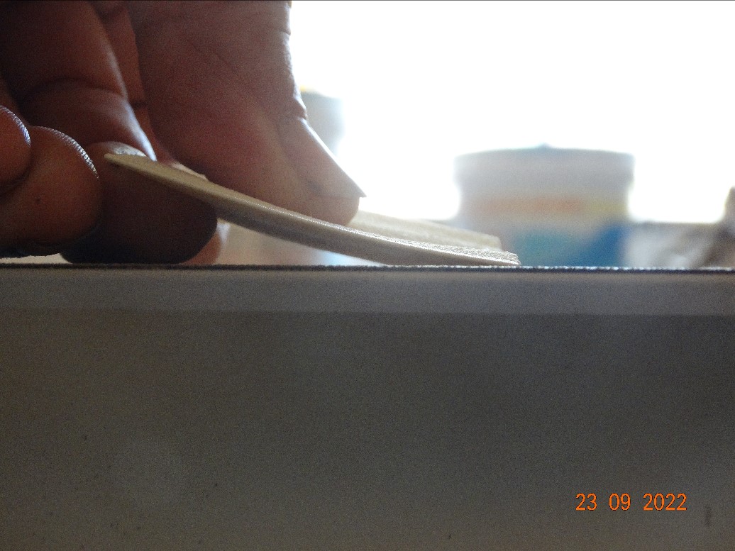

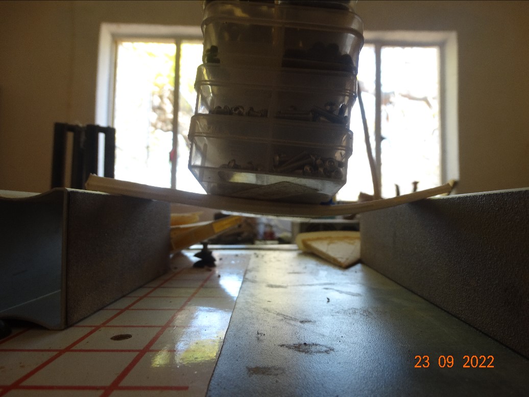

The LW-PLA remains flexible as long as you don't print at too high a temperature.
The above is scrap as it was printed at 250oC
Broke on the layering underneath.
This test of a scrap aileron, 165mm between supports, 670gm load. When the load was removed the component immediately returned to its original shape.
Tricky to use, yes. But I am now at a stage where I level the bed first thing and I can print the whole day in LW-PLA, as long as I follow my self made rules.

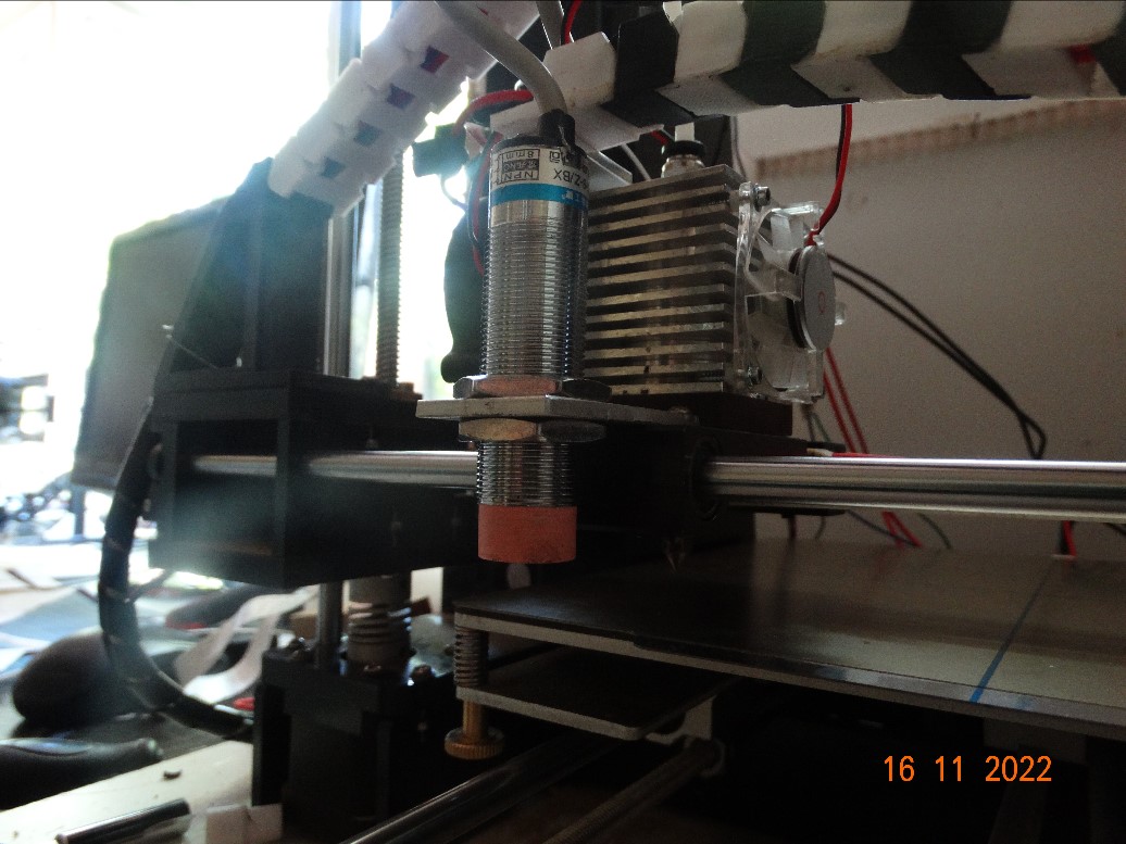

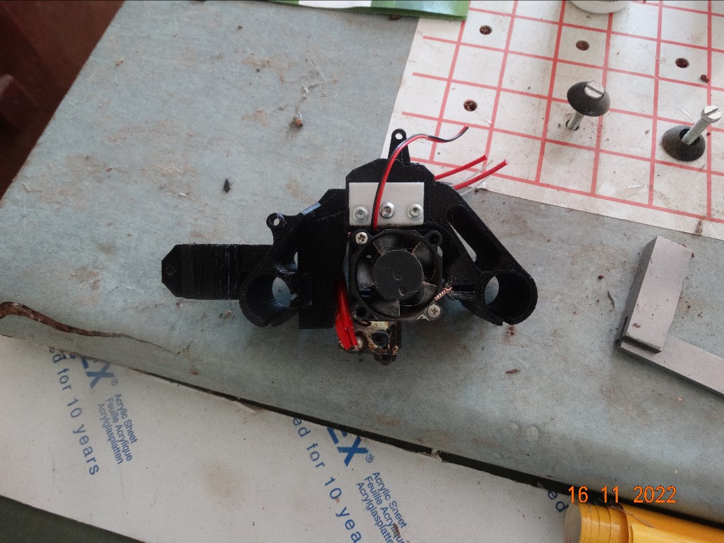

After a long chat with Jon last night I realise that what I have written may have off putting to some people thinking of using LW-PLA. This should not be the case, LW-PLA is great stuff, as Simon found it's easy to use in an un-modified printer. My problem have really all been self inflicted. I fitted a v6 hot end plus a Bowden cable feeder which, on the standard X carriage would have reduced my available Z height by about 30mm. I therefore printed a new one (Thingyverse to the rescue)
A great deal of trouble is taken to stop heat getting to the support (the v6 hangs from its cold end). This is done with a close fitting fan, with an end temperature of 240oC the cold end is at 42.8oC.
If I get a power cut (frequent) the UPS kicks in for a while, but, when it stops, everything stops and the heat in the hot end travels straight up the cooling tower to melt the PLA carriage. Any filament in the system also melts, and in the case of LW-PLA, foams and forms an immovable plug in the system, hence, full rebuild.
I have now made a new hot end using the original carriage but have yet to test it.
Marlin have changed the way their Configuration files work in Visual Studio and I have yet to generate a usable Firmware file.

The layout of my A8 carriage is a bit different to your A6 so I too will also have to explore Thingyverse to find out how the 'tall' V6 head can be accommodated particularly as the A8 max print height is only 240 mm rather than the now standard 250 mm.
I have set my nozzle to 210 C which does rather limit the degree of foaming possible but I suspect it also avoids many of the nozzle blocking problems.
So far for me printing in LW-PLA has created no functional issues at all other than finding the best print parameters like layer width, height and flow rate which are rather (very!) different to normal PLA.
