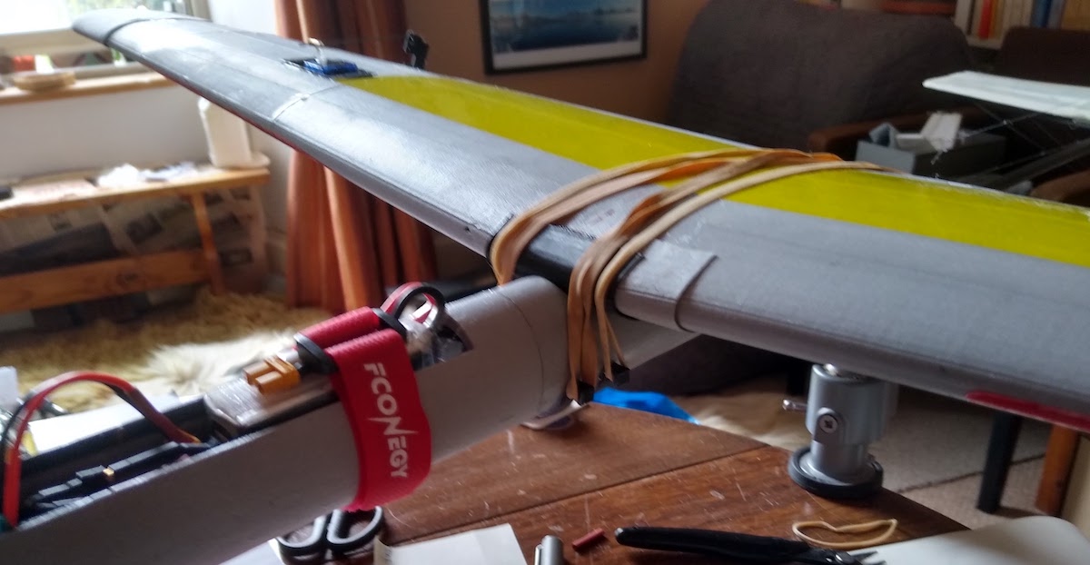

I setup the dragonfly3 with the electrics. Mostly works. The wing is sitting nicely. There is no aft stress on the boom. The Rx within the main cavity is a bit tight as the servo leads are right-angle. If I can get one of Tony's Rx to link there will be more space.  I had adjusted the fuse width so that it would take an 850mAhr and that does just fit - I needed to shift it back and I strapped it (at least for initial flights). There was space in front of the battery for the ESC.  I had to add ~3g to the tail for COG (a small bolt and some washers). I could potentially shorten the nose or try tapering it a bit if ESC as the front proves to be workable.
It is calms outside but Brenda thinks it is more important to sort the fridge before our trip.....

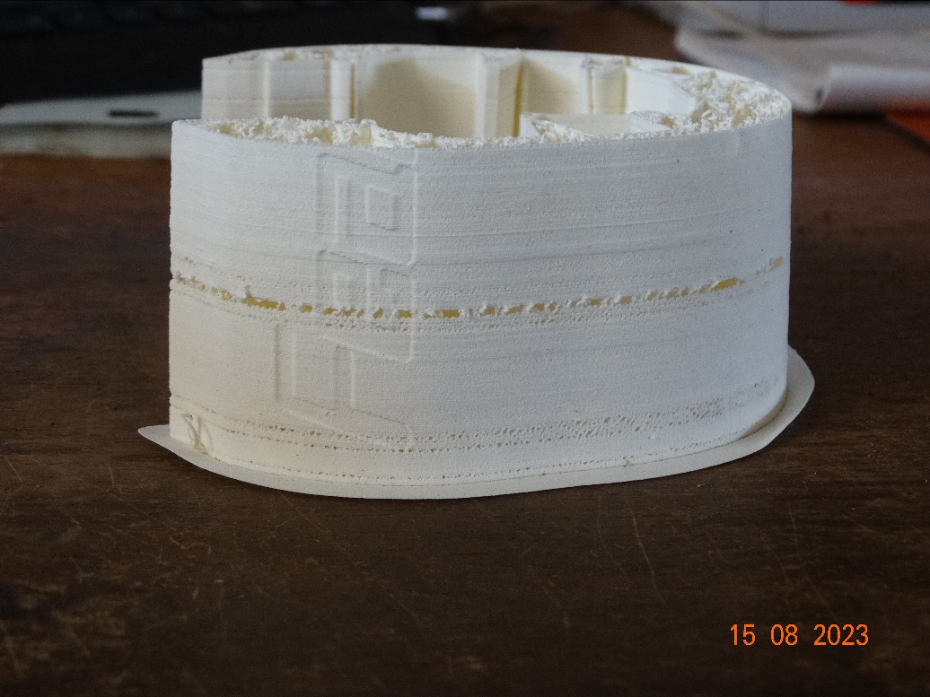

Now here's something I don't understand, after weeks of good prints, this happens
Then these 2 elevators, the bottom one has a gap
I took it off the plate, made NO changes and printed the upper one, Any ideas?

15 Aug 2023 18:09 #25 by Quorneng
Replied by Quorneng on topic Printing with Light Weight PLA
Klippy
I have recently come across the same sort of thing.
The only thing I could detect as different was the 'in room' air temperature and humidity which in the last 10 days has changed daily from 45 to 60% and 21 to 25 C.
In my case I suspect there is an area of the print that is marginal and the wrong humidity or temperature causes the bead to temporarily not stick properly.
It is of course only a theory.

15 Aug 2023 18:54 #26 by jon.in.swansea
Replied by jon.in.swansea on topic Printing with Light Weight PLA
So for a half dozen layers you got minimal feed.  First thoughts:
a) did conditions in the room change for 10 minutes or so?
b) 100mm of slightly off filament?
c) did the extruder grind the filament and then pick itself back up?
  • jon.in.swansea
15 Aug 2023 19:43 #27 by jon.in.swansea
Another thought - if there is a bit too much friction in the filament path that can lead to the gear biting into the filament s it is doing retractions.  I found that upping the temperature by a degree or two gets the flow a bit more 'fluid'.  Perhaps less chance of the biting.
Of course if you watch it you will not see it until you leave the room.....
16 Aug 2023 08:38 #28 by Klipkopwildlife
Replied by Klipkopwildlife on topic Printing with Light Weight PLA
Thanks guys, it occurs to me that I may not have had the cabinet closed up for those failed prints but I can't be sure. Upping the print temperature discolours the component. What I did notice was that when I pulled filament off the spool, at times I felt a resistance, almost like the filament was sticking to the next layer. This spool is about 3/4 finished.
