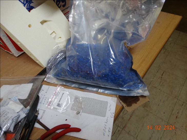

14 Feb 2024 09:12 #36
Replied by Klipkopwildlife on topic Printing with Light Weight PLA
