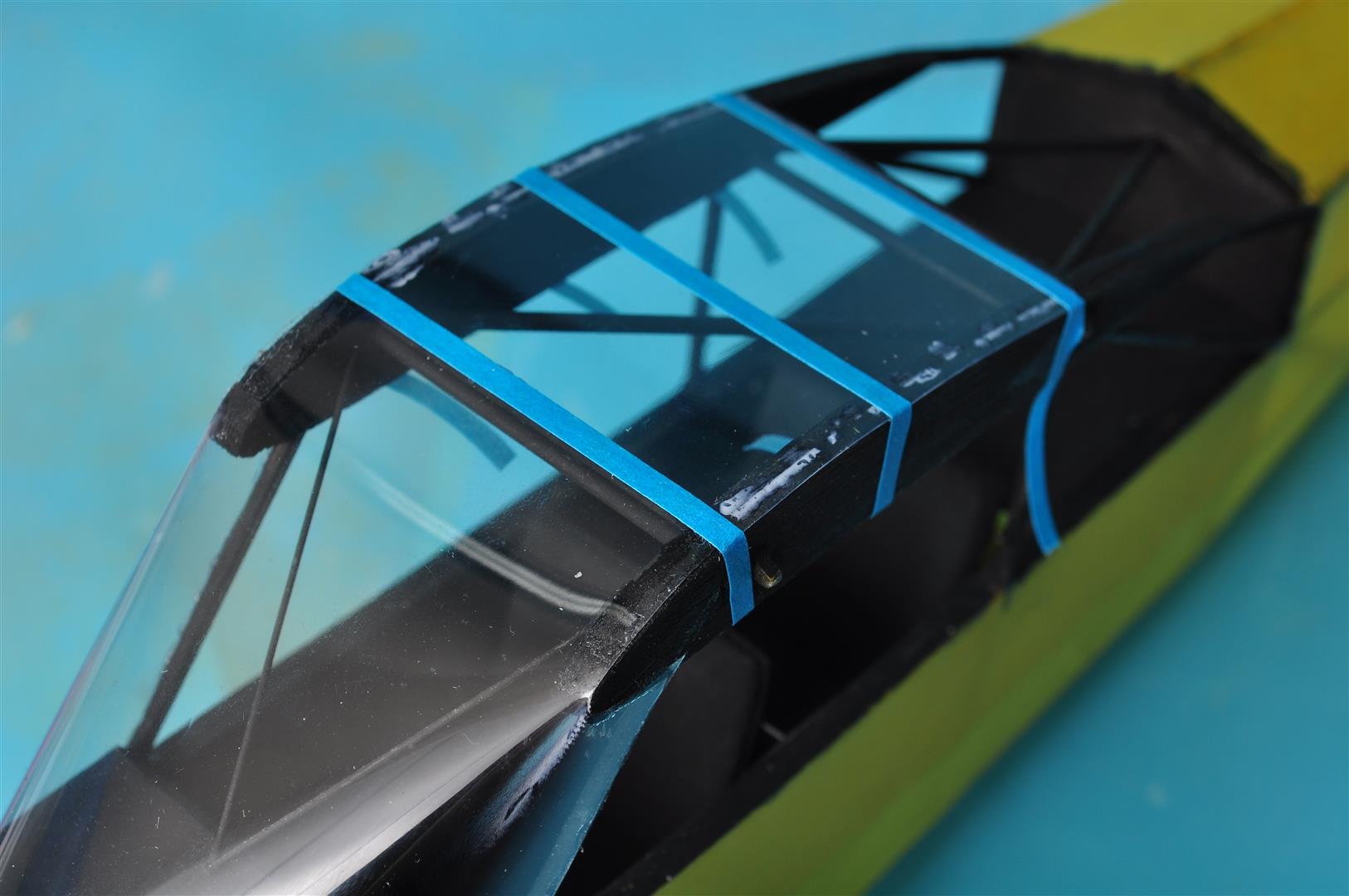

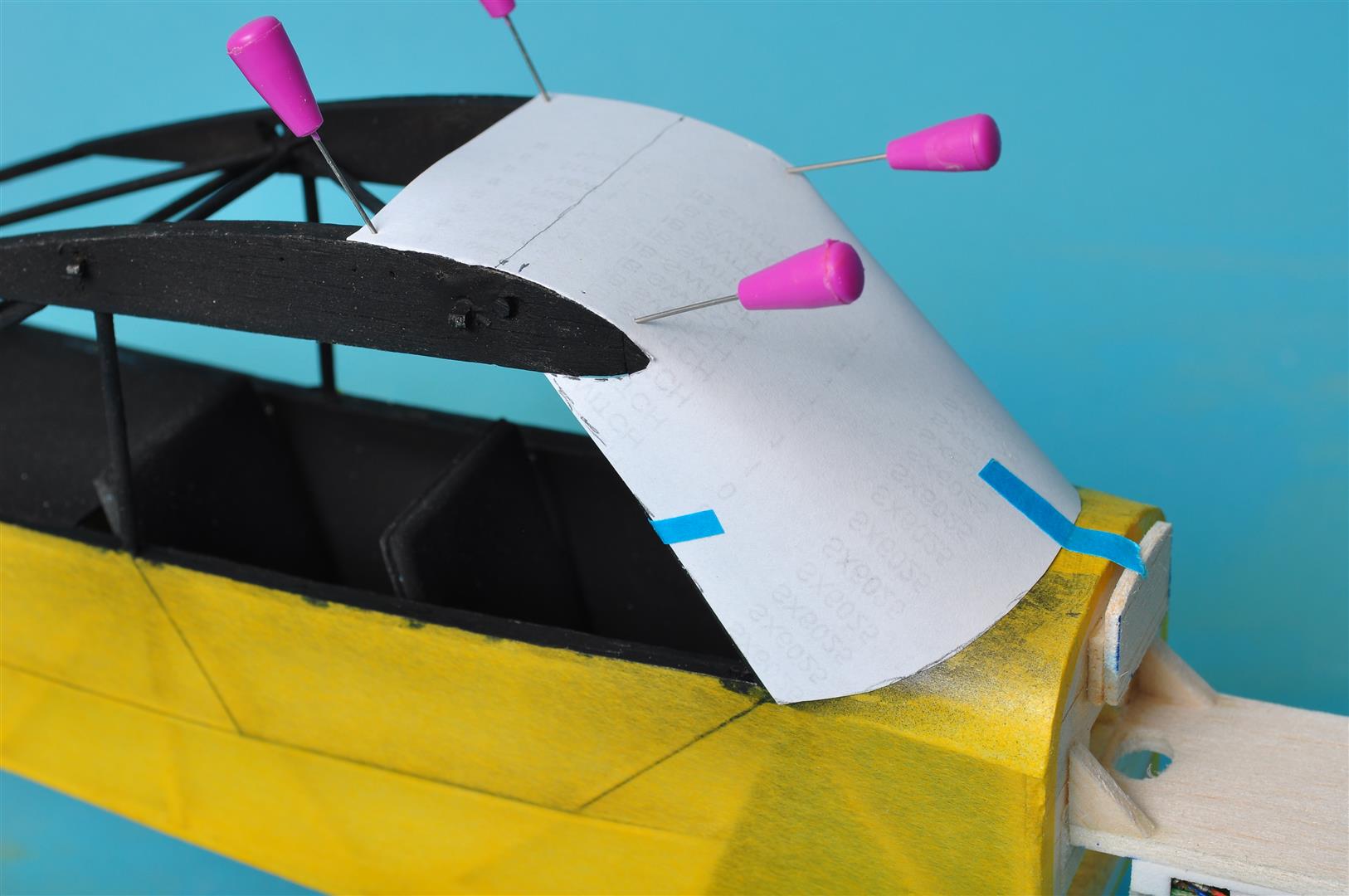

well I am not sure whose idea it was to do a Cub, that front windscreen is a bit of a mare....
thought I would start by wasting paper, then move on to wasting acetate ;)
tap - tap.......rivet

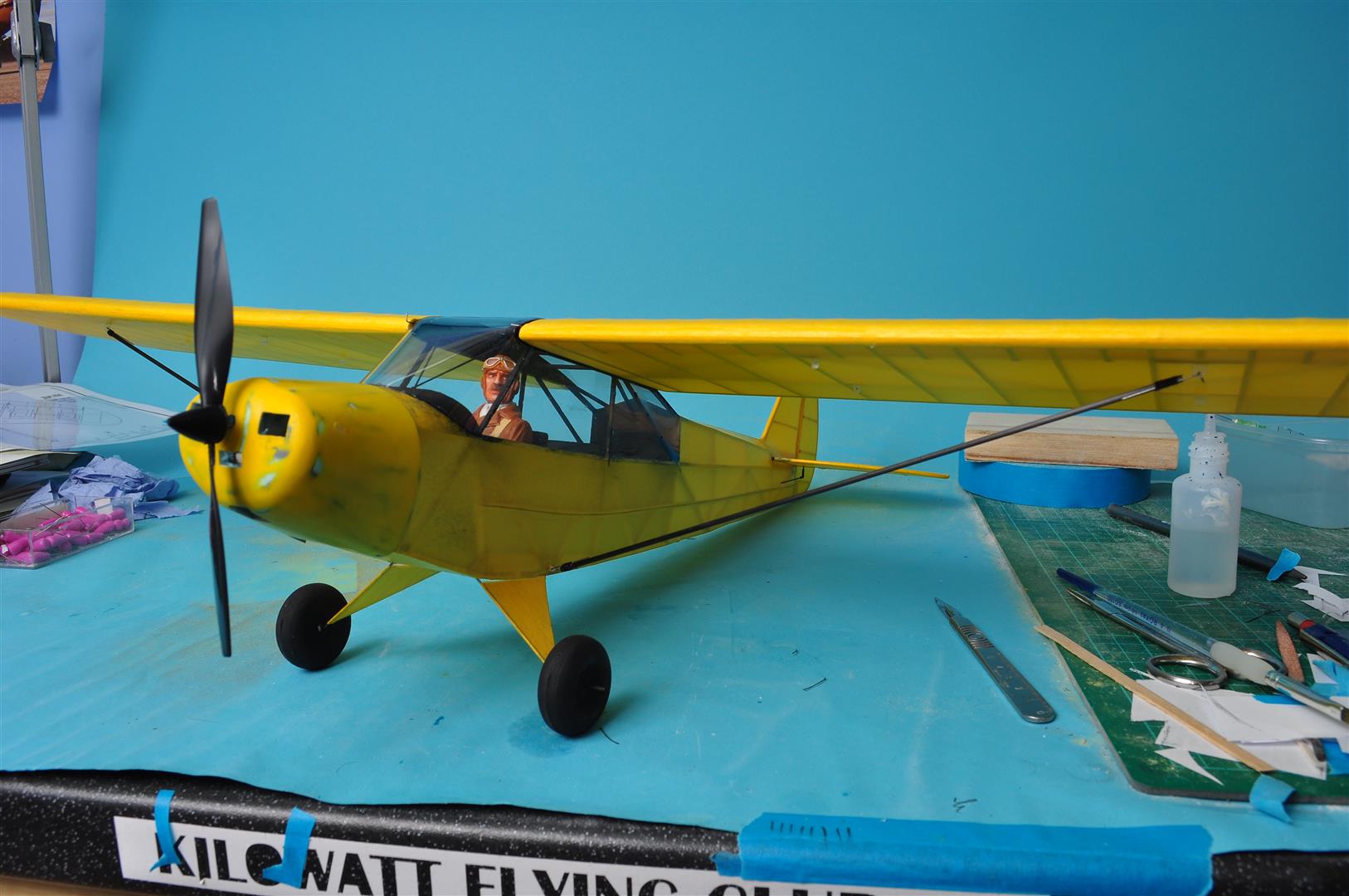

Septic wrote: However you should be able to spot the error..... I should have cut treads in the tyres before adding the alloy tub axles..... oh well maybe the judges wont notice :whistle:
It's OK Danny, that's why they call them air plain tyres! :ohmy:
I'm loving this build, I have many happy memories as a tuggie in a Super Cub.

19 Oct 2016 20:25 - 19 Oct 2016 20:26 #184 by Septic
Glad you are enjoying the build, so am I. I learn something new at evry turn and it will all stand me in good stead for my next bigger RC Scale model I am sure.
Still motoring on with the canopy glazing, going okay but I dont like to do more than one section at a time, then let it dry. So it is slow going.
So no more until this dries....

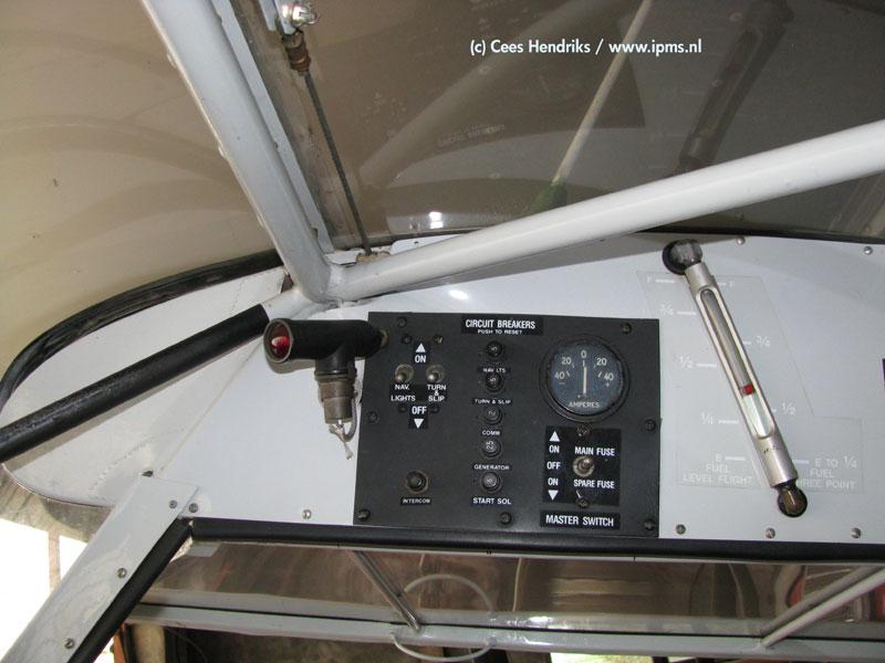

It may be too late, but the Cub had sight glasses for the fuel tanks on the inside of the wing roots, easy to paint on and no weight penalty! The glass had a little red ball that floated up and down but disappeared when the tank was full,.........or empty! We lost a tug and a pilot like that, :( Lycomings don't run too well on fresh air!

I did try for ages to think of how I could replicate those glass tubes, the best i could come up was melting some clear plastic sprig from a plastic model, and stretching it to the required thickness, but in the end I felt it was more trouble than it was worth. There are also some tubes that enter the cockpit through the rear bulkhead, not sure what they do, but they are also prominent. I also failed miserably to come up with a way to replicate them too.

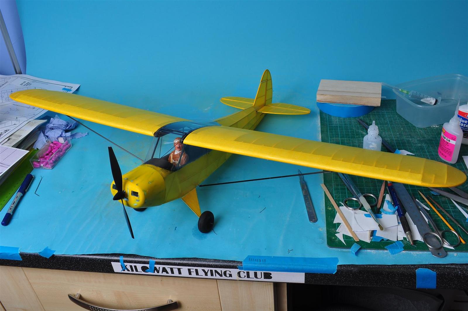

The main focus at the moment is to get the model flayable for saturday afternoon. If it doesn't fly then all this may be moot.
The struts are carbon with adjustable ends, so I can increase decrease the dihedral a bit. The parkzone Cub I have is almost scale with regards dihedral, so I am hoping to get away with something close to scale.
Oh I know it is not important apart from the wing loading limit. My target weight was less that 140g
My all up weight, (minus paint) is now 62g Quite pleased with that [badass]

Pipes in the rear bulkhead? Not sure, there's nothing there unless it's the lead ins for the flying wires. The release for the tow cable also goes through there.
  • Septic
22 Oct 2016 00:10 #193 by Septic
On G-BBYB just the pipes come through the rear bulkhead. On this Cub there is a cylinder back there with feed pipes.....
Here are the glass tubes mentioned in an earlier post. No electrics in G-BBYB so none of the other gubbins was present in G-BBYB.

22 Oct 2016 08:09 #194 by Klipkopwildlife
Replied by Klipkopwildlife on topic PA-18 Super Cub for the BMFA R/C Scale Indoor Nats
Hmm, no comment on the cylinder, unless the aircraft had some kind of 'rate of climb' gizmo. Maybe even electronic? Jeez, I've been out of a cockpit for far too long.
22 Oct 2016 12:22 #195 by Eric
Looking at that mystery cylinder, it appears to be some owner-fitted add-on, because the U brackets aren't squared up. Also, as there is a clearly visible seam along it, I'd suggest that the outer skin was just padding or insulation.
Two pipes in, one out, (or v/v), rubber hose, and jubilee's suggest fairly low pressure fluids.
Either the rear bulkhead had been freshly painted when this pic was taken, or the item was very rarely removed for inspection/servicing, because there is no disturbed paintwork on the brackets or cover.
What it was for - - - ??
It can't be a rudimentary cabin heater, as the Cub engine is air-cooled, and you wouldn't pad or insulate a radiator! :S
