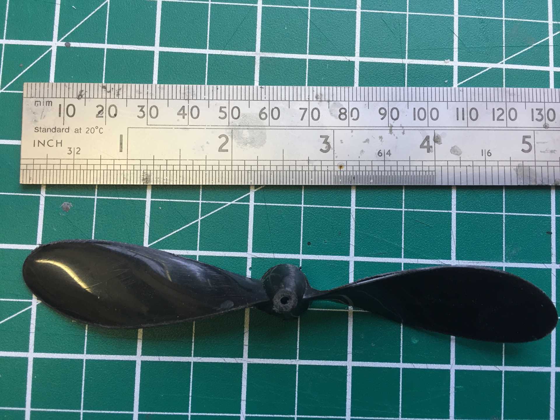

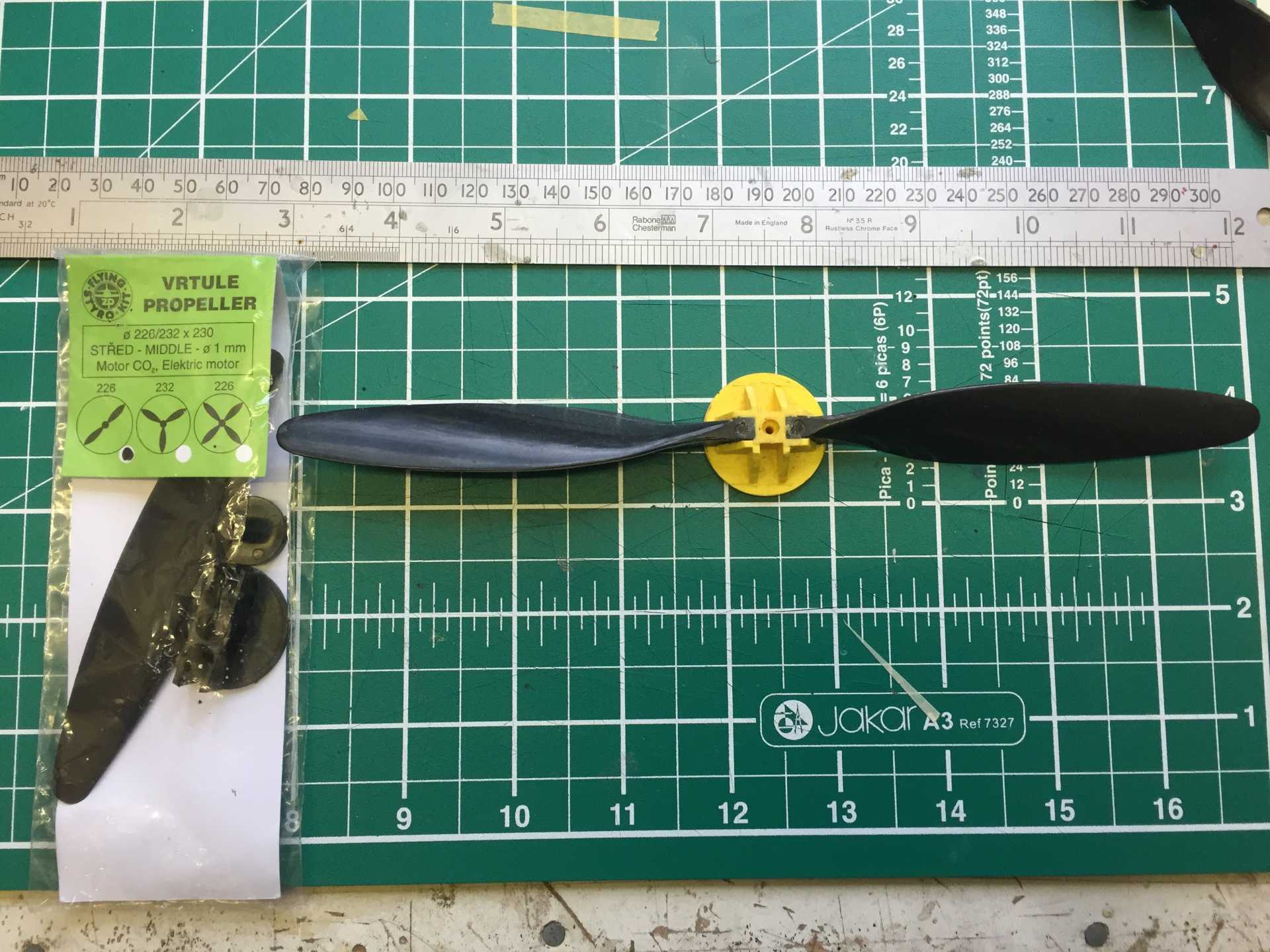

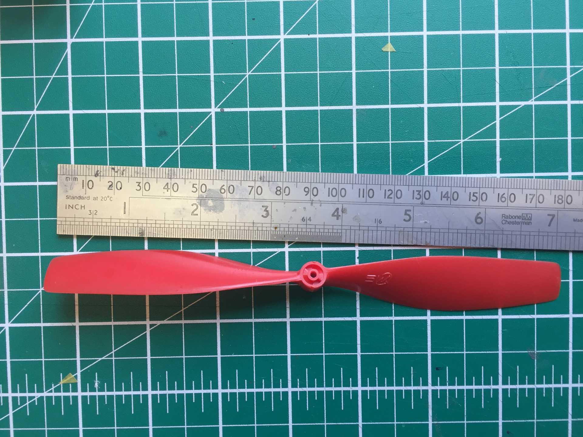

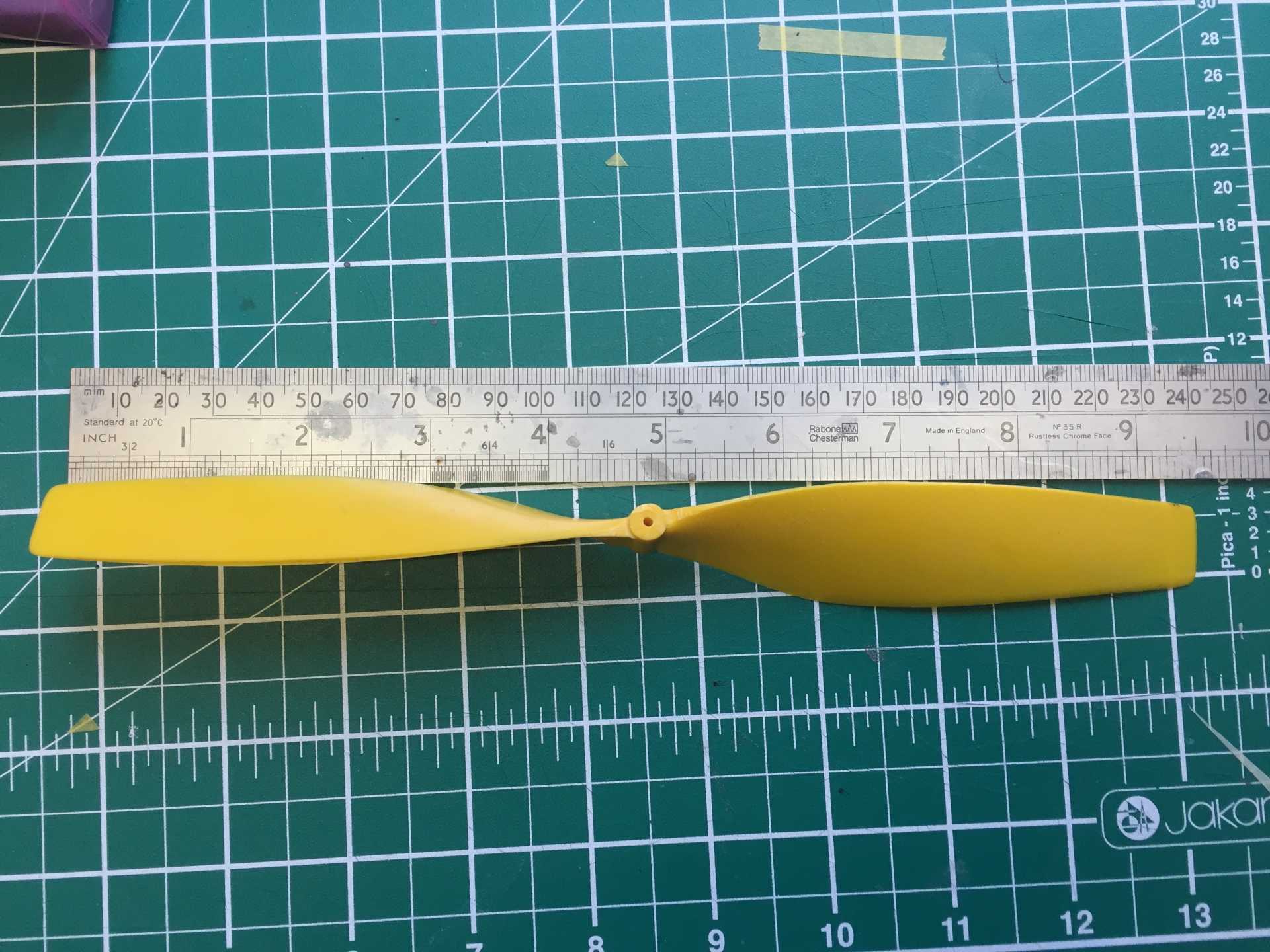

On the subject of props for CO2 I have been using these 7" props from Flitehook on my GM 300 and they work well.
I thought they were Modella props but the moulded logo says SW.
I was using the much larger 9 1/2 " plastic rubber props from Flitehook but I found on 30" vintage models the prop was so big that where it stopped would effect the glide path. I nearly lost a model in a wheat field at Middle Wallop thanks to that.. and I'd set the D/T. They work with the bigger engines and bigger models but you need to carve the freewheel moulding off.
SAMS used to do a prop kit that came with loose blades and a hub , you can make them as 2 , 3 ,4 bladed units with the different hubs. They work well too. I'm sure Kevin will correct me if they don't do them anymore
For the smaller Telco sized engines, as well as the Telco prop, I've used the KK rubber prop that used to come in the kit again with the rubber drive bit chopped off.
