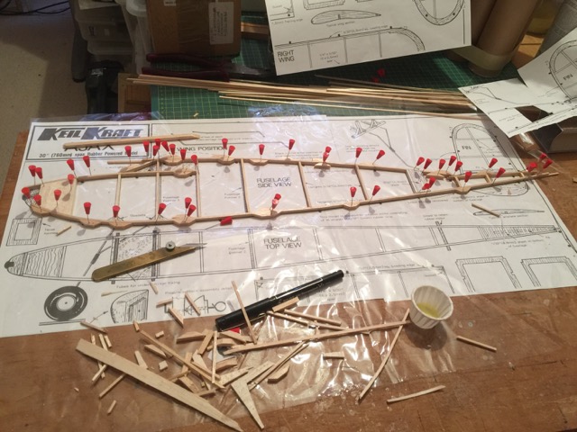

Construction started this morning with steaming of the longerons:
....and continued with the construction of one fuselage side. I use twice thickness blocks to jig the fuselage and cut pieces for both sides as I am building one of them so that I can build the second side over the first and hold both to the plan with further jig pieces pinned over the blocks.

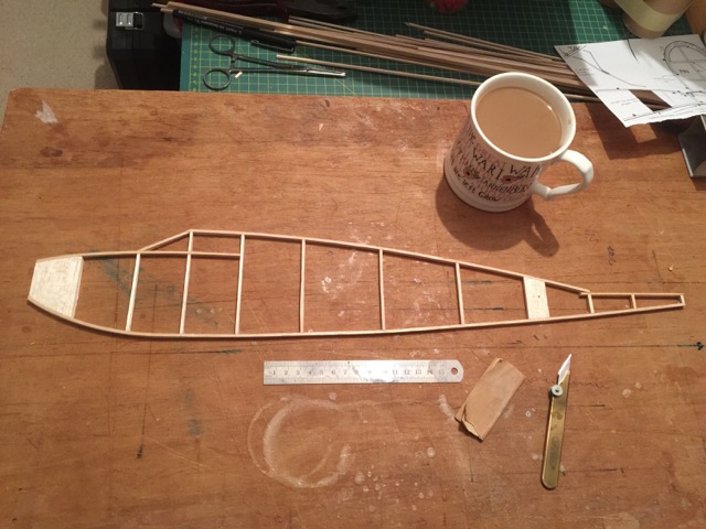

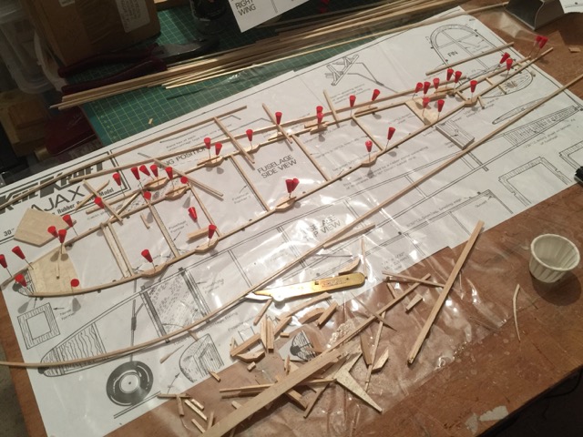

Progress on the Ajax is slow, but I have one side done:
the second laid down on top of the first:
..and the two removed from the board and the edge tidied:
