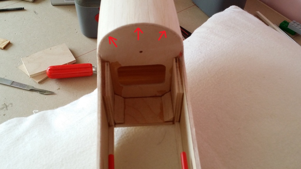

03 Aug 2014 00:33 #14 by Phil Wood
Replied by Phil Wood on topic Grumpy Tigercat
I think that's a brilliant job, especially if you've never tried it before. :cheer:
Look at the thickness of the planking where the arrows are pointing, it's even all the way around, you don't get much better than that!
Pol
