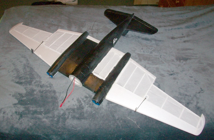

Unfortunately silver tissue would not be the full answer as the tissue only covers the open panels. The rest of the Depron would still have to be painted. I am not sure using silver tissue 'all over' to avoid paint would actually end up lighter.
The original used real lightweight Modelspan tissue whereas the stuff I am using is actually slightly lighter but it is not truly water proof so although it water shrinks well enough the Eze dope makes it go very 'saggy' which does not fully disappear as it dries.
I will certainly try applying it with a sponge although I suspect the ultimate answer is to invest in some model spray kit.
In truth I am not too bothered if the B57D comes out a few grams over the limit as I still want to see the effect of the extra wing area.
In the original build I was not trying to reach a 'target' so it was given a particularly 'solid' colour finish (two coats) and a polyurethane gloss top coat as well so the bits of the original structure are relatively heavy.
I am sure if I started again from scratch a B57D of this size could be below 250 g.
- Posts: 10058
04 Mar 2020 21:26 #140
Replied by Quorneng on topic English Electric Canberra - in Depron of course
I need not have worried the Eze dope has pulled all the tissue tight.
The all up weight is now calculated at 148.5 g.
Unless I can find a way to spray the silver I expect it will end up at 152 g.

Looking good Q, but don't you mean 252 g not 152 g ?
- Posts: 10058
05 Mar 2020 08:40 #142
Affirmative!
To be exactly legal I will finish fitting the ailerons and fly it unpainted at 248.5 g.

Virtually flat calm this morning after the mist lifted and it flies.
Sorry no video the battery in the camera is dead.
Very gentle and as expected really slow for an EDF and no trim change required from the previous Canberra setting either which means I must have built the new wing straight or at least 'aerodynamically equal'.
Flying slow is not ideal for an EDF as their efficiency, particularly tiny ones, falls away below a certain optimum air speed so overall its potential max duration is likely a bit lower bearing in mind it was not that good to start with as a Canberra.
Never mind it is below 250g and flies. Its glide performance is 'interesting' and landing is easy with a dramatic ground effect. Unlike the full size I have the advantage I can switch power truly off. I believe on the full size when in ground effect it could maintain level flight even at idle thrust. You had to use the air brakes to actually 'land'.
Even taxiing worked the brakes rather hard.
