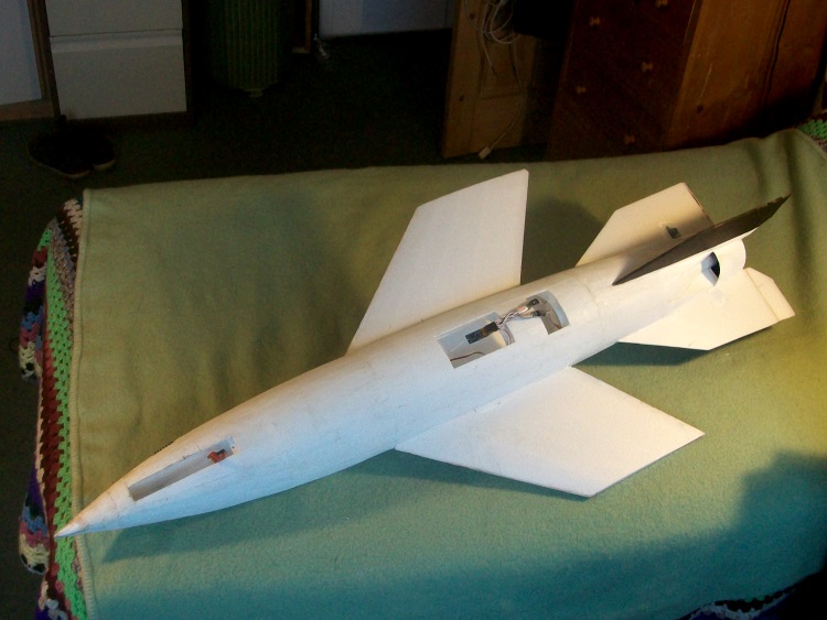

Calm enough this morning to give it another flight. Field still very soft and muddy. The wind was from the SW so the driest part of the field was in the lee of a high cluster of trees which made things rather turbulent low down so its is poor video!.
Hard to see but it rolls nicely!
Flew without the stability on for the first time. It tends to lift the nose very readily and adding more down trim started to eat into its longitudinal stability.:ohmy: A touch more nose weight should improve things.
On the landing approach I noticed a dog (there was absolutely nobody on the field when I started!) making a bee line towards it so I had to adjust the actual touch down to full cross wind in order to land close by. Mud but no damage.
Roll on warmer weather. It is not exactly 'fun' doing development flying in these sort of conditions! :(

Calm yesterday so with a touch of nose weight (1/2 oz) tried for some low level shots for the camera
It was all going so well.........
Not really sure what happened. It definitely rolled to the left, removing the left wing. It was actually upside down when it stopped!
The electrics are fine, the EDF was still running.
This a 1/5th slomo of the actual crash.
I am not sure it helps any. You can hear the fan touching the casing on the impact. :P
Repairs well under way.

23 Jan 2016 20:53 - 24 Jan 2016 00:02 #100 by Quorneng
Replied by Quorneng on topic Aggregate A9 (A4b)
Now that did not go too well!
This morning I made at least two classic mistakes.
1. After the first flight which ended successfully - just - I did not pack up and go home to consider what was wrong but had another go! ;)
2. Despite a breeze and rather marginal control I made a concious decision to "try to get it back" rather than "get down before it gets too far away"! Of course it went beyond the range of the 'park fly' radio and it does glide surprisingly well! :woohoo:
It ended up about 1/4 mile away in the middle of the golf course but fortunately it stands out rather well on a fairway! :woohoo:
So what was wrong?
Coupling the upper rudder with the aileron control was a mistake. It has the effect of inducing aileron adverse yaw which when coupled with the EDF torque meant it would not really turn to the right. Of course no problem to the left. I had hoped the adverse yaw would tend to counter its tendency to drop its nose in a turn but I probably would have done better to have simply used the rudder - as a rudder! :P
I also suspect some of its problems result from setting its true symmetrical section wing and tail at 0/0. This makes them behave as a single surface, like a delta, but without the delta's inherent stability. :ohmy: I fear it was only the 3 axis gyro that was giving the 'illusion' of longitudinal stability! :woohoo:
So this is the plan.
Build a brand new nose section!
Buy another gyro Rx.
Add a degree or two of wing incidence.
Add scale 'over hanging' extensions to the elevons.
Use the rudder as just a rudder!
Last edit: 24 Jan 2016 00:02 by .
Thanks: Klipkopwildlife, THE BLACKBIRD, Ex-Member, Ralpharr2001
23 Jan 2016 22:53 #101 by Quorneng
First step - remove the broken nose.
It has been taken back to the original construction joint.
Usually for me I actually put bullet connectors on the motor wires which made the whole process a lot easier. ;)
