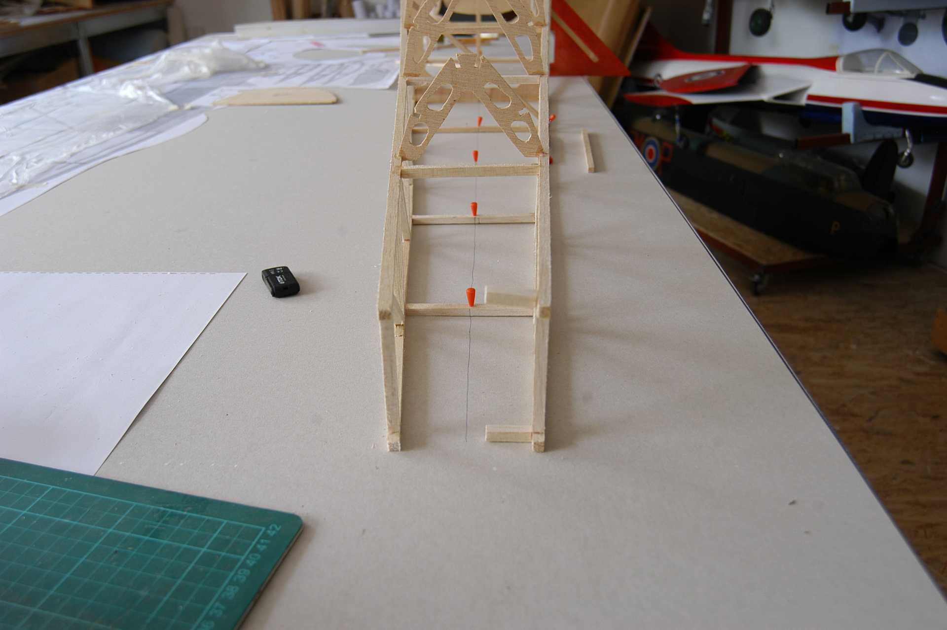

Found some 6mm hard balsa sheet and stripped it into 6mm square for the fuse sides, built the sides over the plan
Then assembled the fuselage free hand as there is no plan view on the plans, in fact im finding a lot of things missing from the plans :( just have to make it up as I go

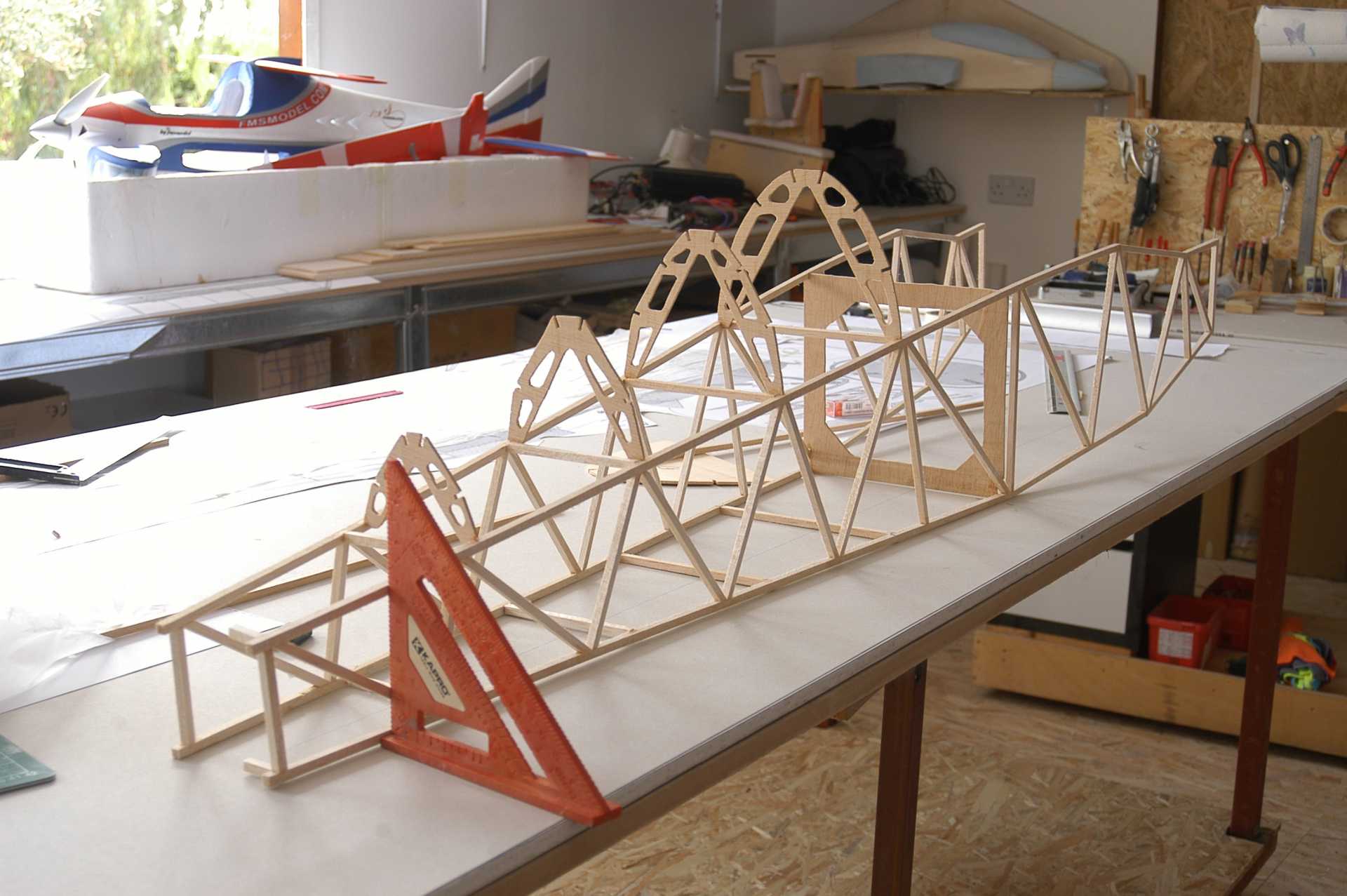

24 Apr 2016 19:24 #4 by THE BLACKBIRD
Got the basic fuselage structure done, just got think of a way to tie it to the fire wall, think I might get some S steel tube and create a structure within the wood frame work, I will then tie the fire wall, lower wing centre section and the struts for the top wing and the undercarriage all together :ohmy: i think

25 Apr 2016 05:01 #5 by one tenor
Replied by one tenor on topic A new scratch built Bucker Jungmeister 1/3 scale
Is that just one rib ?Seems enormously thick .
25 Apr 2016 09:26 #6 by Klipkopwildlife
I think there's lots of ribs clamped between the outers, certainly that's the way I do it.
25 Apr 2016 10:06 #7 by THE BLACKBIRD
:lol: :lol: :lol:

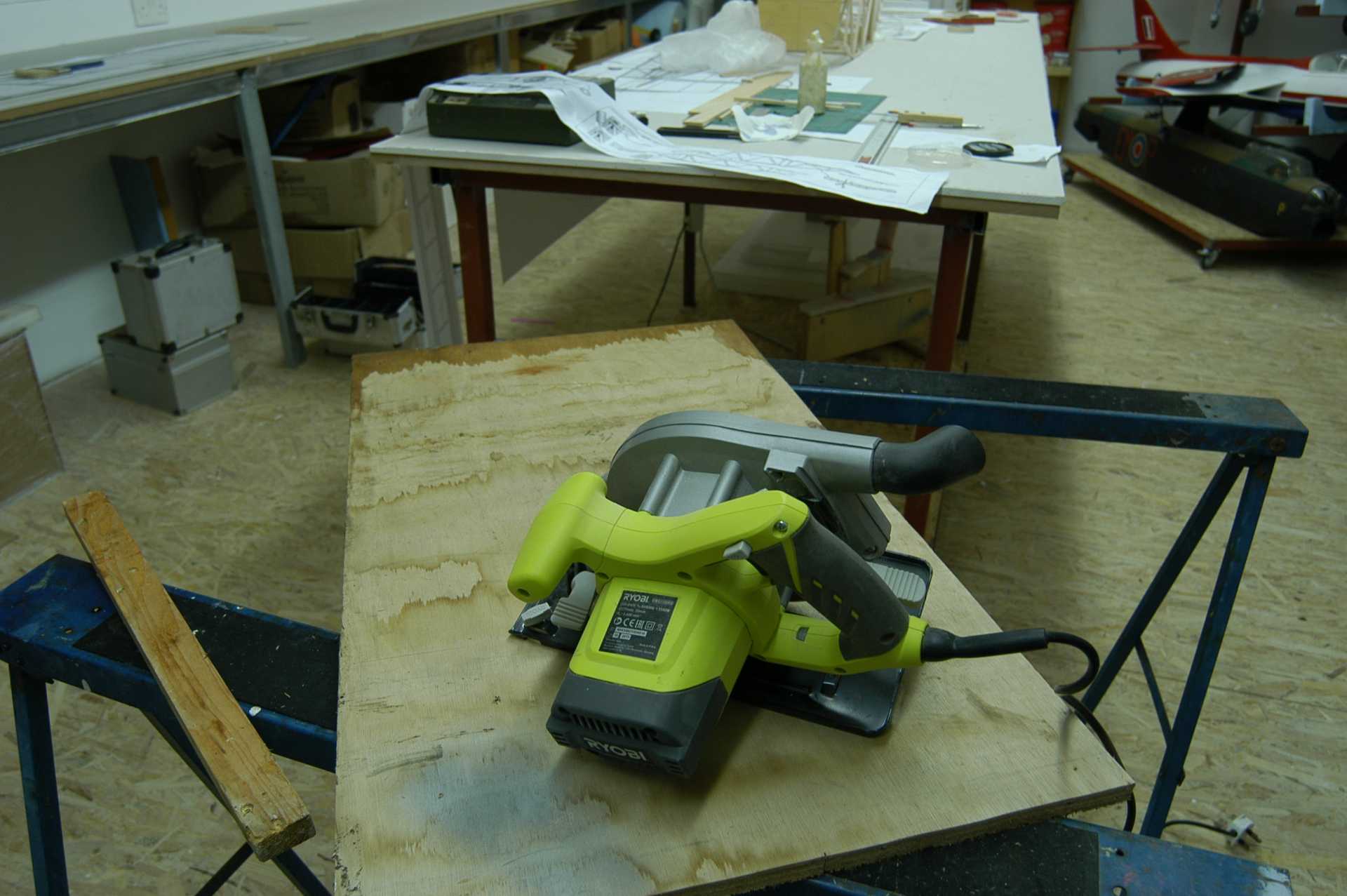

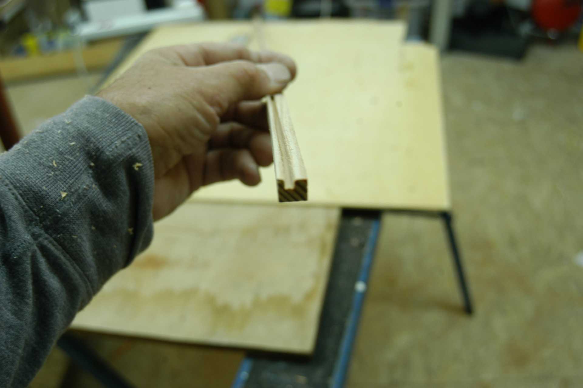

30 Apr 2016 13:13 #8 by THE BLACKBIRD
Had to cut some 6mm x 8mm spruce spars from some bigger material, so I made a saw bench to do it
Also had to rebate them to take 3mm ply
Surprising the amount of sawdust from that small job

30 Apr 2016 14:35 #9 by Quorneng
Just an observation but whilst spruce spars with a 3 mm ply web is traditional it does seem a bit at odds to the 1/4" sq balsa used in the construction of the fuselage.

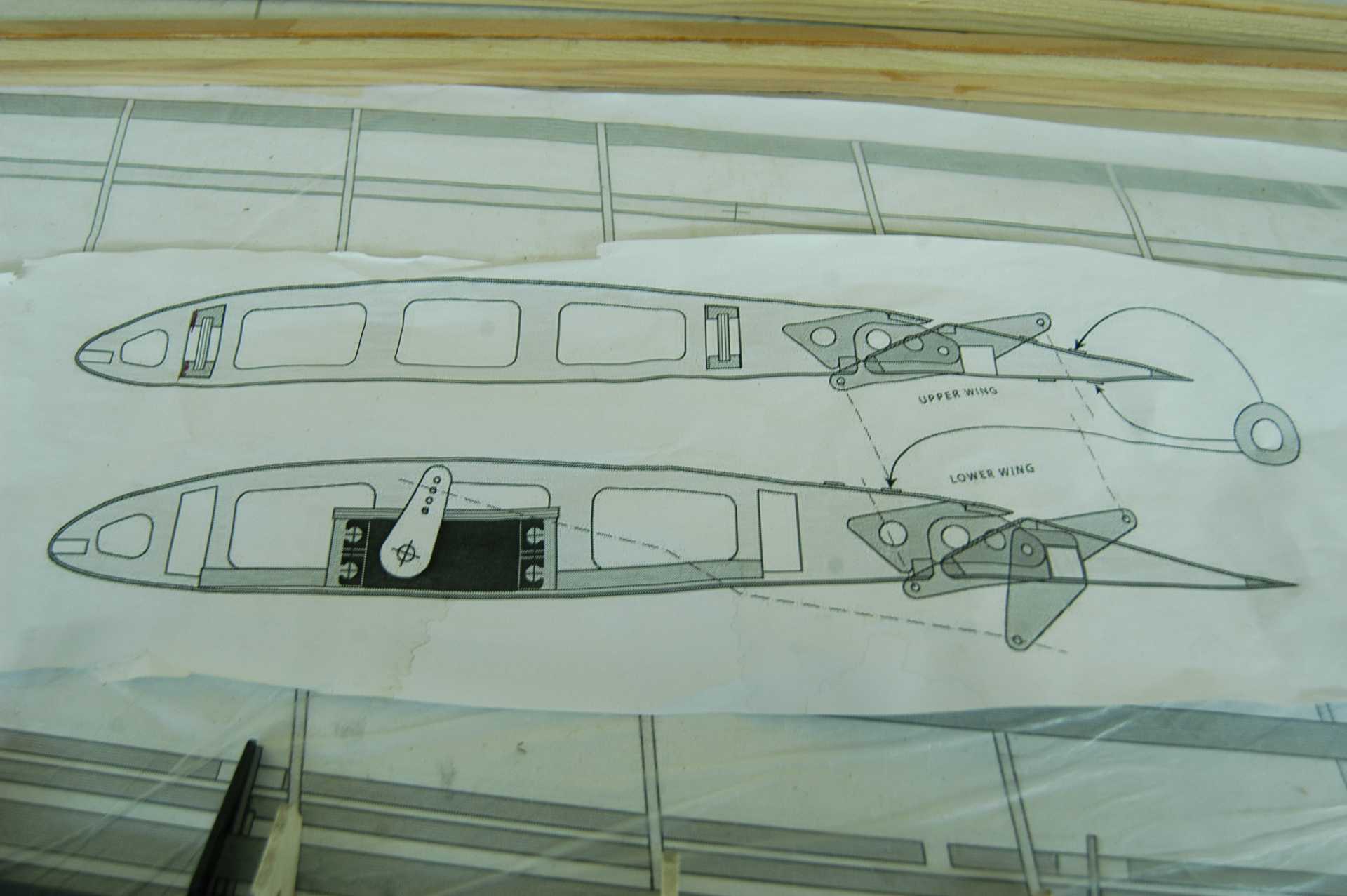

A complex arraignment for the hinges and horns of the ailerons

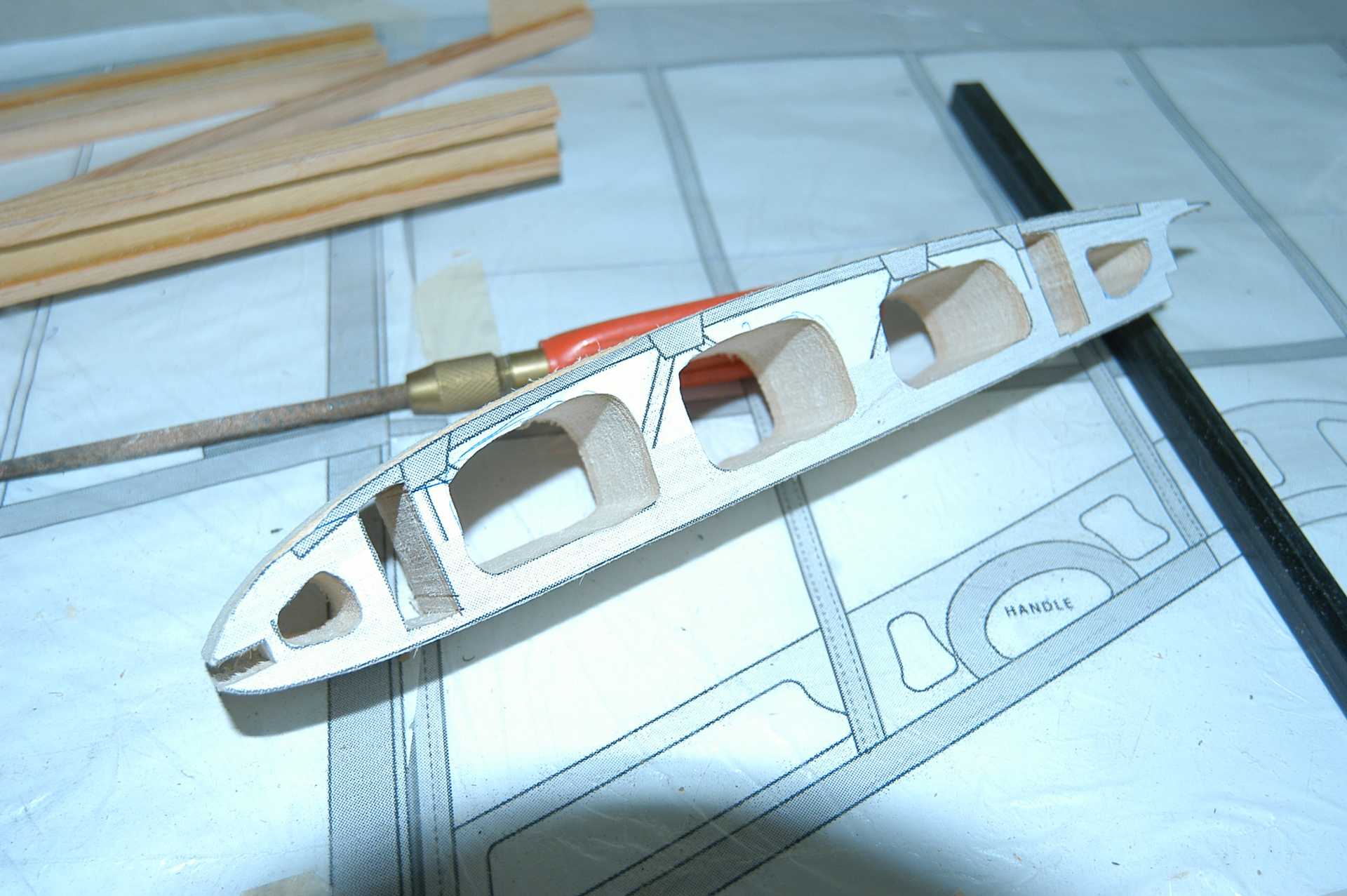

Some ribs and carbon parts cut
And a dry assembly
Thanks: Phil Wood, Klipkopwildlife, Quorneng

01 May 2016 22:39 #13 by Quorneng
A classic "Frise" aileron. Provides a degree of "aerodynamic" differential and reduces the control loads as well..
02 May 2016 14:32 #14 by THE BLACKBIRD
As per the real one Simon, he builds his planes as near to the original as possible

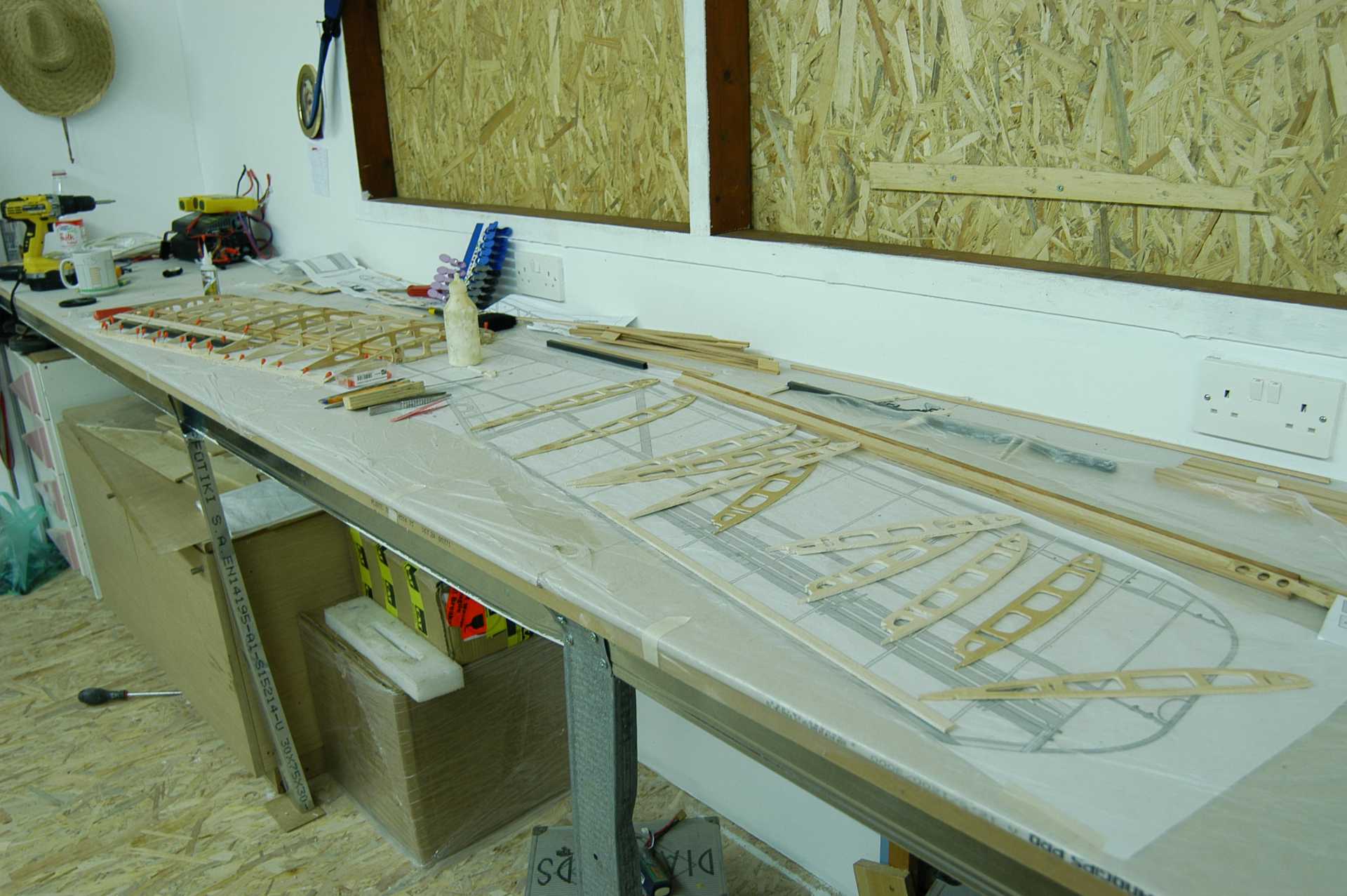

02 May 2016 16:44 #15 by THE BLACKBIRD
Got a lot of the first wing panel built
Nice to be able to lay the whole wing plan on the bench
In fact I can get all 4 panels on there with room for more
