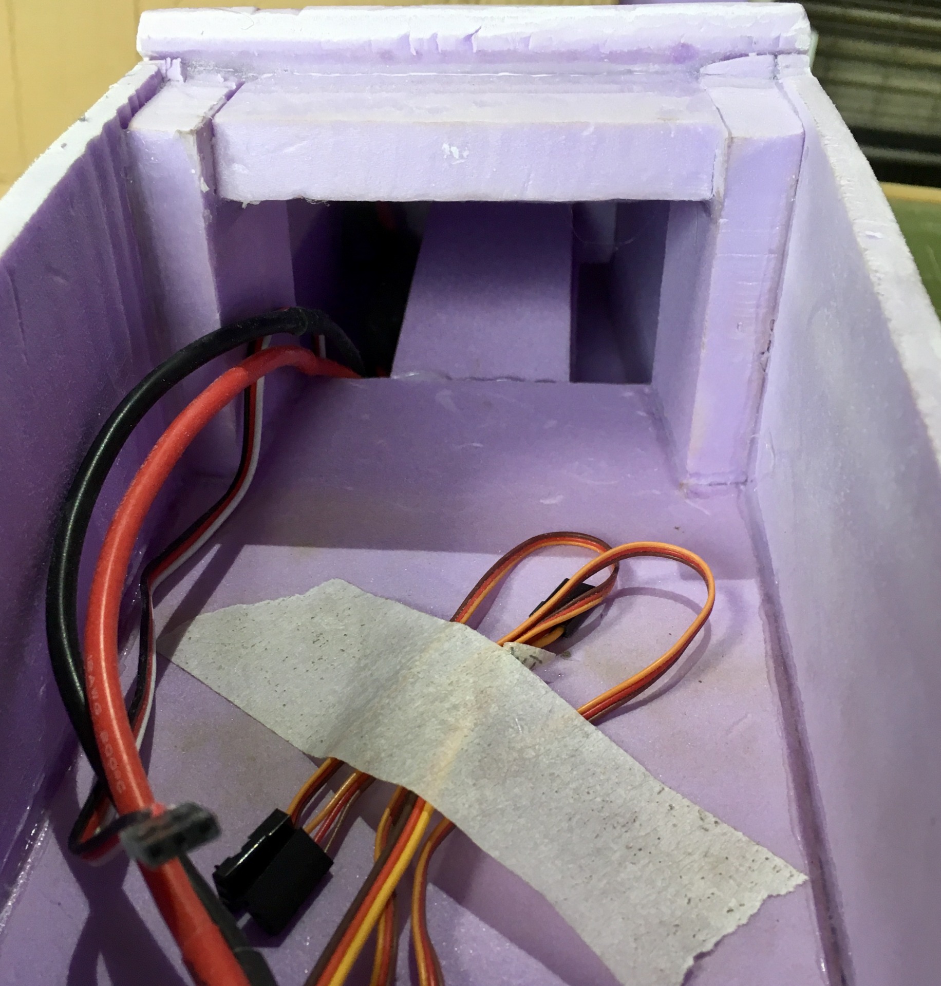

Got some more done today. Tail is finished & painted. Carbon fiber rods to hold the elastic bands are in & most the fuz sanded down. I also had a mess about with some chrome effect paint. Works okay on brown paper, primed with two coats of watered down wood glue & lightly sanded, but I'm not over impressed. Lastly the battery box seen from inside. The ESC is fixed to one side up front. Air flow from a gap under the firewall & up both sides of the box.
