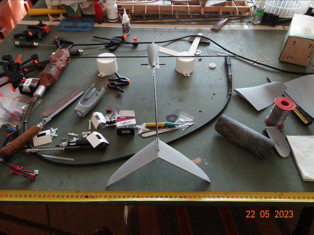

12 Jun 2023 10:52 #5 by Klipkopwildlife
Replied by Klipkopwildlife on topic Rise Nano
To continue
Setting the tail on the boom.
Then I decided to spray the upper surface of the wings.
Hmm that didn't go well, the wings were printed at the same settings, they weigh exactly the same, yet this happens. I had decided not to spray the underside, now I might, just to see what happens.

13 Jun 2023 19:30 #10 by jon.in.swansea
Replied by jon.in.swansea on topic Rise Nano
What kind of spray?  I looked around and found references to using strong hold hair spray.  I found Boots sold this, especially as it had no scent.  I tried it out on a couple of test-wing LW-PLA with one and two coats.  No warping. Seems to deflect muck a bit.  Minimal weight gain.  Perhaps 3 coats would be better.
14 Jun 2023 08:22 #11 by Klipkopwildlife
Automotive spray laquer Jon, exactly the same stuff I used on the Seagull.
Anyway, all 6 parts now printed, 20 hours, I managed to find gaps in the load shedding schedule.
Thanks: jon.in.swansea
14 Jun 2023 08:59 #12 by jon.in.swansea
Any idea why that automotive spray reacted like it did on that occasion when it was not a problem with the seagull?
14 Jun 2023 10:05 #13 by Quorneng
Replied by Quorneng on topic Rise Nano
KlippyYou were lucky with the automotive spray. Most eat PLA like it was hungry. However if the conditions are hot and dry enough you can spray with light coats and rely on the propellant to evaporate before the paint drops reach the surface. The  only paint I found that did not readily eat PLA was "Wheel trim silver" but then silver only needs light coats.
15 Jun 2023 12:12 #14 by Klipkopwildlife
Jon, the only difference is the filament, the scrap wings are 3dlabprint, the Seagull wings are eSun. I must confess I did go for a one coat cover, and I didn't have the spars in.

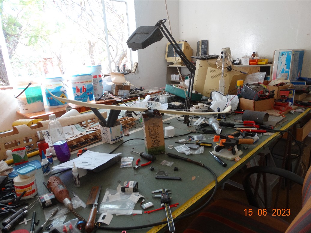

15 Jun 2023 12:13 #15 by Klipkopwildlife
New wings fitted.
Sorry about the mess.
