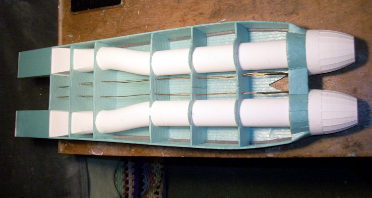

Spent the period over the New Year building the fuselage box and ducts for the 50% bigger XF108.
The left hand EDF and nozzle are installed.
Note the "magnet" wires lead through the formers all the way forward where they will ultimately be soldered directly to a Little Bee 20A OPTO ESC. They are small light and produce very little heat but it does mean a small separate  BEC will be required to power the receiver and the two servos (elevons no rudder).
The right hand EDF will be the same but I am not sure I have enough wire!
Just for fun a rear view of the nozzle and 12 blade EDF.

Not much to show for several hours work but the green B&Q 3mm foam is dreadful to work with.
Both EDFs in and tested. The slow bit is neatly fairing in the two circular exhaust nozzles from what starts as a oblong!
The top surface of the fuselage is quite involved too!
To make matter worse not all the drawings show exactly the same!

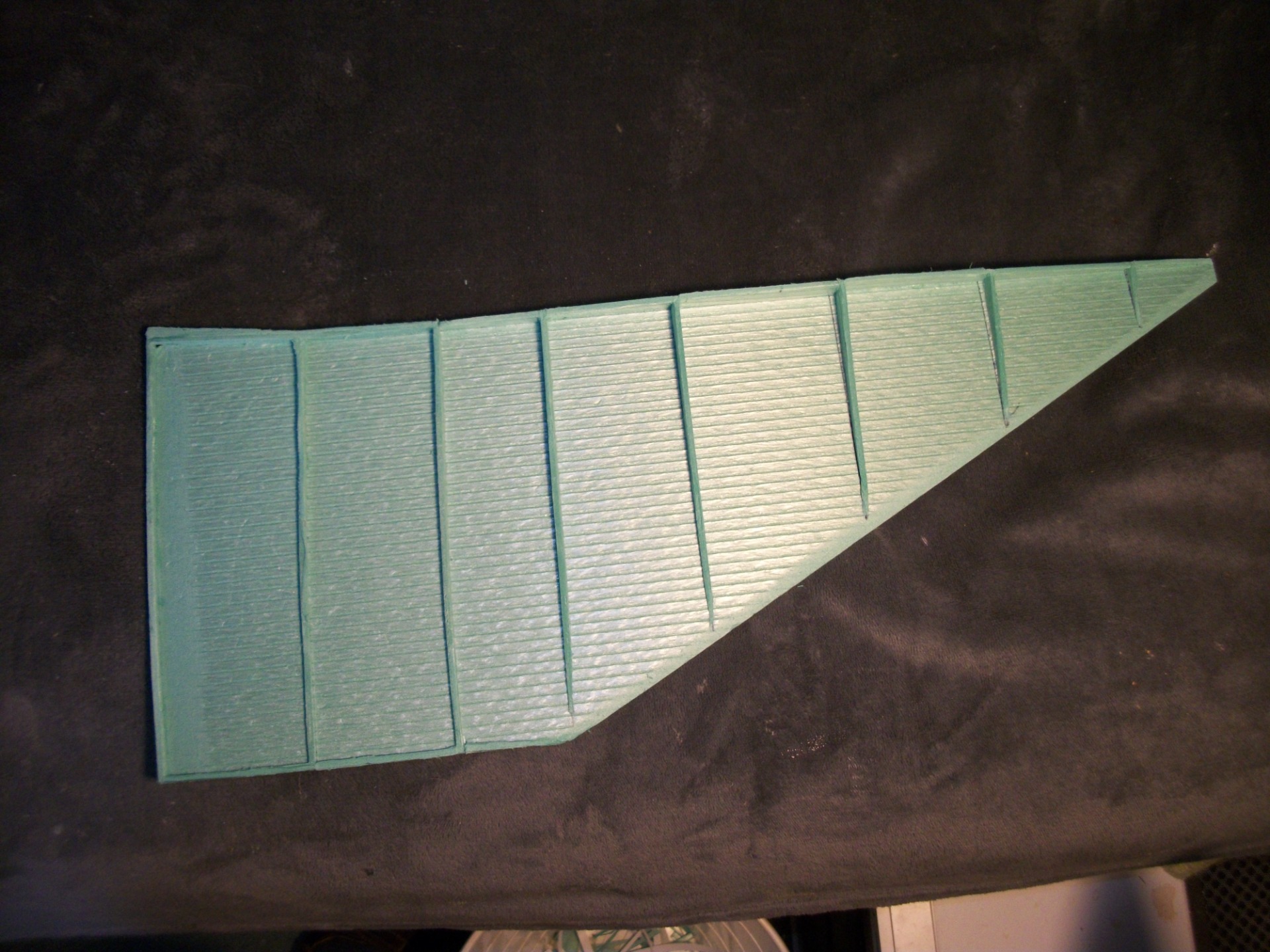

In my usual all sheet foam style. The LH lower wing skin.
It is surprisingly small although it does have quite a substantial area wing tip.
I really cant tell at this stage how stiff it will be. May require so carbon 'tow' glued to the top and bottom surfaces.

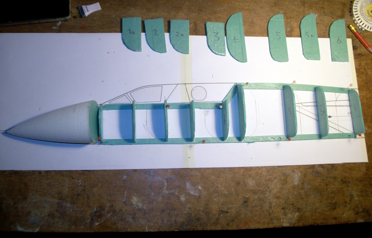

As the rest is structurally more or less complete I have a start on the nose section.
To be made as a planked  "half shell over the plan".it will have quite lot of specially shaped planks!
Part of the problem is with the EDFs right at the rear I have no idea where the 1400mAh 4s LiPo will have to go, hopefully somewhere under the canopy
We shall have to see!
