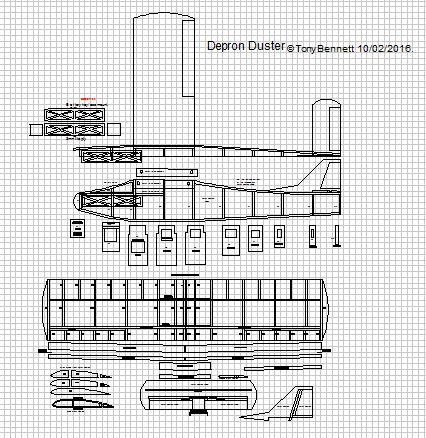

been thinking about a basic little model for Depron.
nothing fancy, just an ideal little starter plane that is cheap to build and crash. :P

i think the basic design is done ;)
need to sort the u/c and then i can print it out and start cutting and gluing.
then amend the plan and add building details. :)
if i build it that is. :P :P :P

well as it was sooooooo quiet on live chat tonight, i finished the plan off.
got a few notes to make about construction and add when i get round to building it that is.
Back to Daisy plan now i suppose. :P

well after getting a second opinion on the plan i now have 22 amendments to make. :blink: :blink:
oh well i will work through them one at a time and at the end of it all i will have a plan fit to sell. :cheer: :cheer: :cheer:
all i need to do now is to build the model and fly it. :P :P
we plod on. :)

well i have done some amendments to the plan today, will do some more later tonight.
but i have also printed off the fuselage section of the plan and is busy cutting out fuselage sides and formers from 6mm Depron now.
need some lite ply, must see what i can find in the scrap box tomorrow.

Well i found some scraps of Depron and managed to cut out some fuselage parts.
then over the course of the day i managed to stick a few of them together.
at the moment the two fuselage halves are gluing together and hopefully tomorrow i can sheet the underside of the fuselage and start work on the tailplane.
so far all the drawn up parts have fitted without any modifications needed. so that's worked out well :)

well the fuselage has been built as far as i can at the moment.
i need some snakes and servos and motor and esc before i can finish it.
tailplane and fin are well underway now.
cant do the wings until i get some more 3mm Depron as i only have scraps left now.
so all will be on hold until i get paid this month. :(
