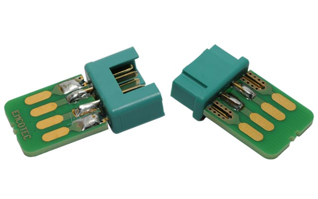

Soldering servo wires to individual pins on those MPX connectors is fiddly and I think they are highly likely to fracture with repeated pulling and pushing. Soldering one wire between 2 pins is the next best thing but I use these PCB boards. They give a very strong platform for the wires to solder to. Alternatively Ashlocs from Fighter Aces are really easy to use. No soldering required, just crimping and they go up to 4 servo connectors. (www.fighteraces.co.uk/product/ashlock-12-way/)

I've seen those but I still prefer the ashklok connectors. The set up on mine was using individual pins so two servos per connector. I think they make a great power plug, but I'm not convinced about using them for servos.
