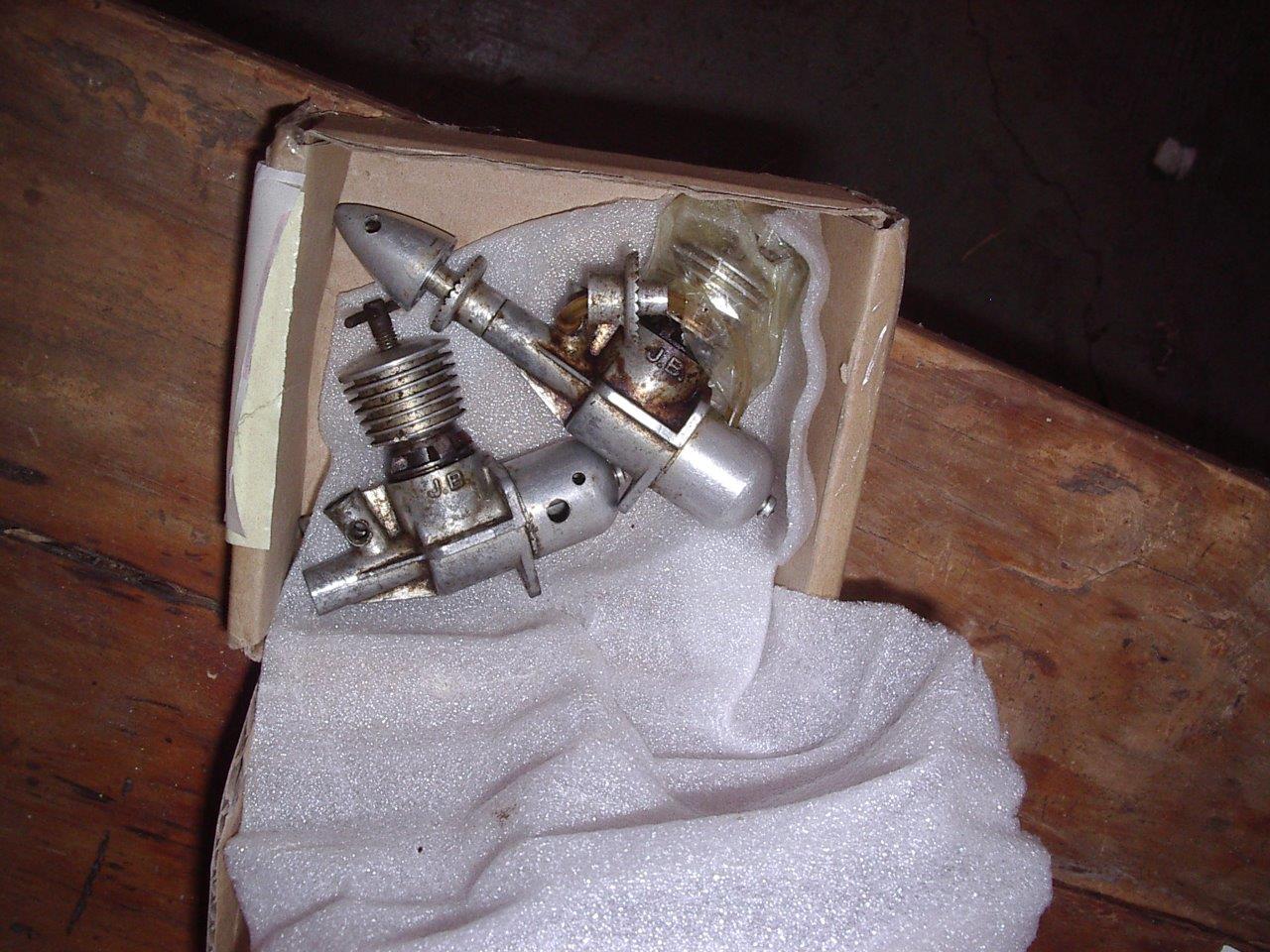

30 Sep 2017 08:59 #2 by Klipkopwildlife
Replied by Klipkopwildlife on topic JB Atoms
Right, now I've found the pics I can start over! (of all the things I've lost I miss my mind the most!)
Received two very dirty engines in a box.
The complete one is in the bath.
