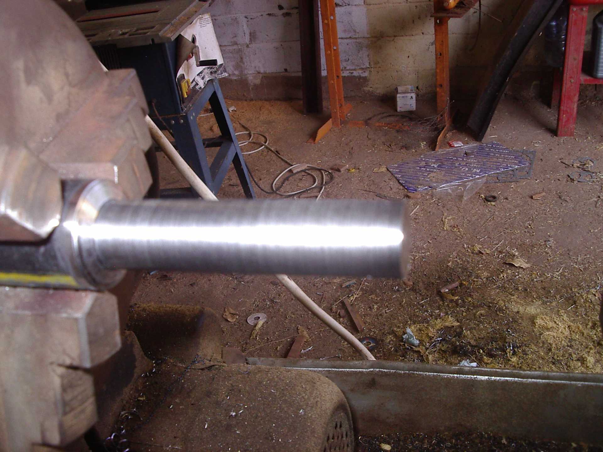

Second objective is to go down to close to shaft size. But first compare with the finished article.
Then down to shaft size, plus a bit.
I've left about .2mm (8thou), I hope this will be enough for lapping.
Thanks: Quorneng, one tenor, boz, Squirrelnet

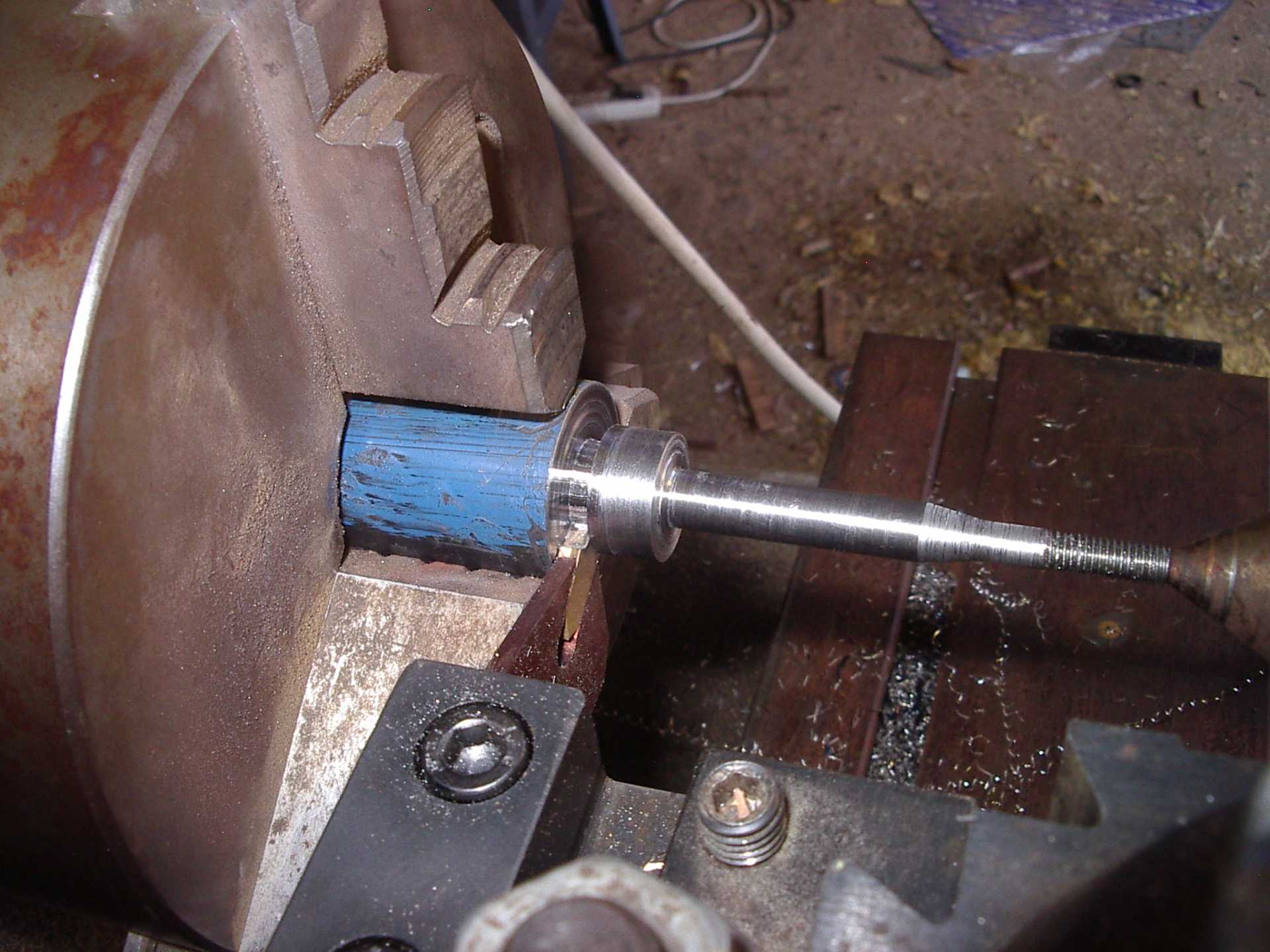

At this point I'm worried about the shaft pushing away from the cutter and becoming taper so I've decided to centre the end so I can use a running centre.
I will then thread the end 2BA while I still have the advantage of the thicker shaft.
I always make a drawing for posterity, my Engineering master at school would have had a fit! But at least I know what it looks like!

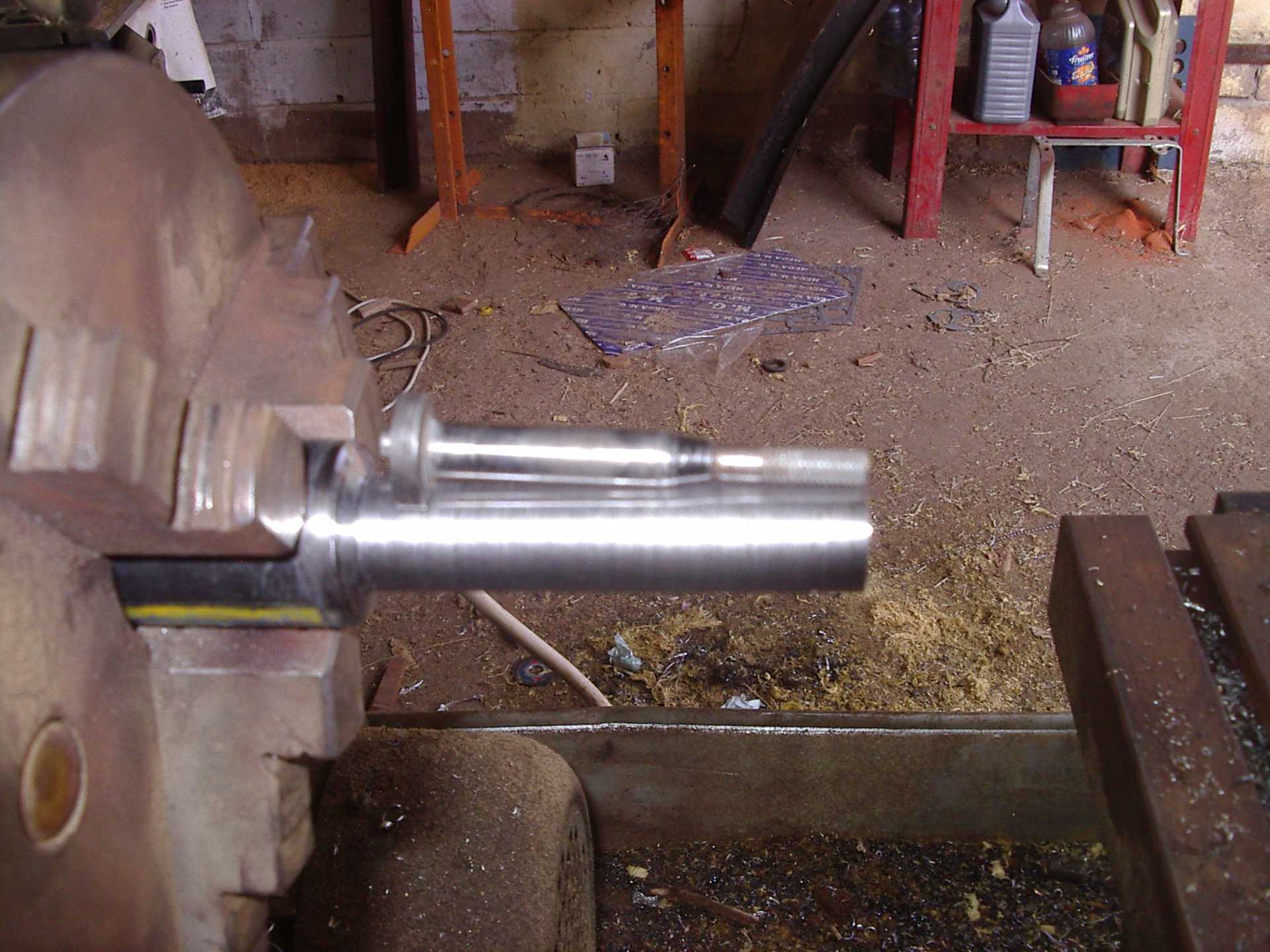

Of course as you get older it can take a while for the penny to drop! The reason there is a stud in the nose as a prop driver is because the shaft is so hard! The shaft is like glass so the separate stud is used because in any accident the crankshaft would break!
The manufacturers intended to have all surfaces glass hard to reduce friction and enhance life, personally I don't think they've gone the right way about it, and certainly the reviewer in the article was not overly impressed. He battled to get one engine to run consistently and the other took a long time to approach consistency and higher revs. It got so hot he had to pour raw fuel over the crankcase to cool it down!
A brief word about terminology, hard is not necessarily strong, tough is not necessarily hard. Hard and tough together is good, today we can surface harden a tough material using a coil driven at high frequency. When we pass a shaft through the coil the surface heats up and we then quench immediately using a ring of fluid jets. This gives us the best of both worlds, a glass hard outer with a tough inner as support. We can even control the degree and depth of hardness by adjusting frequency, current, speed of pass, and type of fluid used for quenching.
If we want to get really fancy we now have steels that must be heated in an oven containing an inert (specific) gas and held within 5o of a specific temperature for a specific length of time Using todays methods we could make model engines that will literally last for ever, running on a breath of oil, or no oil in the case of a petrol engine. The only problem would be, we couldn't afford them!

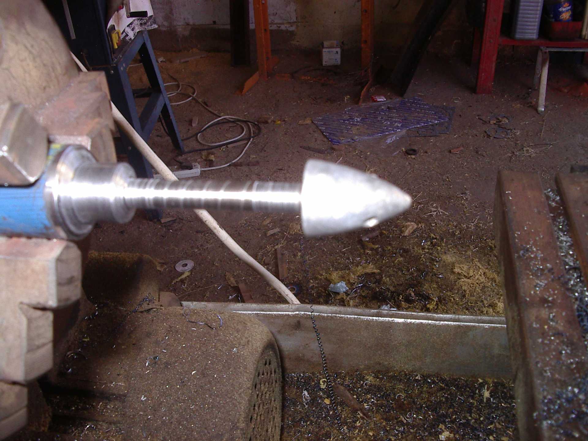

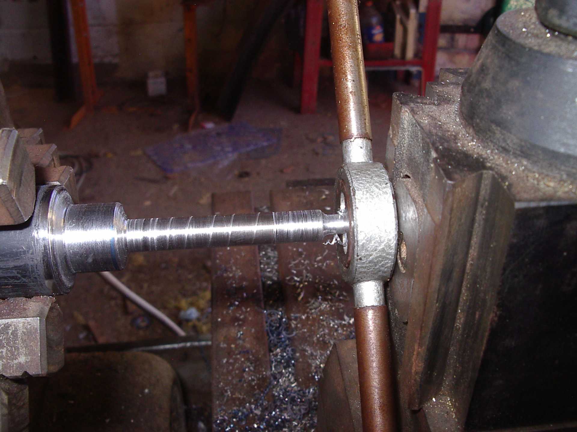

To continue, threading after first checking the thread is correct.
finish lapped with the driver taper machined.
and ready to part off, not a job I enjoy, it needs a really rigid machine because the tip is so wide at 3mm
