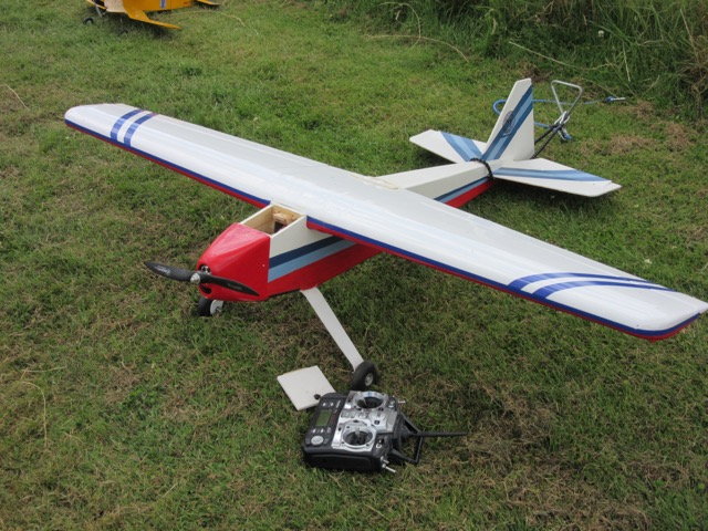

Well, I took on Tony's Nemesis a couple of months ago and today, had my first flying session with it.
Two flights showed up that the ailerons and elevators were far too sensitive and the rudder not sensitive enough. Changing the LiPo was a bit of a faff as I had to remove the wing each time (longer leads will sort that one!) and the wheels were a bit small for our grass strip. The LiPo was also a bit warm after flight, and as I hadn't thrashed the model at all, it'll need some cooling holes before I fly again. However, on the other hand, the colour scheme was perfect, with good conspicuity of the model throughout both flights. The stall was pretty benign too, although she tended to drop the left wing during accelerated stalls but recovery was immediate on releasing the sticks.
Tony's right about the landing handling - she does tend to float, but there's no hint of a stall even at quite high angles of attack. With appropriate adjustments, I'll have the perfect flying machine to get me back up to speed with RC!
