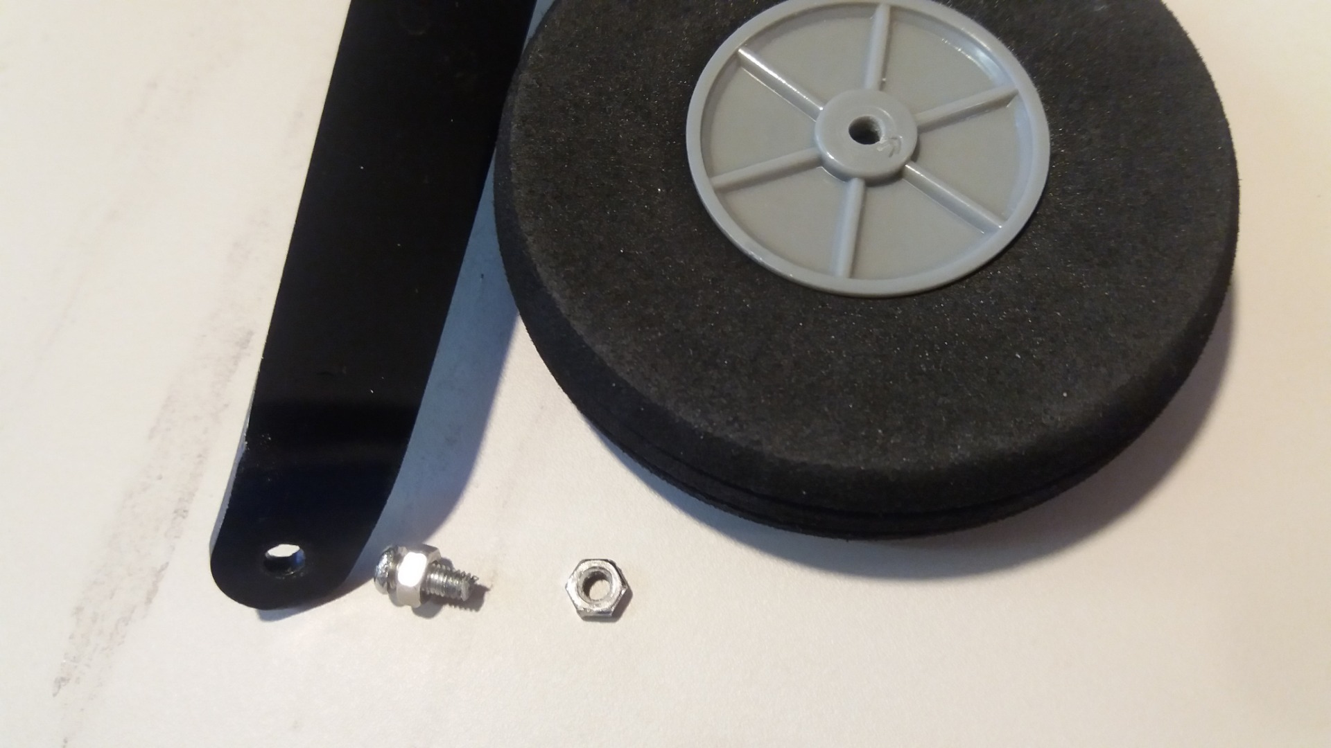

I did a beautiful smooth landing on short grass but when I tried to taxi back to me the model just wanted to go in circles. I walked over to it an found one wheel was bent. I straightened it by hand, which was far too easy to do, and took off again.
The next landing was even better, and on the smooth road .... guess what, ... A bent bloody axle again!!
I took it back to the car and had a good look, the axles are a couple of very soft M3 bolts!!!
... I don't even think they are a decent hard steel, they look like aluminium .... and bend like it as well..... 2 more slight attempts to straighten it by hand and it just snapped off.
Here's a picture, I could drill the wheel hubs out and fit wider bolts, M4 would be easy, M5 are even possible. I'll have a look in my junk first and see if I've got some proper axles.

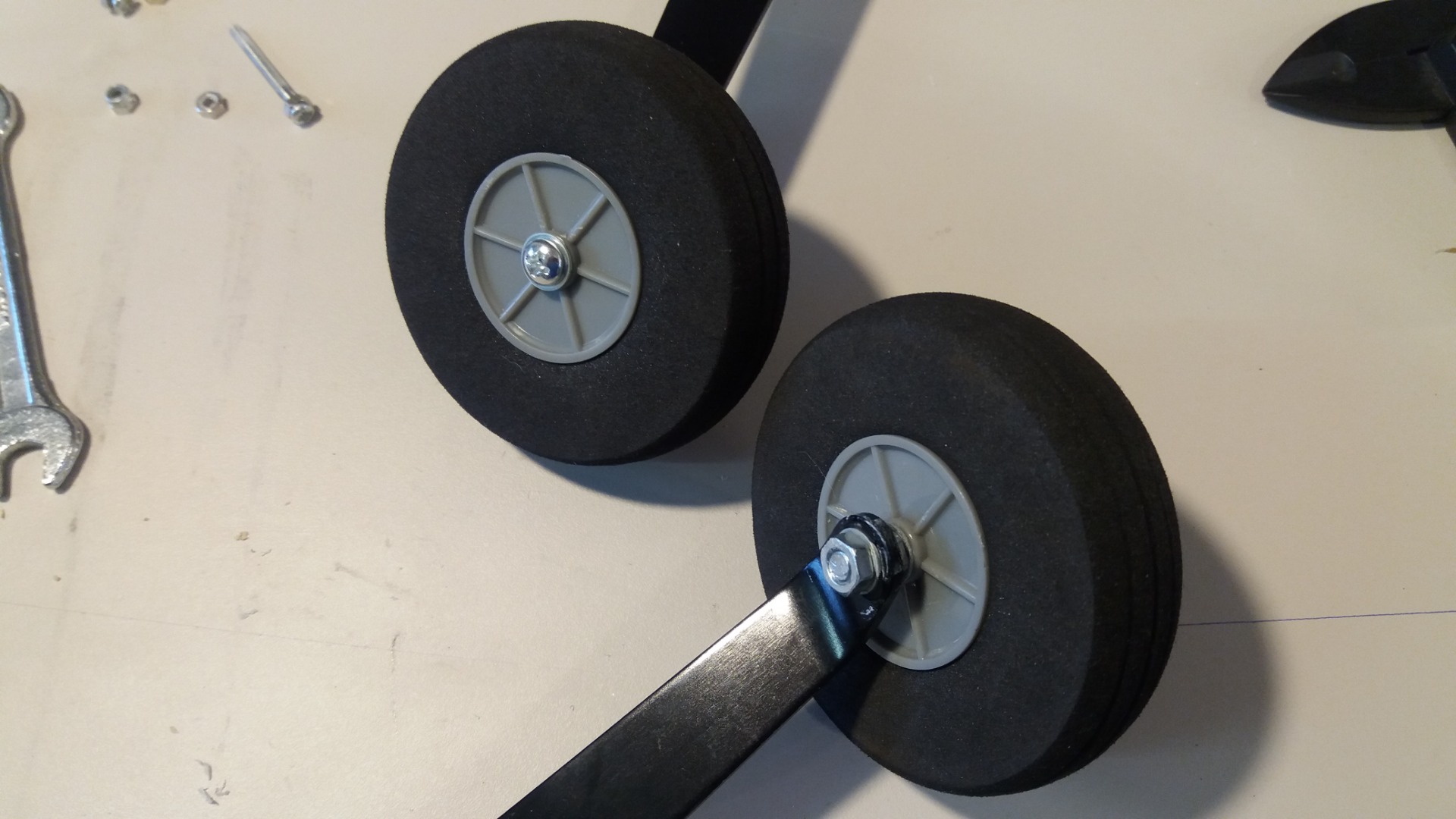

That's one job sorted. Drilled out the wheel hubs and fitted some M5 nuts, bolts & washers, added a bit of thread lock for good measure and it's ready to screw back on to the fuselage.

Do those plastic? hubs run on a threaded part of the 5 mm bolt? If so the hubs will wear rather fast.

Replied by Phil Wood on topic Kit Review, Max Thrust Ruckus (Another Poly Project)
Yes they do and I did think about that. I considered using a piece of brass tube as a bearing but then I realized that these are very flimsy foam tyres and they'll wear to shreds long before the wheel hub will.Quorneng wrote: Pol

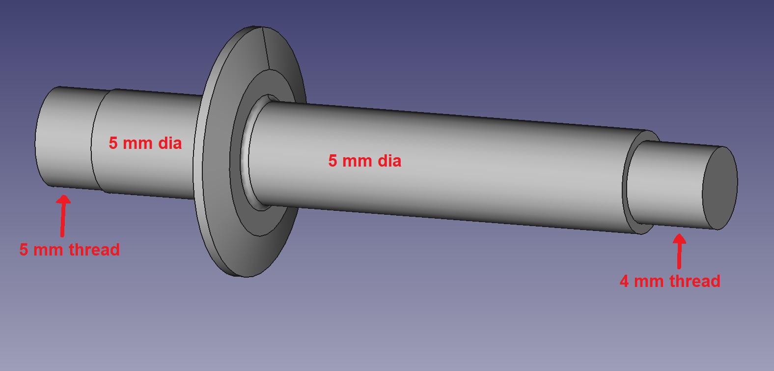

29 Jul 2019 11:42 #22
Replied by Quorneng on topic Kit Review, Max Thrust Ruckus (Another Poly Project)
Pol
Yes it would have to be made specifically to suite the dimensions required for the Ruckus.
The reason the threaded portions not going any further than is absolutely necessary is to avoid the 'stress raiser' that any thread creates when under a bending load.
The small radius between the axle and the flange (its on both sides) is there for the same reason.
Really more an exercise in technical drawing than a serious suggestion although it would not be too difficult to make on a lathe along with with suitable dies to cut the threads.
I suppose its just my reaction to a 'high tech' carbon fibre? undercarriage leg being used with 'all threaded" axle!
