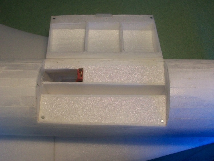

07 Apr 2014 19:28 #143 by Quorneng
Replied by Quorneng on topic An EDF Concorde - in Depron.
The battery hatch just about completes the structural work.
The four tiny magnets hold it closed.
I might give the whole airframe a very light coat of white acrylic spray to give a more uniform colour but any more decoration than that will have to wait and will depend on how (or if!) it flies.

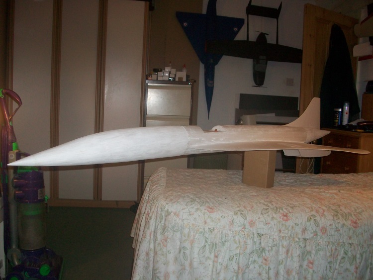

08 Apr 2014 19:44 #145 by Quorneng
Clever?
Not really - more likely daft!
Here it is with a light coat of white spray on the fuselage and just a 'dusting' on the wings.
You have to be careful with Acrylic spray as the solvent slowly attacks Depron so you have to give it very light coats. It is essential that the Depron surface never get enough paint at any one time to leave a 'wet' surface.
I am not really happy with the knock off nose arrangement. I fear that if it gets dislodged (very likely) it will damage the surrounding structure. To make it rigid enough to withstand the likely sort of landing impact would require quite a bit of additional internal structure. If I can actually get it in my car in one piece I will simply glue the nose on permanently as it would be the lightest and strongest solution.
